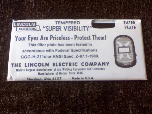

How about this one?

ANSI Z87.1 is an impact resistance standard for safety eye wear and face shields. It has nothing to do with the autodarkening aspects of the helmet or protection from arc flash. I'm not aware of the standard for welding arc protection.
ANSI still comes into play because there are several manufacturers that use lexan or another resin type material. Sellstrom sells a lens from Sweden that is water proof but may melt in the sun. The other can crack just by squeezing it. As far a regulatory agency that tests AD filters, I am looking for one too.
