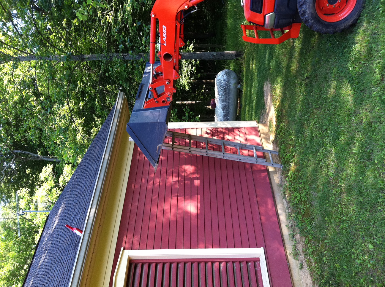

Good idea. I did something similar but with just a plain skidsteer bucket for cleaning out single story gutters. 6 foot wide coverage plus about 2 feet per side you can safely reach. Throw the sludge in the bucket so you don't have to rake it up off the ground. Ladder access to bucket wasn't too inconvenient. Overall, safer than the old way (ladder, 4 feet at a time, on irregular ground.)

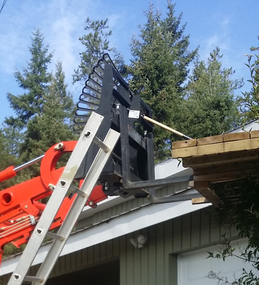

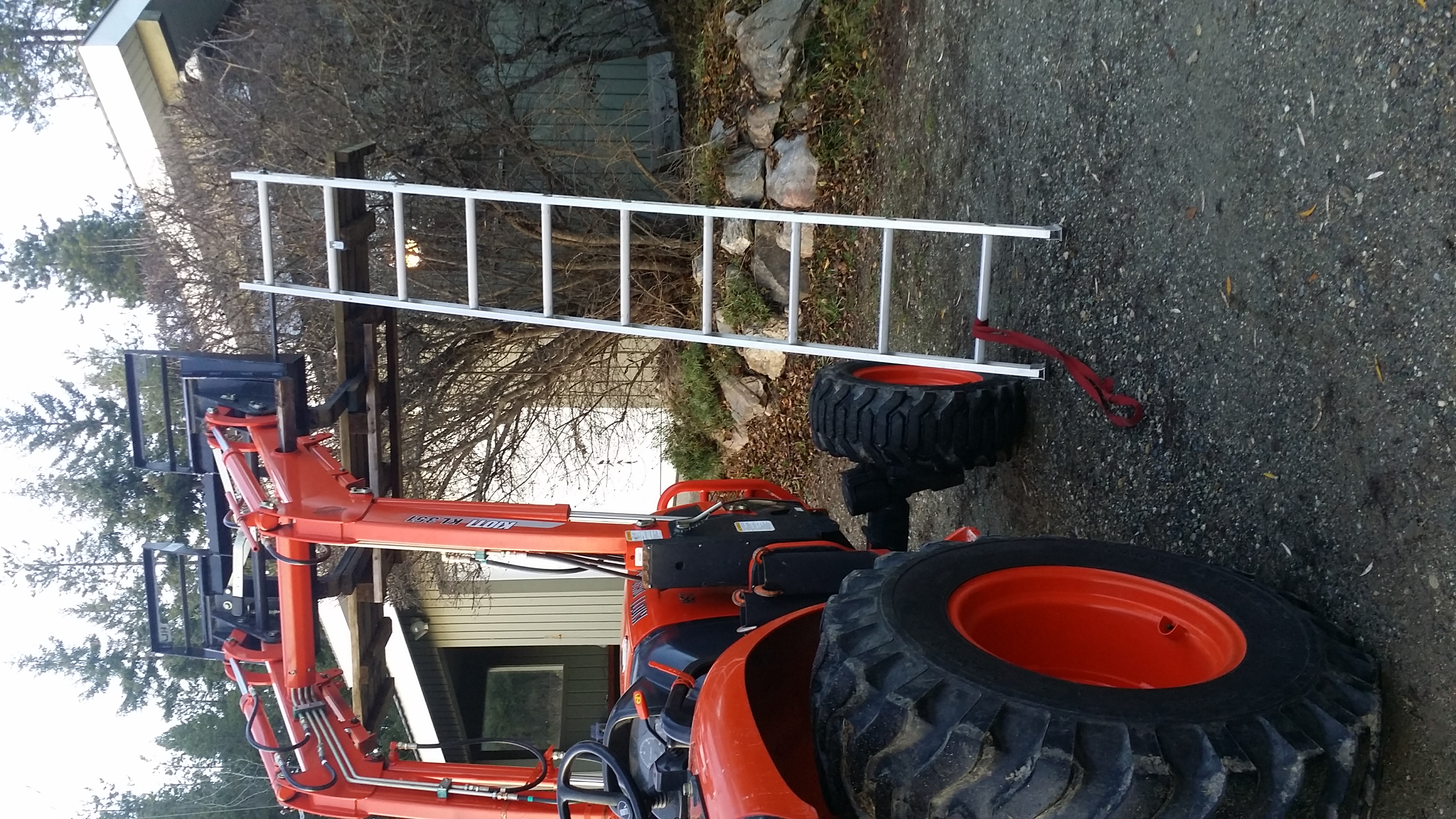

I use a salvaged portion of my sundeck for a crude platform. Although far from "safety-approved" it is safer than working from a ladder.
I use 1/2 of my extension ladder to access the platform. I drilled holes in the four pallet fork uprights to carry a round bar just shorter than the fork frame width so I can leave the bar in the frame all the time. The ladder is mounted by running the bar through the top hollow rung, and held in place with a lynch pin. When moving locations I shove the ladder tight against the pallet fork frame and hold it up with a sling.
Here are a couple of photos:
