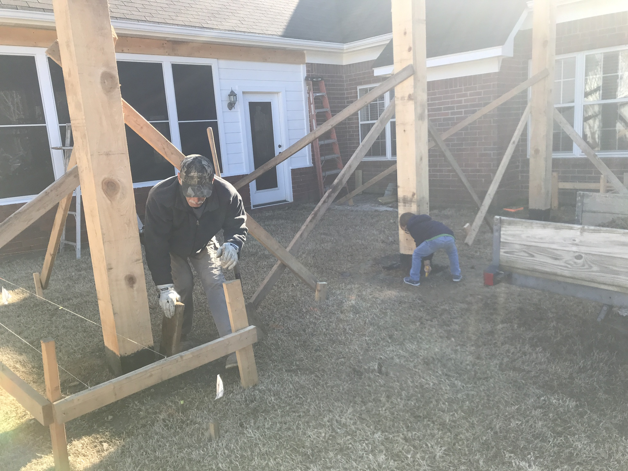

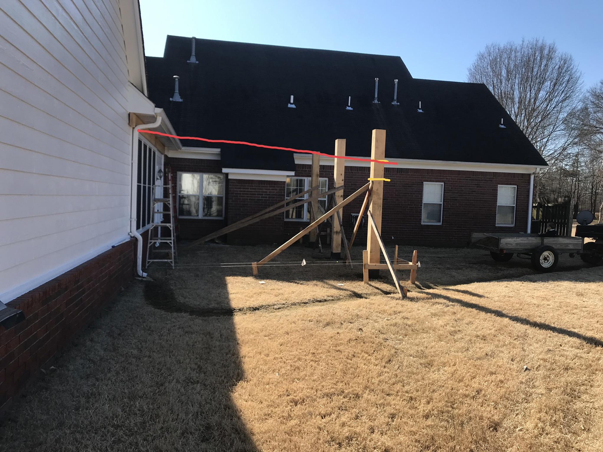

Update, post are in the ground and all I need now is some dry weather some I can get back there again with my tractor to sit the 4x12x22 beam on top of the post. I put a rubberized coating that is used on retaining walls and basements around the bottom to help protect them. The posts are in the ground 36 and sitting on about 6 of crushed rock. I then sat the post and put about 6 more inches of stone, packed it really good then added concrete.

Really nice looking posts!!!

Who's your little helper there in the first photo?

Those are some really nice looking posts! Cypress is supposed to be very rot resistant since it grows in water and damp areas to start with. That rubberized coating below and above ground level should further protect them for years to come.
Like many have reported the rot often happens right at ground level. Just North of me the power company has started wrapping the base of all the power poles with metal. This was on poles that had been previously set without extra protection so I guess they are just trying to prevent moisture from sitting right at the ground level.
