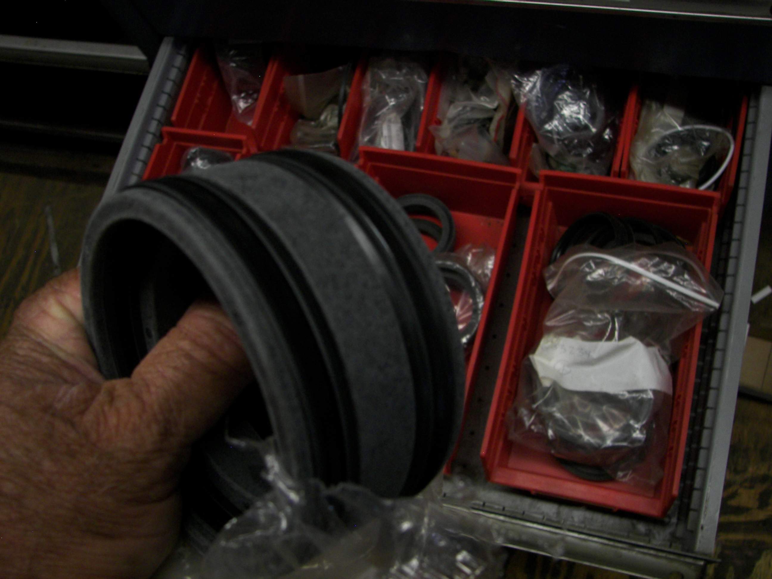

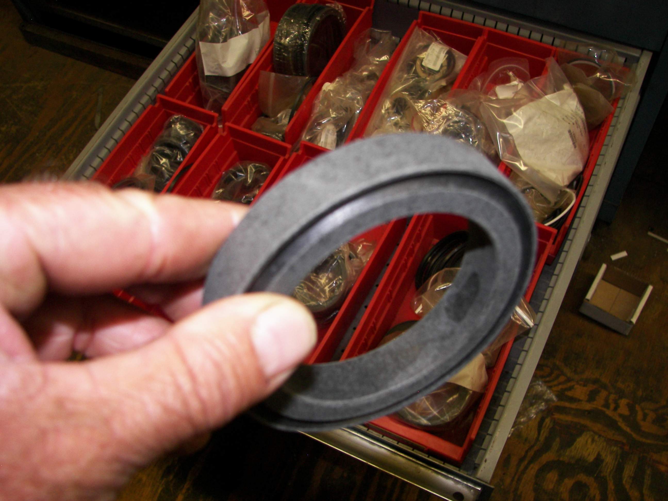

Scott,
the case piston consists of two sets of v packing with a plastic machined spacer.....what you are experiencing is the plastic spacer under usage gets swollen in the hyd oil over time
When you get a new seal kit it "should" come with the v pkg piston set with this new spacer as part of the kit......if they don't come with the kit you can turn them on a lathe and take off about .010 to .015" off the dia......second thought if someone tries to sell you a kit without that whole set (w/o the spacer), then they prolly have the wrong parts....those case piston sets are made specifically for case
use a comealong to remove rod assy, it will come easier than you think....if you resort to banging it out with a BFH (big friggin hammer) use a junk bar in the eye and don't hit the rod accidently
Do not use air pressure unless you have your insurance paid up in full (life and/or health)
