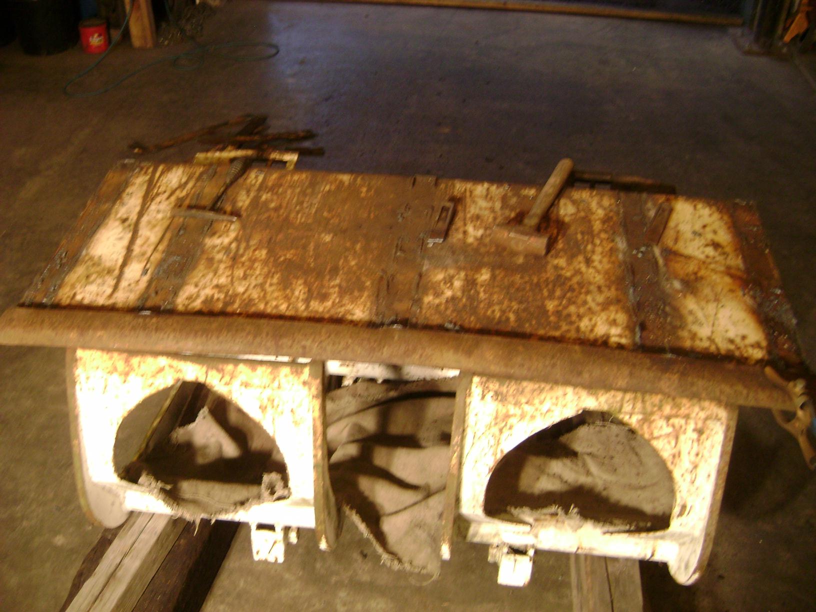

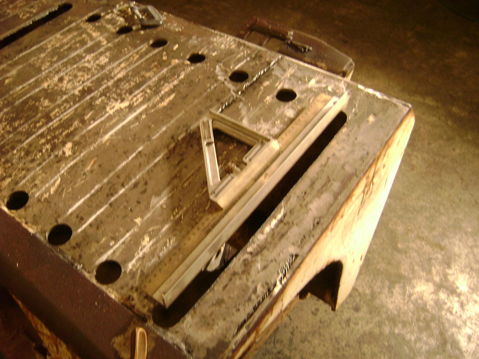

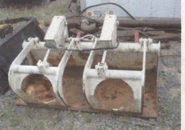

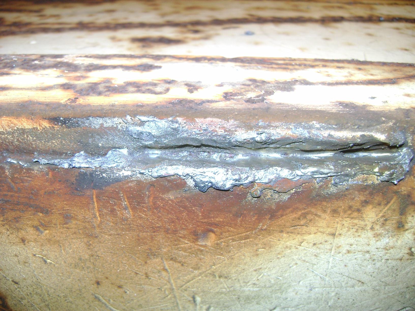

/ Cutting with a stick welder? #32
When I revamped a grapple to fit the FEL on my tractor, I used my plasma to scarf off the skid-steer mounts, wear strips, and to lighten it up. Plasma are truly cleaner to scarf with. :thumbsup:
