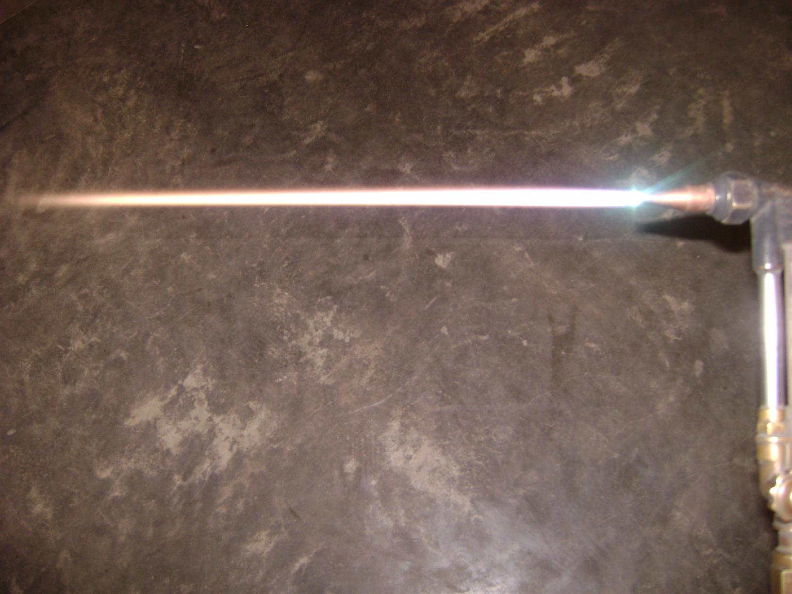

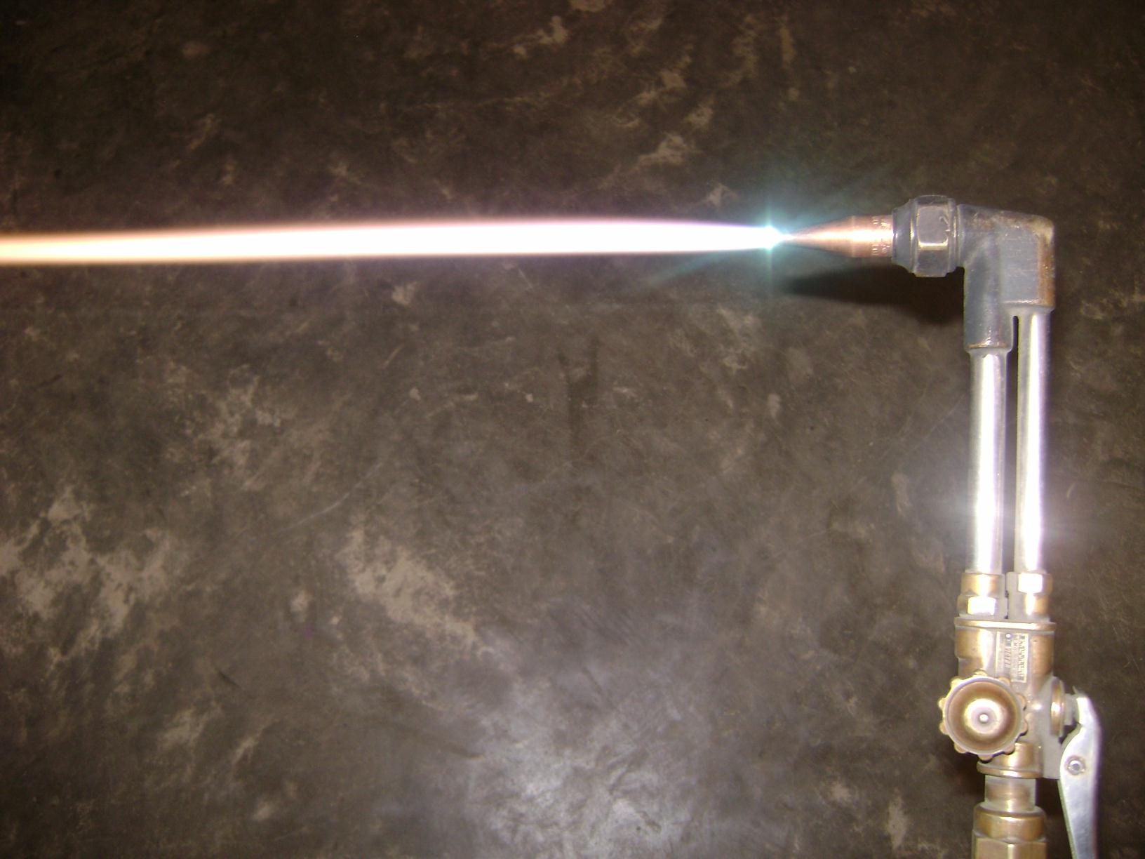

As with welding, and cutting I listen to what is happening. Every torch has a sweet spot, sometimes you only need to press the oxygen lever an 1/8-inch, sometimes a 1/4-inch, what you want is for the cutting cone to sound like a small jet engine.
First picture is what I like the cutting cone to look like. Second is a neutral flame.

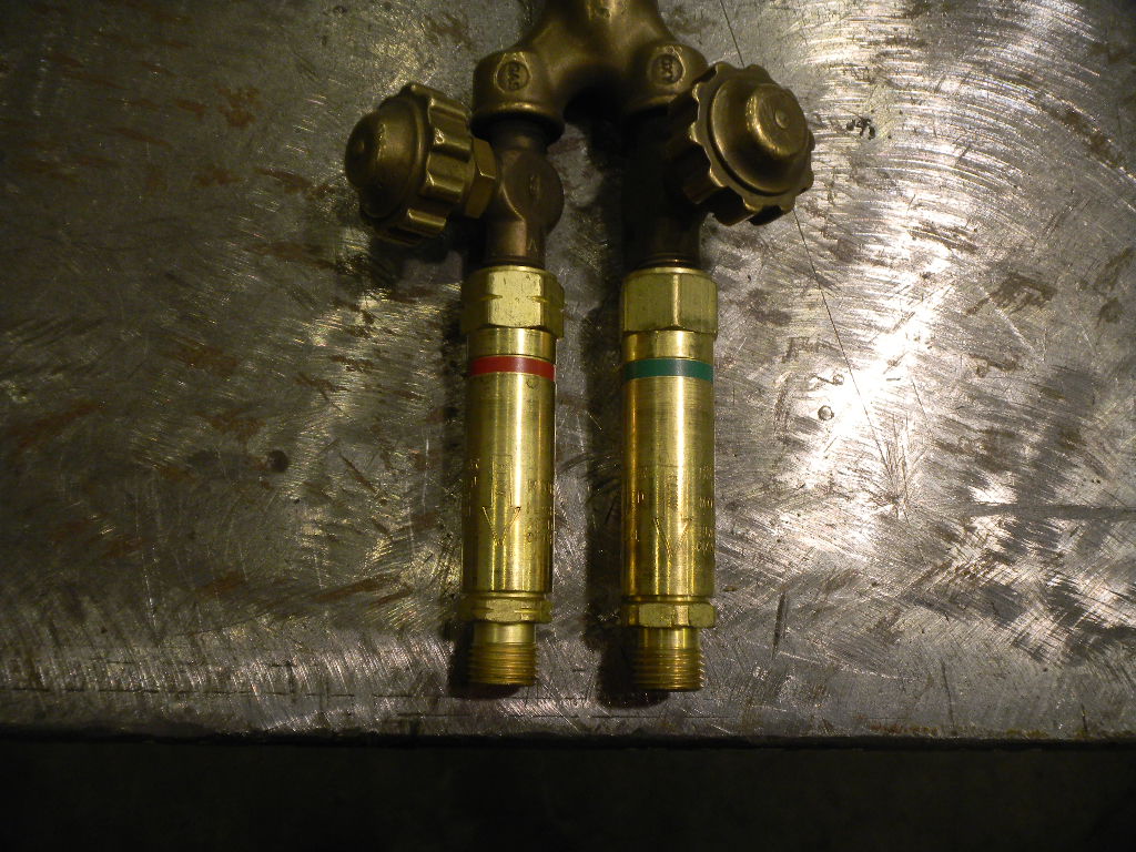

Nope. My current set of torches is a 50-60's era Harris that I got from CL. Local welding store had them rebuilt for 75 bucks, I added arrrestors, and they should last as long as I live!
Arrestors stop the O2 and acetylene from mixing in places other than at the tip. You DO NOT want them to mix in the torch or the lines!! It basically stops the gases from burning back into the torch or hoses.
