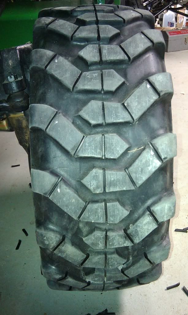

Here is my results. Grooved them myself.
I needed side traction in front, so i cut my fronts opposite as yours.
They even look hardcore now! :thumbsup:

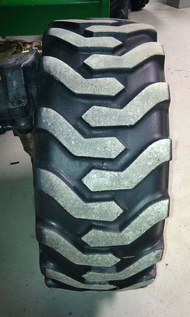

Let us know how those fronts work.
BTW, I used a #5 blade on my rear tires, so the groove was larger, and the fronts I used #3 Blade and made more cuts.
They look impressive, I only hope they grip as good as they look! :thumbsup:

I used a block of wood for a measuring stick! :thumbsup:
On the outside row of cuts I used it to make a mark of where to start, and then make 90 degree angles straight across the bars, so they stay uniform looking. The centers, I just cut the whole tire right down the center-line. The middle row of cuts, I just went from the corner of the lug to the other corner. It was so simple. I FIRST took a Silver Sharpie and mapped out a few scenarios of cuts, and after trying a few different ones, this pattern was the OBVIOUS way to make them look good and perform. The angled cuts will offer side and forward traction both! :thumbsup: I'm mostly after the stability sideways, as the R4 has NO side traction.
I'm hoping to play on it tomorrow a little to get the feel of how they perform!
Gladehound, thanks so much for the great idea! You deserve all the credit, I would have NEVER thought of this on my own! Thanks man! :thumbsup:

Never did this- hope the jpegs load.
attachment.php
attachment.php
The 850 was a golf course mower; blade is a Tractor Supply cheapo.
The Ford 4500 does a better job- and the backhoe gets me out of trouble!
