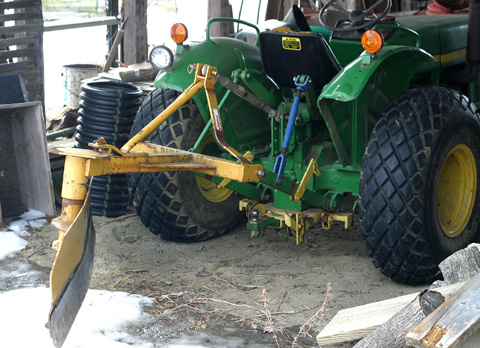

Here is what I did to mine. Cuts are about 1/8 x 1/8
I would love to hear from 3Bladz on how the gooving worked on the Ags since he's the one who has tried this.
In addition to having less meat to hold up to abuse, they also have less surface area on the lug to hold snow which could limit the potential of this method.
Is it a viable alternative to chains??? I think that depends on what you are doing and how your tractor is set up. I have been impressed by my ice traction. But no, it is not like a set of v-bar chains in ice. The question is... is it enough. I would think that with a heavy 3pt weight and well gooved tires, a 2wd with ags would do fine in snow. As I mentioned before, I've plowed in 2wd (thinking I was in 4wd) and not realize it until I tried to back up an icy hill (a worse case senario for 2wd). And keep in mind my tractor is front heavy, which is OK because it is 4wd. But if you have 2wd, the key is getting as much of the weight as possible on the rears, and this means a very heavy 3pt weight.
