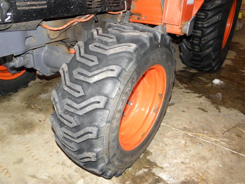

I'm planning on using the #5 on the rears and then take like a #3, or possibly #2 and groove the fronts the opposite way as the rears. The fronts are like "rudders" in snow, they only work to guide you as you go faster in deep powder. I usually don't even use the steering wheel in the snow, rather the rear brakes control my direction. The front R4's are pathetic when you actually try to "Work" them in snow.
Thanks for all the info.
Post some more pics if you do the fronts! :thumbsup:
   / Cutting / Groving / Siping R-4 for snow
#52

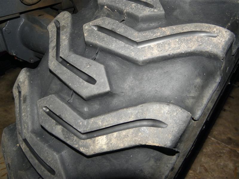

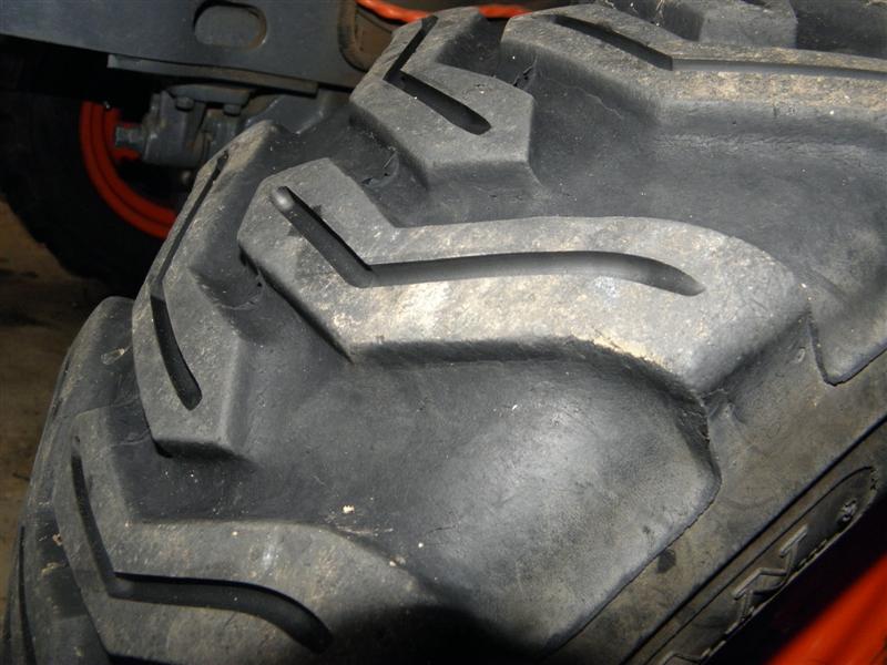

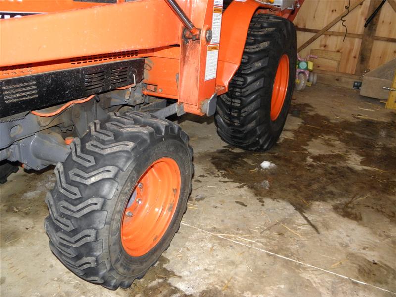

Just did the fronts! Wanted to keep the look similar to the rear for a matching set. Plus, since the bars turn at nearly a 45 degree angle my grooves go in 3 different directions. I'll try it like this first. If it's still sliding sideways I may cut the bars into 2 or 3 individual blocks. My objective is both better forward and sideways traction.
My fronts are much more worn than I realized. they have only 1/4" of tread in spots. So I set the groover to just under 1/4". There is one lug that actually already had a small chunk out of it. I have 420 hrs now and probably wont make it much past 500 hrs before I'll want new tires.
Here are some pics! They kind of remind me of a modern snow blower tire now. Hopefully they work like one! ;)

Plowed a drive today with about 16" of wet settled snow that had been driven over and packed down in spots. Would sometimes push 100 feet before stacking. My traction is good enough now that when pushing into a pile with snow under the tires, it's a crap shoot as to if I'll spin out or stall the engine. This is while using a gear that gives 3mph at rated engine speed. That's decent traction in snow! :thumbsup:
I still cannot break through that heavy deep snow with the blade angled because it pushes the front of the tractor too much. I need to push strait to break a path and then widen it with the blade angled. I have my blade hanging off my bucket which puts it too far out making it easier for the blade to push the front tires sideways. I'm thinking about a different mounting arangement.
