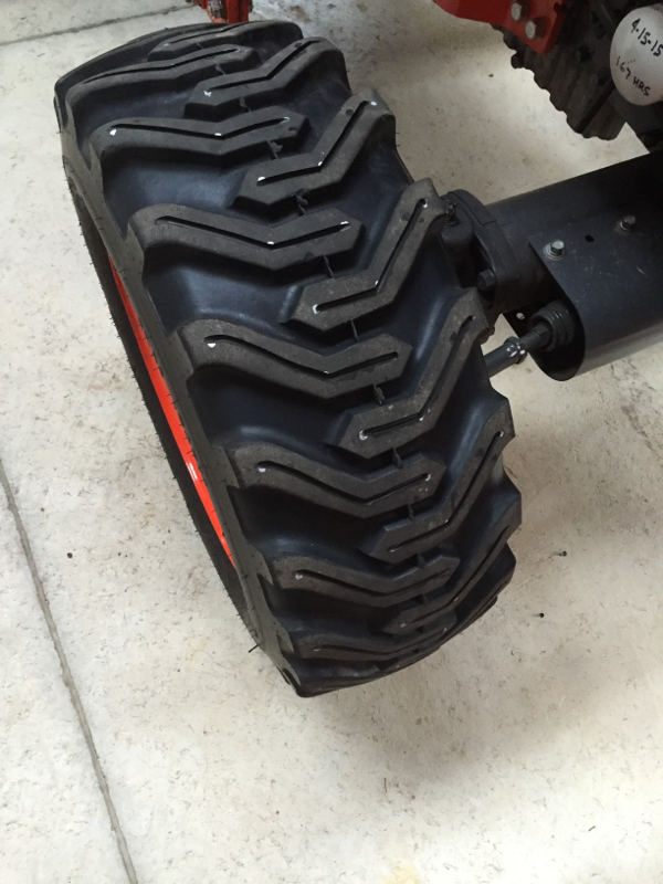

Ok, been following this thread since its start and have trying to get up the nerve to carve up my expensive tires. After this last storm with its 30" of snow I figured it was time to give it a try before resigning to the occasional chain usage (which I don't want to use on asphalt) I only did one front tire and it took longer than I anticipated but attributed it to the air temp (40) and it being my fist try at it. I put some dots on the tire for reference but did it mostly freehand. 3 more to go :)

Any follow up pictures?
Looks like your doing a great job, wondering how much difference it makes?

I completed the 2nd front tire Sunday, naturally it went much smoother due to a little exp & warmer temperatures. Prior to that I did get a chance to do a little FEL work with the one front left tire done. It was in the shadiest part of my drive way and very icy and I want to say it helped because the tires usually spin a good bit when changing directions. I didn't see that happening as much. It looks as though that may be the last time this winter I'll get to test them because it 60 today. That being said I like the theory & early results so far to probably do the back tires at some point. I will try and post a pic of the other tire when I get a chance. Hope this helps.

Here's a pic of the 2nd tire, took a 1/3 of time as the 1st.
Wow! Indeed nice job Boris... you said in an earlier post you used white dots and 'mostly' freehand. Did you sometimes use a straight edge? If so, did that speed things up? Seeing yours I am encouraged to try myself if I can get my hands on a tool.
