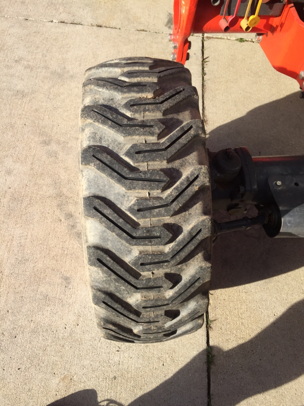

I liked it so much on my L3540 it is a must for the L5240.... I did the front tires and the outside tread of the rears ...

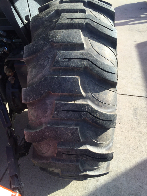

Rear
