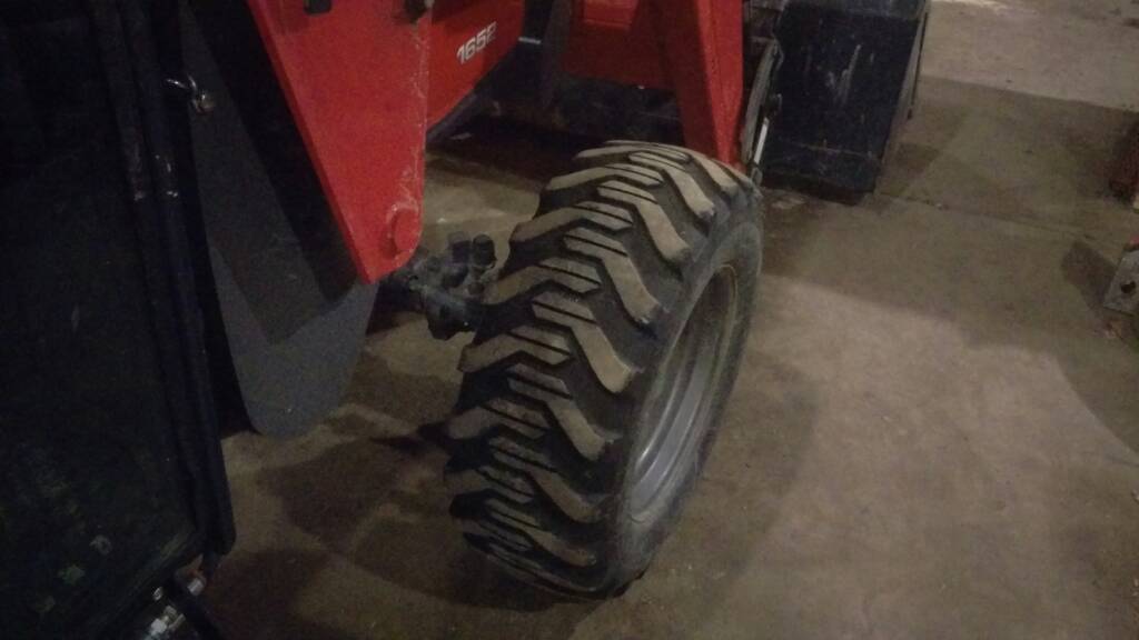

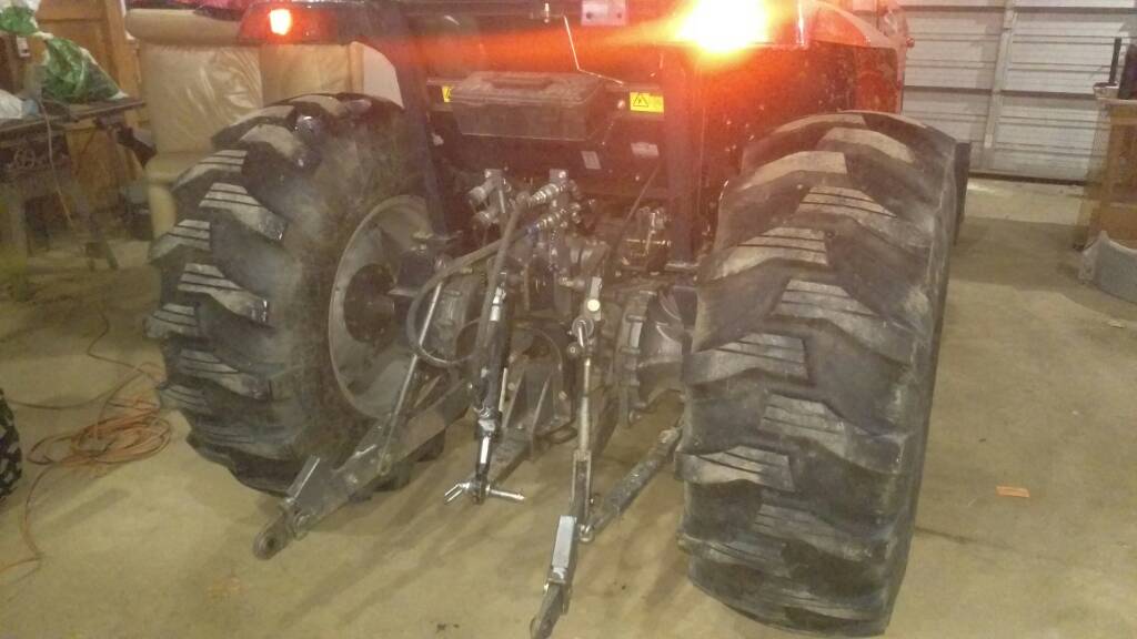

Just finished grooving my tires... Desperately needed it! uploadfromtaptalk1452028183781.jpguploadfromtaptalk1452028191272.jpguploadfromtaptalk1452028201582.jpguploadfromtaptalk1452028212367.jpg

TSO, is that a different pattern than on your LS? If it is, your review will be interesting.
   / Cutting / Groving / Siping R-4 for snow #444
I never grooved the LS, but I did do the other Massey. I basically followed the tread shape before, with just one groove in the middle of the lug.
This time I decided to just do horizontal grooves since the tires are basically moving straight anyhow. Plus it allowed me to add additional grooves on the rear

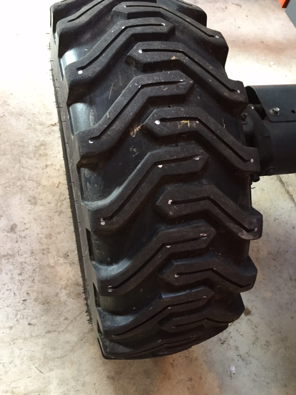

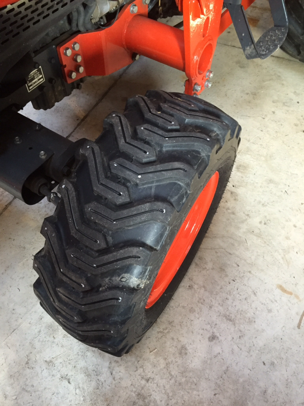

   / Cutting / Groving / Siping R-4 for snow #445
...with just one groove in the middle of the lug...
This is what I have now (sorry no photos) and plans to add extra straight across grooves, if needed... let us know how this works out.

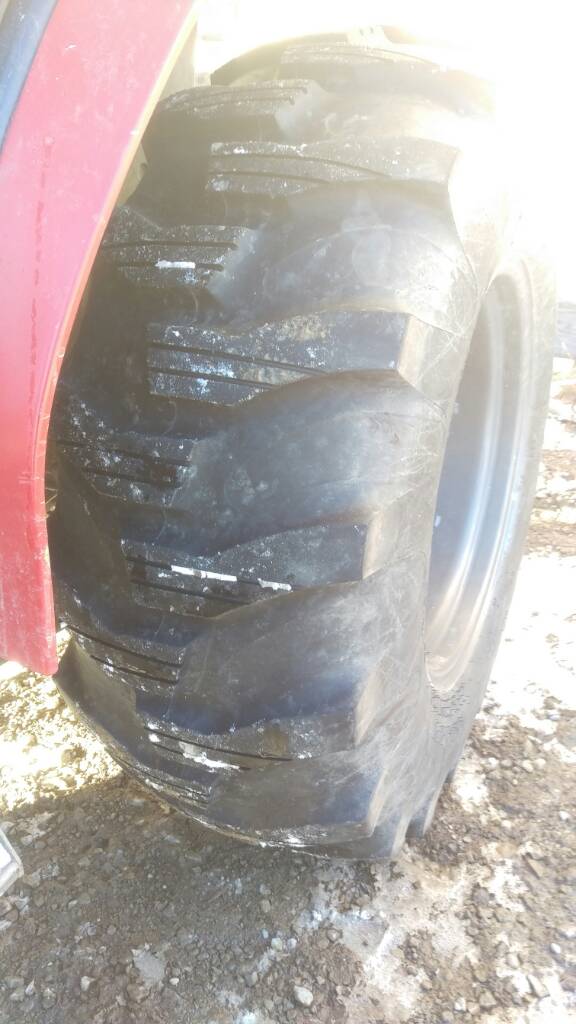

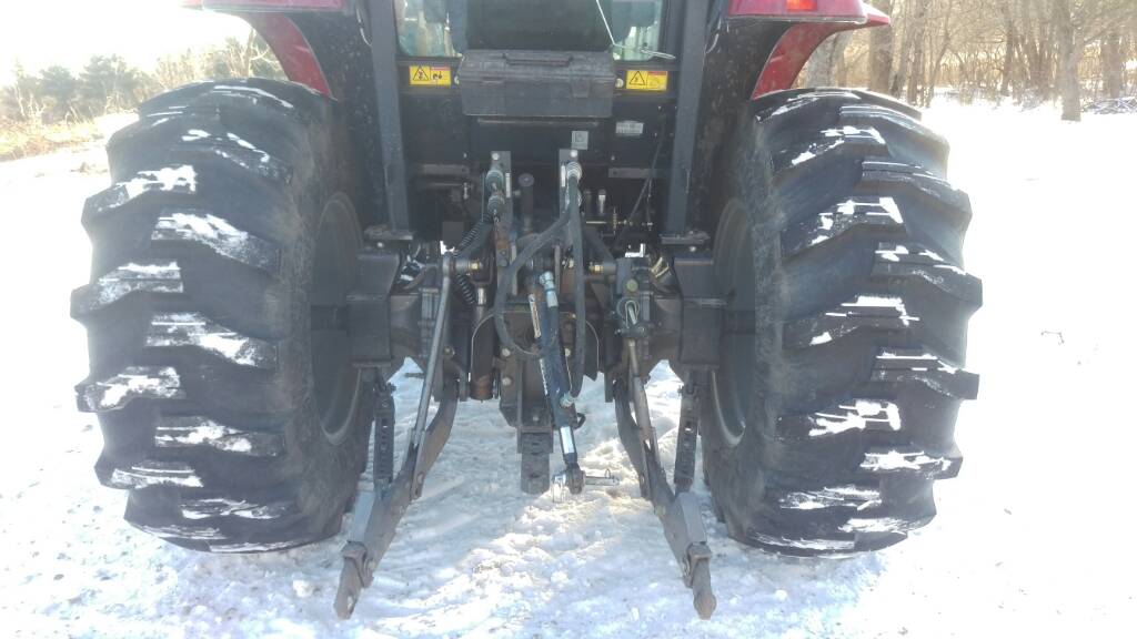

Ok, been following this thread since its start and have trying to get up the nerve to carve up my expensive tires. After this last storm with its 30" of snow I figured it was time to give it a try before resigning to the occasional chain usage (which I don't want to use on asphalt) I only did one front tire and it took longer than I anticipated but attributed it to the air temp (40) and it being my fist try at it. I put some dots on the tire for reference but did it mostly freehand. 3 more to go :)
