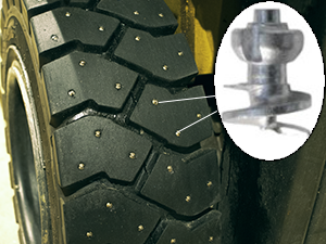

I may have posted this upthread, but since I see more comments about screws/studs I'll post again.
We bought screw-in carbide tipped studs for our forklift. We got the #1200 because we do use it inside on concrete. The only protrude about 1/32" but make an incredible difference in the snow.

I wish we had those in the 80's! A icy sloped parking lot with a fork truck is real fun. We did use the plain ice race screws that helped alot.

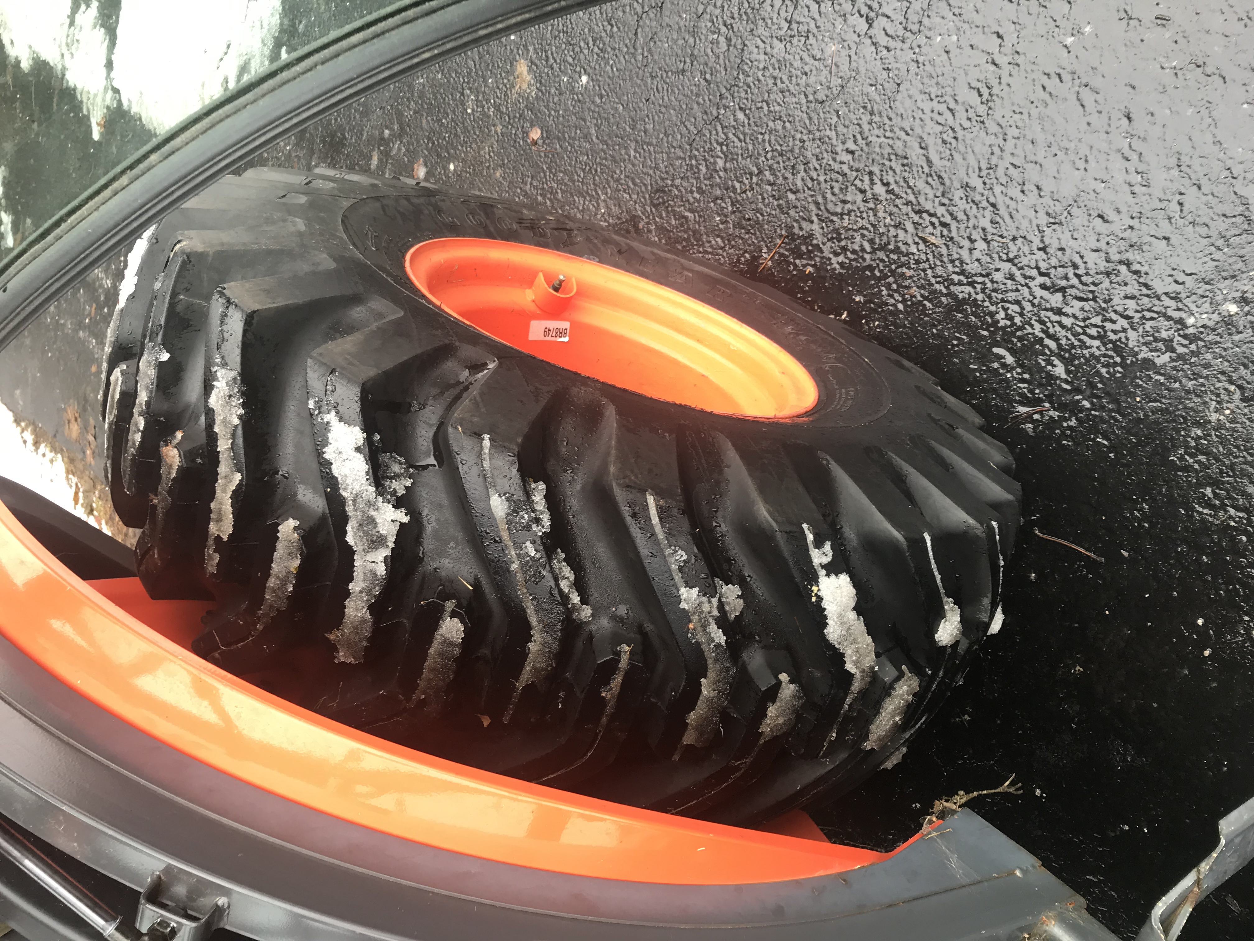

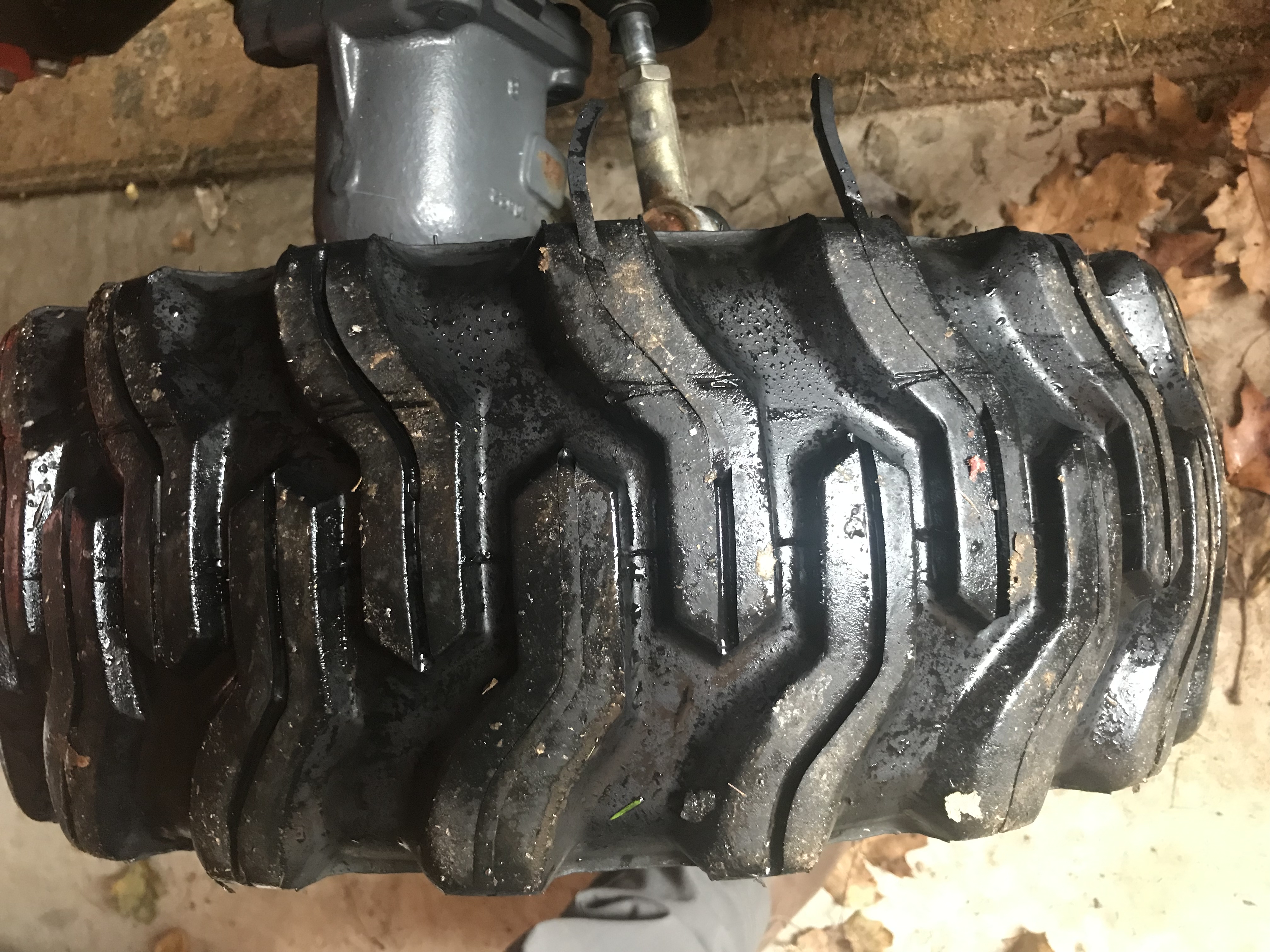

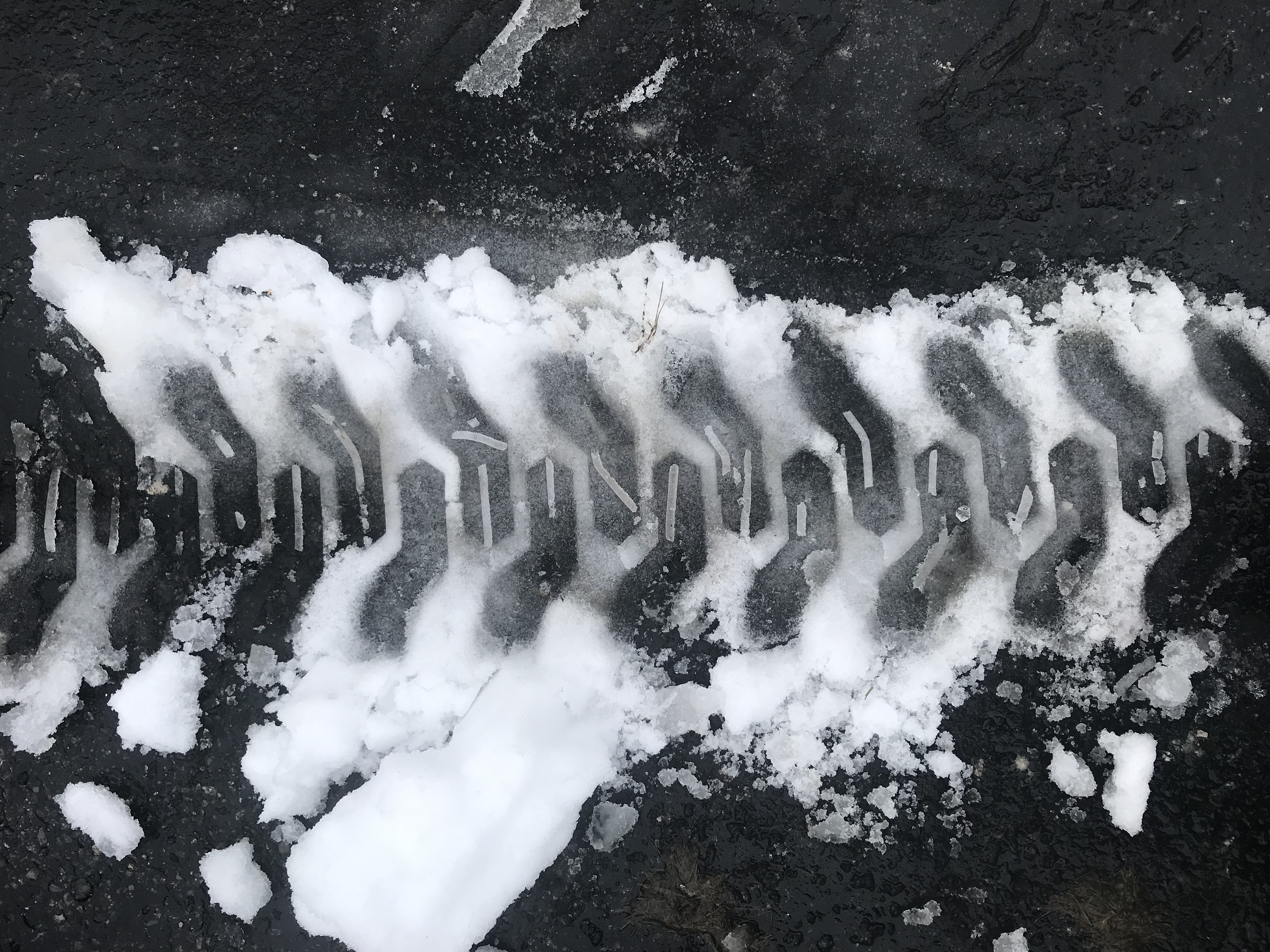

I grooved all four of my tires. I have nothing to compare it to - I didn't see the point of struggling for a winter and then adding the grooves to see how much better it would be.
The grooving itself went OK. It was near freezing and a bit windy. I can imagine it being quite a bit easier on a warm summer day, but it wasn't too bad. I did it in a total of three sessions. The first was a trial run - I did maybe a half dozen front lugs. Then I did most of the rest; I was getting physically worn out pushing that tool... Finished up with 26 rear lugs a couple days later.
Only used it three times in snow so far, but no problems whatsoever with traction. Thought I'd share a few pics that (I think) demonstrate why it works.

A lot of work but you won’t be sorry when you need the traction in snow or mud,nice job thanks for sharing.
