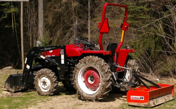

/ Cut the Exhaust stack #12
Nope, no weep hole in mine. I'm not sure about the fit of the Koyker loader, but my exhaust pipe is not the original in order to make more clearance between it and the loader arm. That weep hole could also prevent water from filling the cylinder with the open valve in a really nasty rain if it weren't covered. Since I don't store mine outside I'll skip on the weep hole for now, but it's a good feature. If I ever take off the lower portion of the exhaust I'll put the weeper in.
#13
Living in N.C. and keeping the tractor inside. I wouldn't be too concerned about the weep hole either. Good insurance though to have one....Time permitting.
