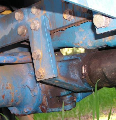

For dropping the front axle,
Don't forget the Front & Rear Mounts (Photos from my Ford 1715)

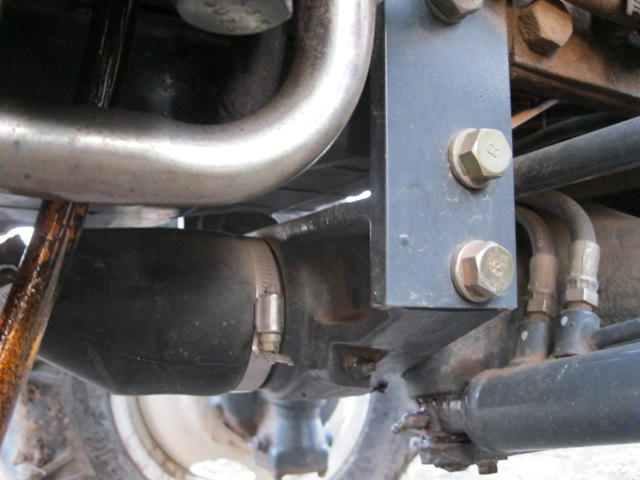

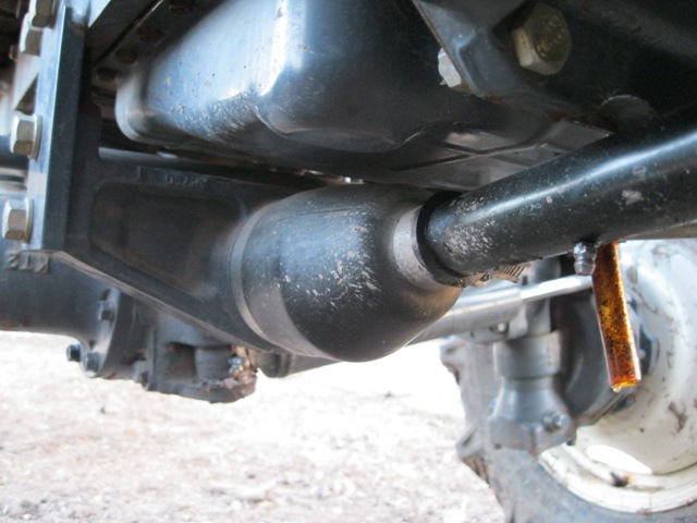

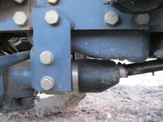

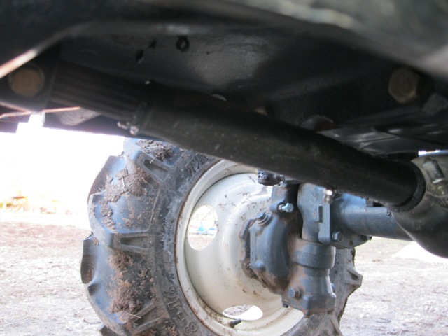

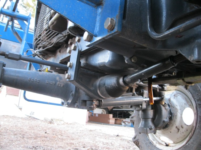

Wondering if, from these pictures, it seems to anyone that the 4x4 driveline might be affected from raising the axle 1.5 inches? You guys have better eyes than I do!axle 001.jpg

Having lifted many trucks (but never a tractor) my guess is that you should be ok assuming that there is a universal joint under that rubber boot in the last picture, another u-joint at the other end of the driveshaft and there is more than a couple inches of overlap of the splines in the drive shaft.
Looking at the third pic, what is the vertical spacing between the lower two bolts that attach to the axle housing? Without being able to see the tractor in person, I would suggest trying that distance as your initial test. Make/get a block that thickness -- even a chunk of hardwood lumber would work -- drill it to fit the front mount and install it with longer bolts. On the rear mounts, just use the bottom hole in the frame bracket with the top hole in the axle housing, leaving the bottom hole empty. This will easily and temporarily give you some lift that you can see if it will have the desired effect. DO NOT DRIVE THE TRACTOR LIKE THIS - ONLY CYCLE THE STEERING/AXLE FOR CLEARANCES. This will give you the chance to check other things like length of the hydraulic hoses on the steering, drive shaft binding and slip engagement, anything else that may be an issue, and obviously the tire clearances.
If this works, great, you can move forward with more durable modifications. If it doesn't work, not a whole lot has been invested and very easily reversible. It may also show you that you could get by with less lift - or may need more than you thought. Use as little of lift as you can get away with.
One minor (?) thought, as this mod will change the rake of the tractor, you will also want to make sure that the bucket will still sit on the ground with the lifted front end. I know some tractors have very little down travel from flat.
