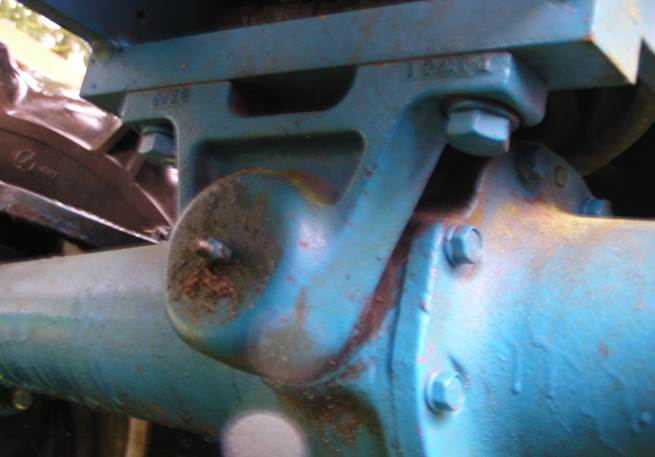

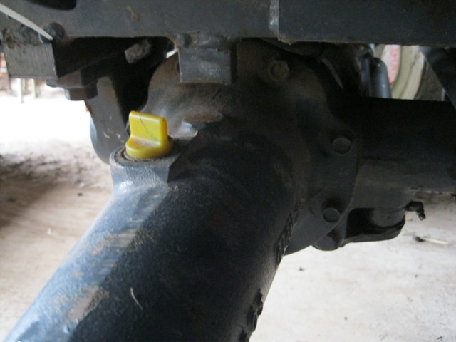

Thanks for the continued help on this. Thanks to your help, I now understand the issue a bit more, but still am trying to get to the bottom of it: The jam which the bolt should hit is so far away from the bolt end that it would seemingly take an extremely tight turn to get near it. Long before it would get to that point, the wheel rubs against the loader upright. Though my turning radius would be greatly reduced, stopping the turn just at the point of wheel-to-loader contact still gives me enough to get around.
Also perhaps relevant is the fact that there is a mark where the bolt must have hit the jam at some point in the past, with a past owner. But that mark does not seem to be aligned with the current bolt placement?
Thinking I just needed a longer bolt, I got two (75mm) and put them in. Because they are just 10mm bolts I suspected they would bend or snap off. They did bend as soon as they hit the jam. The jam seems to be at an angle; the bolt doesn't hit it straight on.
So now a question: are there bolts of this size that might be hardened to the point that they would not bend? Why would the current bolt be so far from the jam? Because I use the loader daily, I can't really take it off, and so am hoping for the bolt fix. I can use the tractor now (and will be needing to use it a lot soon, if winter ever ends!) but cannot stay constantly focused on not turning the wheel too far -- I'll probably ruin the wheels, or worse, in no time. Note: the bolt in the attached pic is the old, shorter bolt.

That jam would be designed to hit the bolt at a much sharper angle (shorter bolt). Even a Grade 8 bolt would likely bend. You could make a custom wedge shaped block that would bolt onto the hub, but it would still get a lot of transverse stress, especially if you have hydraulic steering assist.
If it was my tractor, assuming the tire modification is permanent, I would rebuild it to maximize the steering and eliminate rubbing. (perhaps building a wide skid plate to catch any bounce).
One option would be to cut another inch or two off of the bucket mount, but you may start to seriously compromise the integrity of the bucket mount.

[1] Once you recognize the bolt length required, raise the front end and turn the wheels till the bolt head contacts the 'pad' to see what the angle diff is. Square up the pad to match with a hand grinder, repaint.
[2] Look for '10.9' on a metric bolt head to get the strongest one commonly available. If it bends or breaks, repeat '[1]'. (Final grind angle will differ according to bolt length/adjustment.)

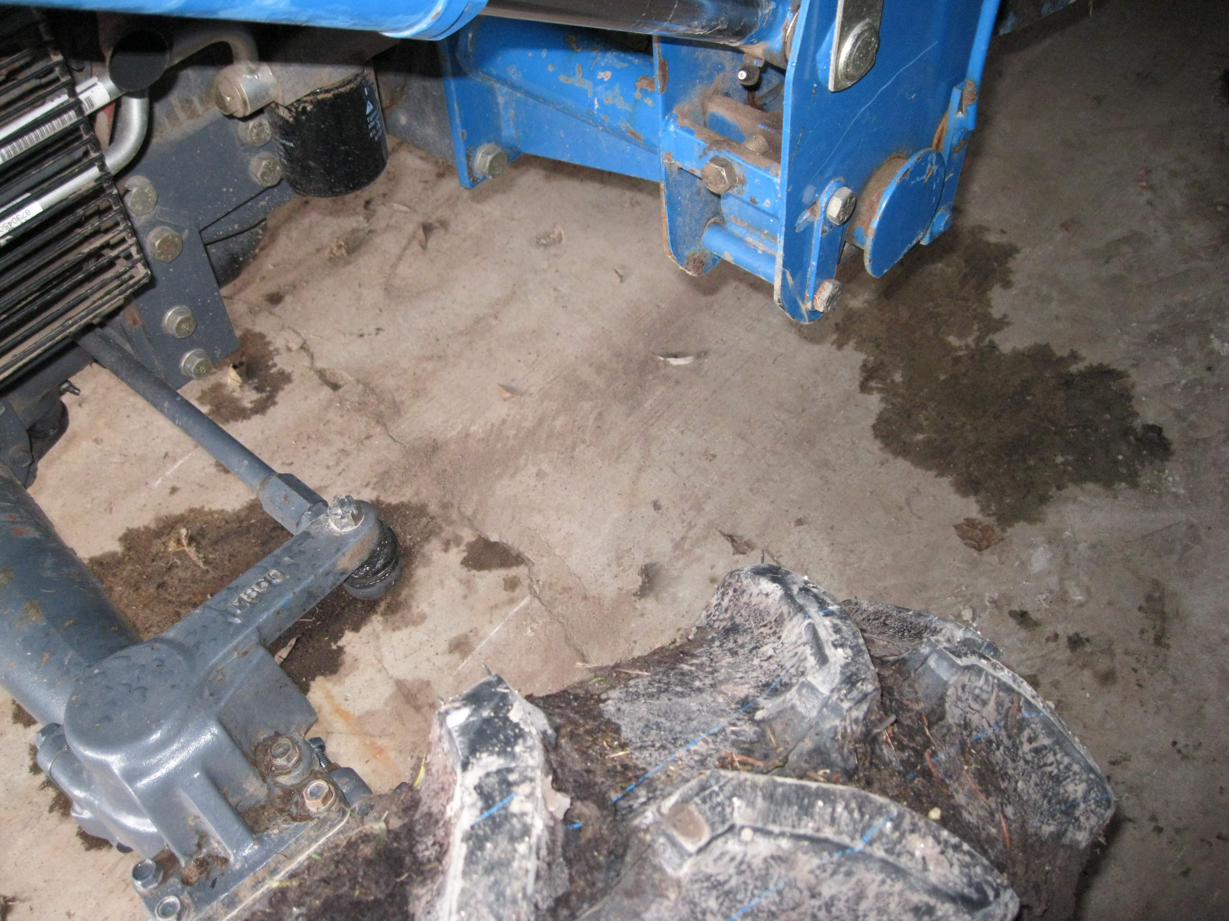

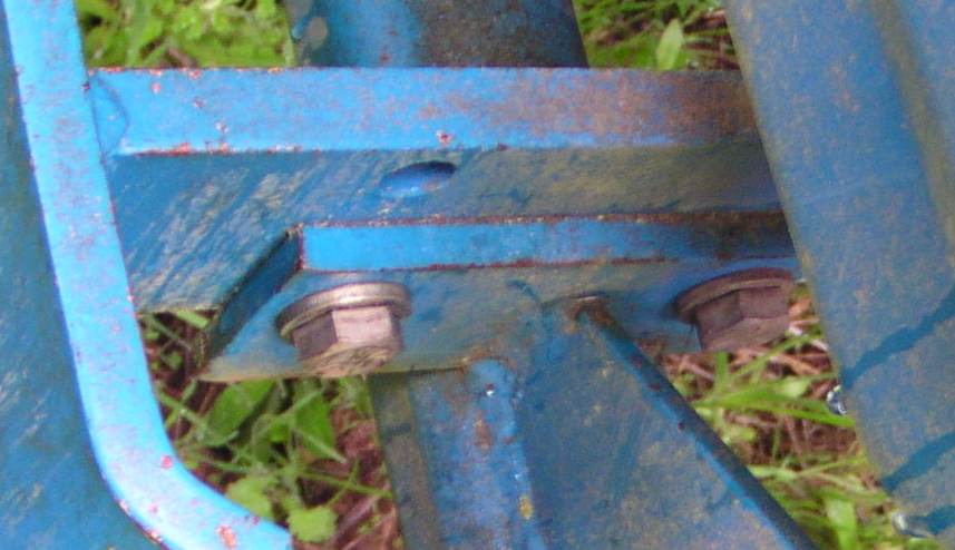

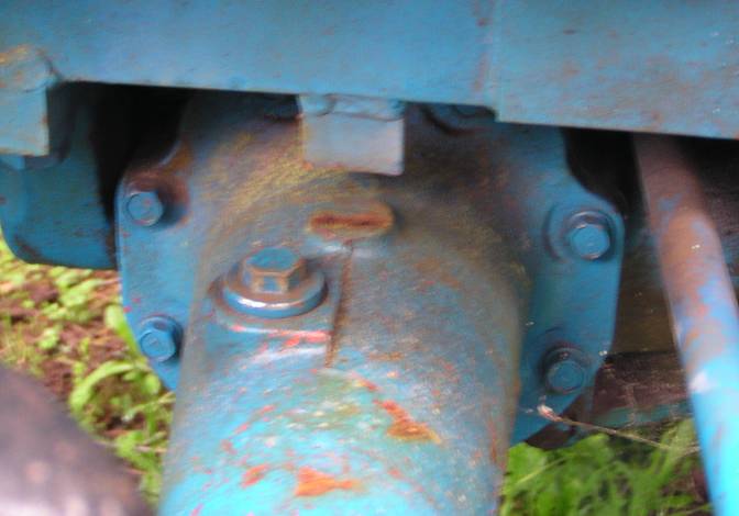

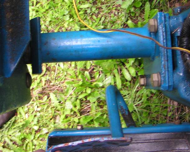

Because I like this spacing, I like your idea, CliffordK, of making some more permanent modifications so that I don't have to worry about bolts snapping, etc.
A few questions though, considering I am a novice who can't weld and doesn't have a lot of tools:
I did cut off the sharp corner of the loader, because it seemed like I only needed an inch or so. Seems like I still need just an inch or so.

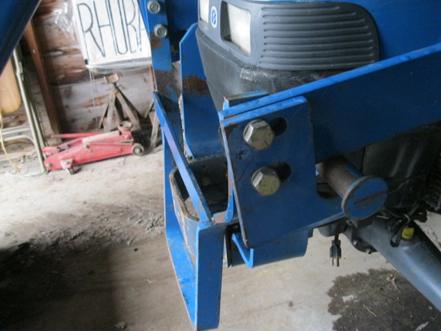

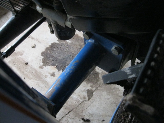

Because I'm so close, I like the idea of swapping the rear mounts. It would definitely interfere with the clutch though. What is involved in "rebuilding the clutch not to rub?" Also, it looks like I wouldn't have to redrill the front mounts?

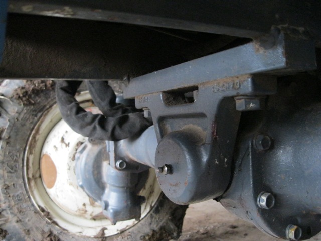

With the axle spacers, would I just add another plate above what looks like a spacer here? And would changing the spacing there, and compensating the axle tilt (what exactly is meant by this?) negatively effect the 4-wheel drive ratio?

For the interference issue, check the worst case situation as the axle pivots up/down over terrain. If it doesnt hit on the flat land it may be tolerable at worst case if you remove as much metal as possible and smooth the edges and are careful to watch the inside wheel as you turn. Also, when youre not in 4wd the independent brakes can sharpen a turn a little tighter than the fronts are actually turned. This could make up some for setting the stops out a bit.

There may be a couple of axle mounts (front and rear?), but you should be able to cut an inch or so spacer or spacers out of solid steel or solid aluminum.
The tilt stops above the axle would have to be extended. You might be able to make a bolt-on stop, but I'd probably just weld it on.
You can do some welding? Right?
Check the brakes. It didn't look like mine would rub if one reversed the rear bucket mounts. But, it might depend on wear and condition. You wouldn't want anything blocking them in an emergency.
The clutch pedal would either require removing and bending it, (Forge?), or cutting and welding on a straighter bar.
From your photo of the tire, it doesn't look like it should rub at all. But, obviously when you turn, the tire goes through an arc in which the furthest back spot is probably near the bucket mounts. The axle spacers would make this worse, with the arc moving further forward/back.
I'd encourage taking the front end loader off, jacking up the tractor and putting it on blocks. Or however you want to do it. Tilting the axle to 100%. Then turning the front wheel to observe the angle it goes through, as well as any other potential rub points.
No sense in doing custom mods to gain 1" or 2" only to find that the wheel goes through an arc which would still cause it to rub.
