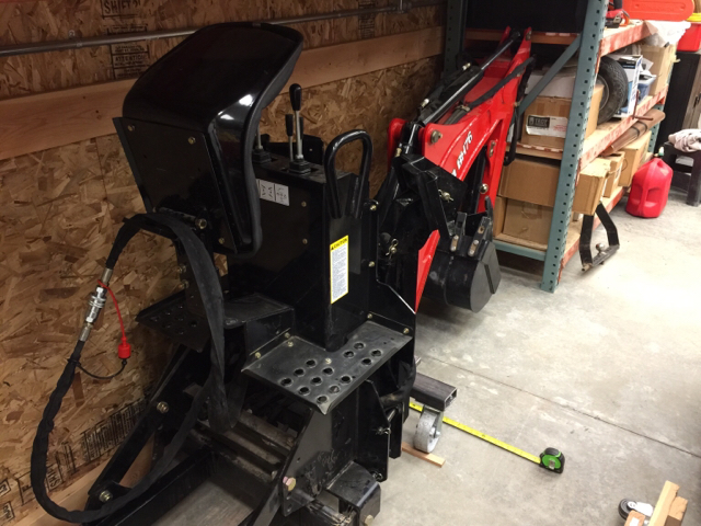

Glad it's working out for you. I'm going to try a foot pedal setup. Routing the hoses to the cylinder is going to be easy so I have no concerns there.
Mine's a 2015 3520h and I ordered dual rear remotes and a front 3rd function. Like you, I built a dolly for my BH in a way that fits under my pallet rack at 37" wide. (grin) Image1460097861.548915.jpg

I found the seat to be a little tight so I added more legroom. I added a piece if 3" x 5" steet tube beween the mount on the seat and the mount on the bh frame. This moved the seat 3" toward the tractor which made it more comfortable for me. Just saying in case someone else might be interested.
