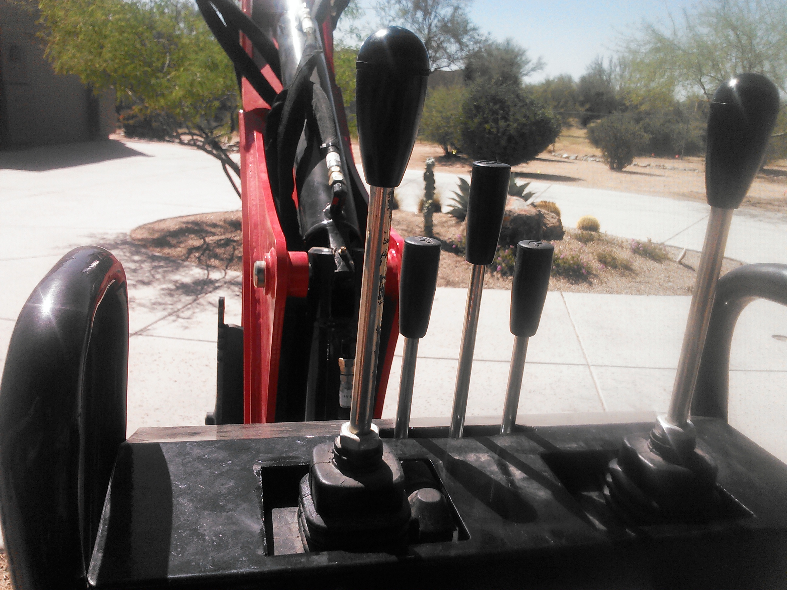

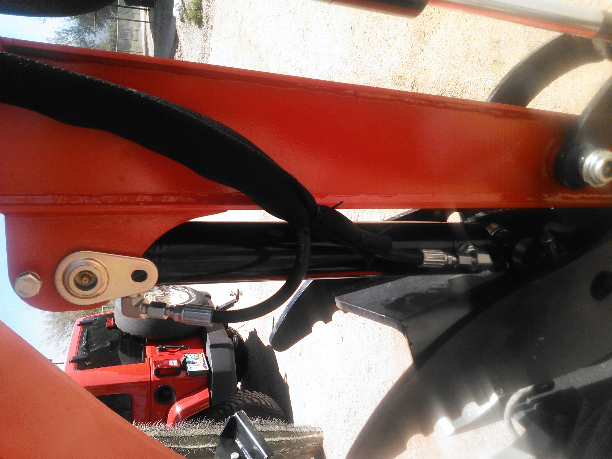

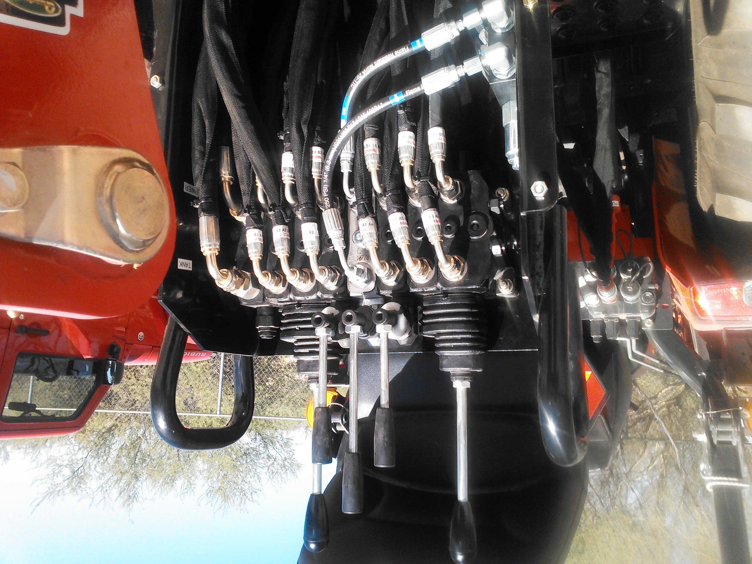

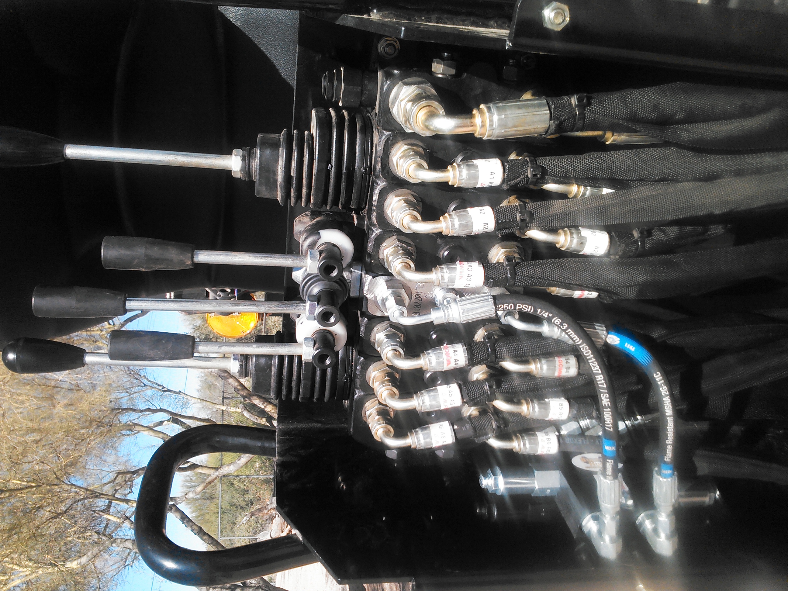

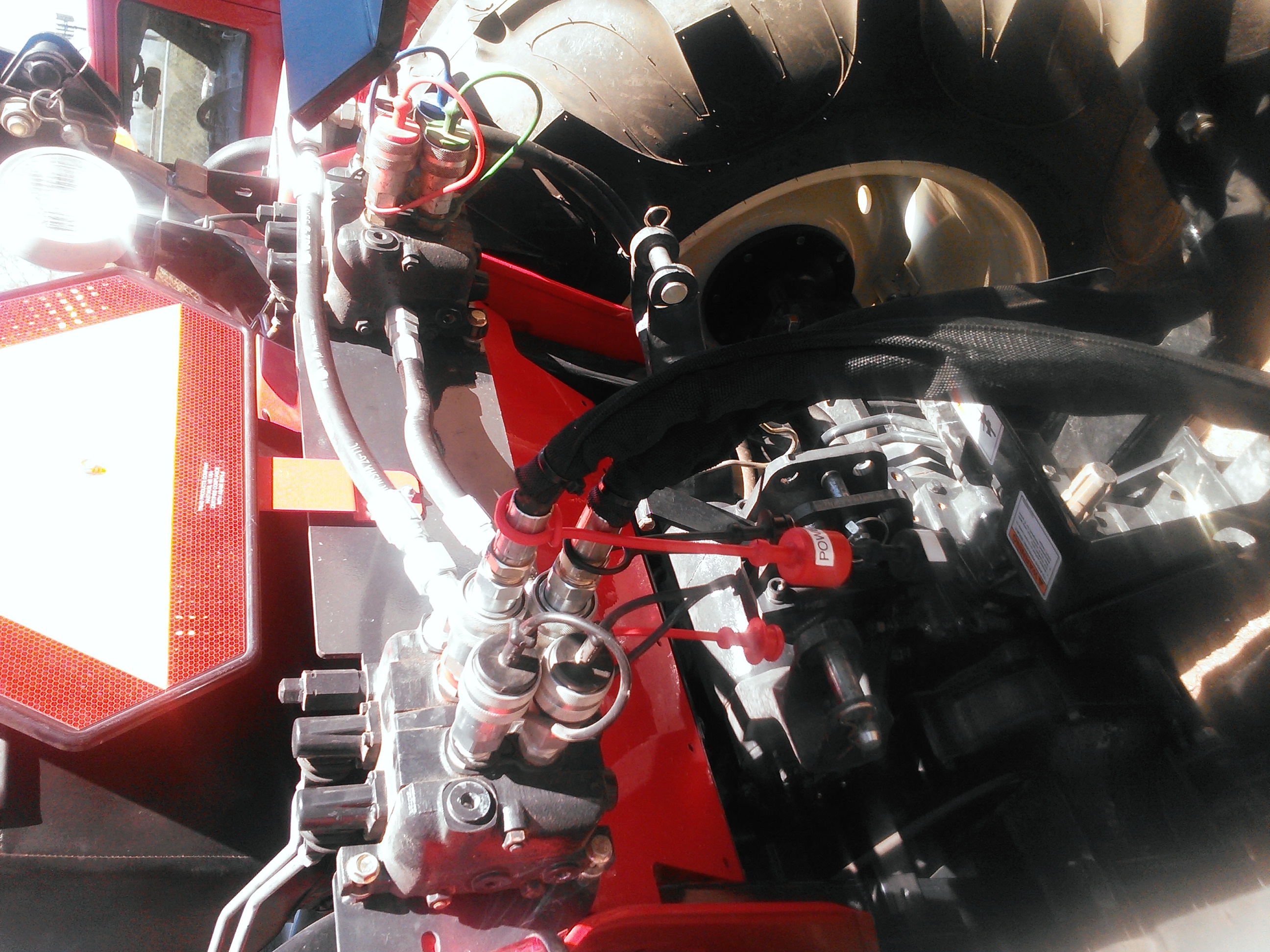

Aquamoose. I finally finished my hydraulic thumb conversion. I added another stablizer valve betwween the two stablizer valves. Part description: SDS100/7/Q-101-8L, Working section "Q" style w/o Rings Cyl. Spool Spring Center. Price was $224.37 from Hydraulic Controls Inc. Phoenix, Az.
The cylinder I used was from Bailey Hydraulics. 2" Bore x 10" stroke x 1.25 rod. This folds back the thumb to the right place without hitting the cylinder. SKU #207384. This cylinder allows you to rotate the ports 90 degrees from each other which helped with the install. Price was $175.00.
I also installed a double relief valve under the controls stack on the side to be on the safe side. Boltonhooks.com price $100.
The mechanical thumb just didn't work for me. I'm probably into this beween $650 and $700 when fittings and hoses are added in. You have to trim the sheet metal cover a bit to acomodate the wider valve stack and drill new mounting holes 3/4" wider on each side of existing holes. You also have to get 1 1/2" longer bolts to hold the stack together because of the valve you add in the middle being 1 1/2" thick.
All and all I think it was worth it, it is just like an excavator now. This was done on an Ansung BH65 which is one of the brands Branson uses for their backhoes.
If I ever figure out the picture loading on my Samsung Note Pro I'll load some for you.

   / Custom hydraulic backhoe thumb #208
Excavators have electric solenoid operated valves. To operate this backhoe thumb I installed a valve just like the stabilizer valves between the two stabilizer valves. I t makes the stack one valve longer, 1 1/2", which requires three new bolts to hold them all together and some sheet metal modification. It is just one more open center valve in the stack. I installed a handle that is two inches taller than the stabilizer handles right in the middle of all the handles. It is easy to operate with either hand and it is always available. No diverter solenoids, just another valve.
