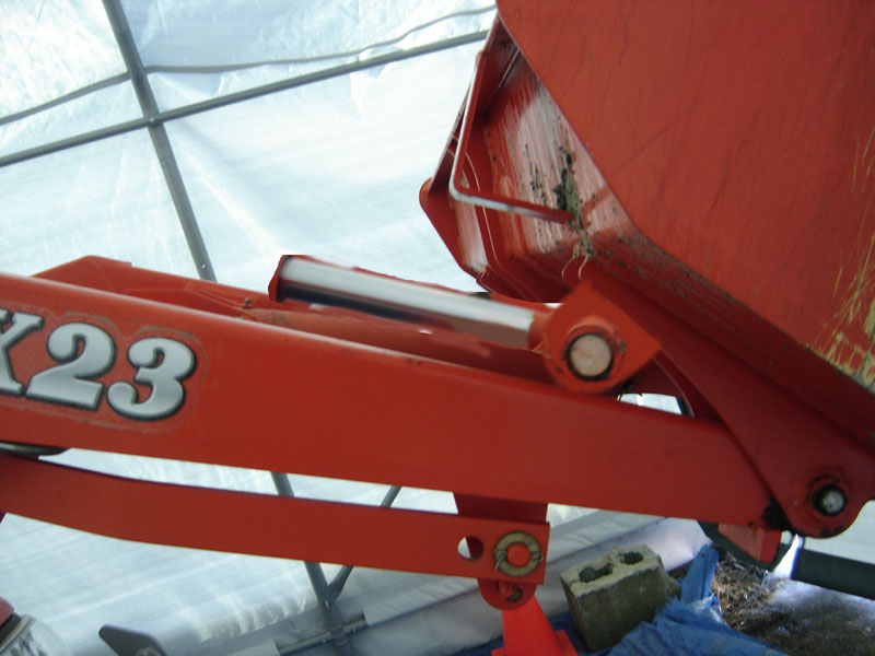

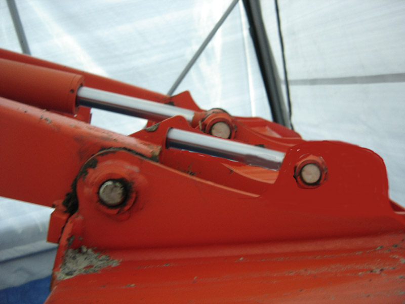

As part of the feasability study of this whole idea I went out this morning before I went to work and took a few pictures. I wanted to see if there was going to be clearance for attaching a cylinder to the FEL arm to bucket mounting brackets if the bucket was rolled all the way back. Then I wanted to see where the bucket ended up if was rolled all the way forward. When I got home tonite I pulled the pictures into Photoshop and did some quick hacking to try to come up with a picture of what I think might work here. The first picture shows the bucket rolled all the way back - in order to attach dual cylinders I would either have to somehow separate the existing arm pivot brackets from the bucket and make new ones ( I know these brackets are a standard size so I can get the steel easily) - or I would have to weld on an extension to the bracket to attach the end of the cylinder to so it would clear when the bucket was rolled all the way forward.
I have looked at a few different FEL quick attach setups on John Deere and Kubota tractors and the John Deere is the one that looks the easiest to duplicate. I also read thru a post from kennyd where he made a quick attach plow setup for his JD and the pin and hook pieces for the JD type are available. The Kubota quick attach has a cool lever that locks the lower part of the QA to the bucket - it is neat but looks hard to duplicate.
I think this can be done without moving the bucket any further out on it's pivot point. It can also be done with a minimum of steel so I wont be increasing the weight out at the end of the FEL arms by a significant amount. It looks like the biggest technical challenge is going to be finding the right size cylinders to use for the dual setup. If I have a chance this weekend I will take a trip to a few dealers and take some measurements of dual cylinder FEL's on JD2210, MFGC2300 and maybe some smaller B series Kubotas or New Holland's. That ought to give a good starting point.
Does anybody have recommendations on who manufactures quality hydraulic cylinders? If I could find a stock Kubota (or other tractor mfg.) cylinder that fit my needs would it be worth buying thru a dealer or would that cost way more $$$ than needed? I have Northern Tool and Surplus Center catalogs and I know there is a pretty good selection in both of them too.

Picture (with Photoshop hack) showing bucket rolled all the way forward and imaginary bracket. For the upper mounting point for the cylinders I would add some steel mounting points similar to what the JD2210 and MFGC2300 do for their dual cylinder setups. I think if I did this I would just leave the bracketry for the center curl cylinder on the bucket. It would be a convenient place to mount a cylinder for a grapple hook cylinder if I ever chose to do so in the future.

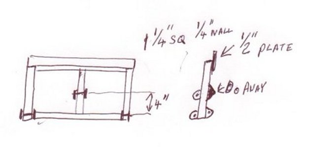

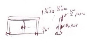

Why not build a sub rack that uses all stock mounting points, then add lower brackets that would allow slide pins to attach original lower clevits, add u channl to top of bucket to catch 1/2" plate on top of sub rack. Would also be good place to hang forks off of old fork lift.
Here's simple drawing. This idea and measurment came from looking at a LA211 loader
   / Hydraulics and FEL modification questions #19
I forgot to mention that using sub rack would not move out piviot point. If u are worried about the 3" extenison buy more tractor. /forums/images/graemlins/shocked.gif /forums/images/graemlins/shocked.gif /forums/images/graemlins/confused.gif
