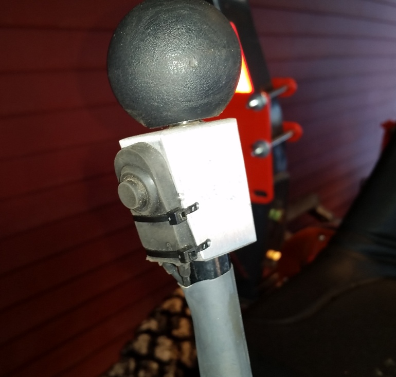

Zip-tied to the handle so you can hit it with your thumb is very ergonomic. I have 2 on my Kubota. One for the thumb on the hoe and one for the diverter up front.

That looks quite weatherproof. The switch I and Racerwannabe used doesn't look so, but is also waterproof according to the description on Amazon:
Amazon.com: Alpinetech 19mm 3/4" Waterproof Momentary Stainless Steel Metal Push Button Switch Screw Terminal Extended Button Normally Open 1NO: Automotive
The downside of the switch we used is "some assembly required", in that a mount of some sort needs to be fabricated - that may also be a plus, as one can build a mount to suit (though it took me two tries).
As you said, the rubberized switch lends itself to an easier zip-tie installation and there's significant appeal in that. I suffer from the, "I can make that!" syndrome - a sickness, but one that has served me well :c).

AVC: Could I trouble you for a photo of both switch installs? Anything you would do differently? A bucket grapple may be in my future too.
I spent three hours on the machine yesterday pulling rocks and stumps on the snowmobile trails. That hydraulic thumb is AWESOME and really speeds up the work. What a great mod!

Thumb switch 2.0
Mounting block slips over shaft and stays there with two set screws. Zip ties best thing I could come up with to keep the switch on the block

Thumb switch 2.0
Mo' betta :thumbsup:

No worries ac. Part of the fun is coming up with the design on your own. In this case, I was very constrained by the size of the scrap of aluminum bar stock that I had kicking around in the shop. That block has some tooling marks on the other side that I couldn't avoid. If my OCD really kicks in this spring, I might have to butter them with Bondo and paint the thing. Right now just having a ton of fun playing with the thumb to rip out stumps and rocks before the ground freezes (which will likely be tonight!)
