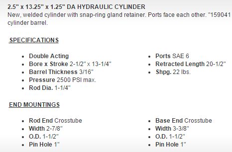

I'm still a little worried about the 3/4" pins given the forces involved.
You should be. Somewhere in this thread, I posted about this issue when I talked
about converting from mechanical to hydraulic.
On a couple of my mechanical thumbs, I bent the 3/4" pins I used. Of course, my
Deeres and Kiotis ran at 2500psi, while my Kubs were down at 2000. I think your
B is also limited to 2000psi. Check that. 1" pins should be used, IMO.
To belabor another point I made, converting an existing mechanical thumb will
force you into getting exactly the correct hydraulic cylinder stroke and length. This
is cuz your pivot point on the thumb is already fixed. I suggest you use mockups
of your cylinder to get the length and stroke just right. Even a 1/2" off and your
rest position against the dipper will be sub-optimal.

You're correct. My max pressure is 1991 PSI per Kubota WSM.
Sounds like I gotta nail the retracted length @ 20 1/2" for sure - no compromises. I could get there with the original 12" stroke cylinder that I was looking at by hacking both ends off and converting to 1" DOM and adding a 1/2 spacer on the cylinder end. That would get me to an "effective" extended length of 12 1/2" vs. the 13" extended length of the mechanical linkage. Any of the longer stroke cylinders that I looked at from Bailey's have a retracted length that's too long.
The good news is that my existing thumb linkage is linear; Channel that slides within another channel. So it mimics the operation of a cylinder and makes taking measurements pretty simple.
I'll search on on here for other sources of cylinders. Suggestions welcome! I imagine a true custom cylinder will cost an arm and a leg.

While I agree with dfkrug, 1" is better than 3/4", Bolts and pins in shear are incredibly strong. A 3/4" Grade 8 bolt is over 40,000 pounds. Of course this is measuring pure shear, not the fasteners ability to span a gap and resist flexing. This is why, when you inspect a piece of hydraulic equipment, the gaps or spaces between cylinder clevis and their mounts will be minimal, typically a thick boss or bushing will be welded to the structure and will mate up to the cylinder clevis with 1/8" or similar gap.
On my B3350 tractor, the WSM says 2450 psi for the relief valve setting. Backhoe may be less, haven't checked, but the machinery operating pressure will be whatever the relief valve with the lowest bypass setting in the circuit is. BTW, it seems small tractors often have their hydraulic relief valves set low for some reason, and more power can be had by adjusting them to spec.
If you have the machinery to cut and weld, then starting with a cylinder that is too long, it's possible to custom make whatever length you need, within reason. Best to take the cylinder apart, before cutting and welding, but not required. If the cylinder needs to be shortened, the ram can be extended and the cylinder end cut off, shortened and re-welded. Wrap the barrel with wet rags and extend the ram fully to weld it back together without disassembly. Same idea for shortening the piston rod end, or welding in a spacer between cylinder and mounting clevis to lengthen the retracted dimension.

I'm obviously a total newb when it comes to hydraulics, but am learning that these cylinders are much lower-tech than I thought. Thank you all very much for the lessons!
So in the absence of the "driven attachment" stopping the travel of the ram (like the thumb grasping a rock), what limits the travel of the ram? In extension, it's gotta be the piston hitting the inside end of the barrel since Bailey's told me I can limit the extension by putting a bushing on the rod. Is it the same in retraction? If so, then shortening a cylinder will cause loss of stroke travel, right? Or is there some other type of mechanical stop inside that results in squish (like in engine combustion chamber) where you could shorten the barrel and whatever stop is in there to reduce the squish, but not compromise the overall stroke travel?
You must match the thumb cyl ID to the dipper cyl ID, unless you want to mess around with work-port relief valves.
Not messing around with those! Wanna keep this as simple as possible. Less stuff for me to break.
I've learned that as well. This is a popular adjustment with the guys that own the little Kubota BX hoes. Of course I learned this AFTER I had the hoe installed on my tractor, otherwise I would've had the dealer check and shim the relief valve back to spec. But I must say, this is a pretty strong machine as is...
Update: I may have stumbled on a cylinder that will work with only minor trimming (3/16") to the base cross tube:dance1:
20.5" retracted length, 1" pins, and 13.25" stroke. Any reason NOT to consider a 2500 psi cylinder when my relief valve is supposed to be < 2000psi? The hoe cylinders are 3000 psi. I guess the only issue would be if I ever sell the hoe I gotta tell the next guy that it's only a 2500 psi cylinder if he's putting it on a strong tractor
