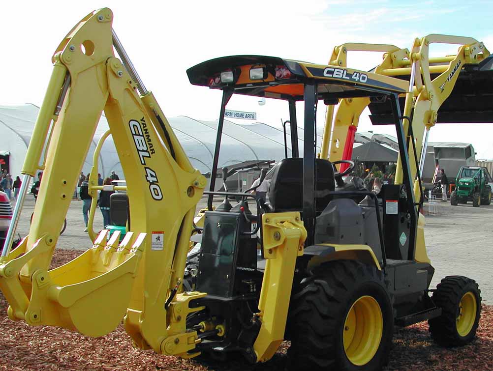

That said, what a fine industrial tractor, the Yanmar CBL40. Does it have an extra valve on the
hoe, for an added function (thumb, auger, breaker, etc)? What is the system hydraulic pressure?
My guess is it runs at about 3000psi for the FEL and hoe.
Finally, what are the extra 2 holes in the dipper for?

Been happy with the machine, Basically a stripped down version of the JD 110 TLB, 2nd owner mostly used on my property but has been dug a few small foundations already. I don't believe a bolt on would work for me, I tend to work my equipment a little hard. I have welding set up so that wouldn't be a problem. Unfortunately the machine is bare bones, No aux. hydraulic set up. That's why I was thrilled to find your posts, seems it would be a good set up for me without becoming a major project, time is scarce lately.So That is why I hoped to use an prefab hyd. thumb and then add your hyd. setup to it.
According to manual the backhoe runs between 3400-3675 psi, FEL is 2350-3000 psi. Didn't realize till now it has 3 separate hyd. pumps.
As to the extra holes, couldn't tell you, mine doesn't have them.
Wouldn't mind any additional input- Thanks!
