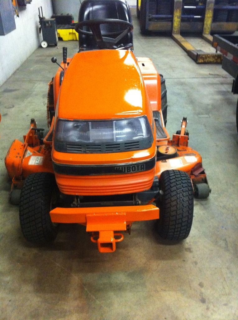

I picked up a B2750 front snow blade because I couldn't find one meant for my little G series mower. It was meant for a B5100 or B6000. The G2001 blade that was designed for my tractor used some goofy linkage that ran off the deck, but were discontinued years ago, so for 150 bucks off of craigslist with the hydrualic cylinde, i went to work...

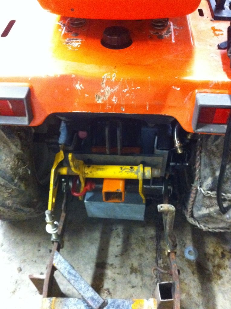

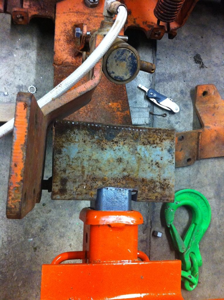

I fabbed up a front reciever style hitch. I wanted to keep from cutting ther factory blade mounts incase I got a bigger tractor that I could use it on.
I basically took a piece of 4" channel and then welded it to a 2" box tube for the reciever.
plenty of clearance though the range the movement
I sandblasted and wire wheeled everything then coated it with some POR15 and then threw some kubota orange on it. I tied in the hydraulics to the mower deck circiut with a three way valve so I can switch between the two.

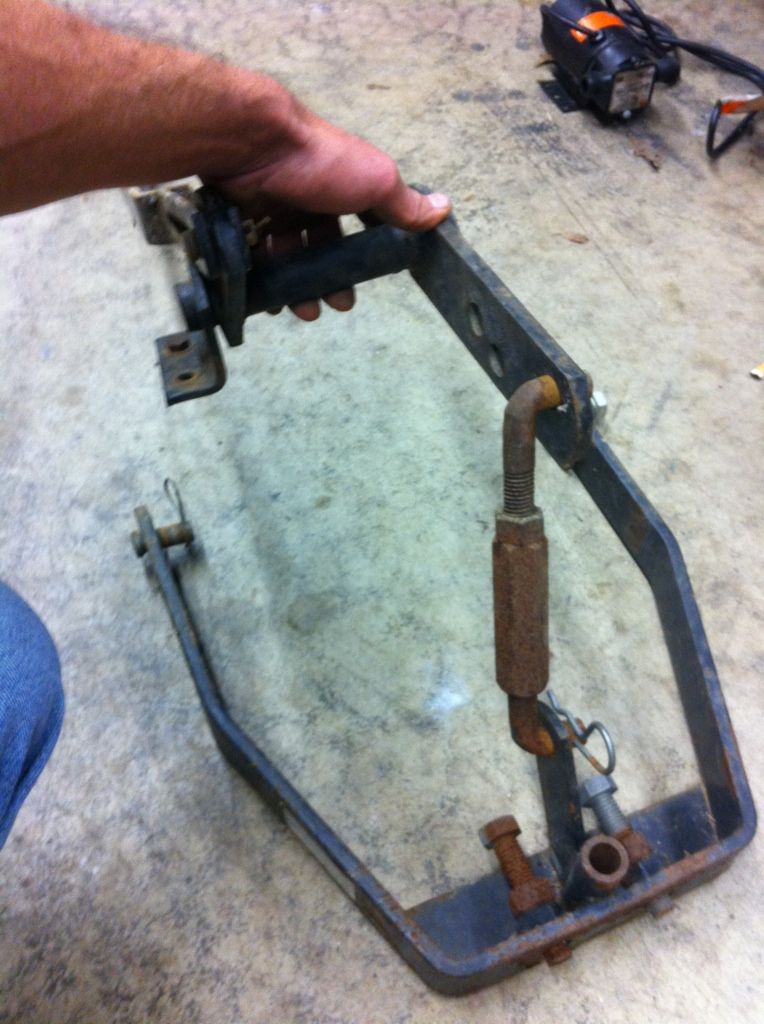

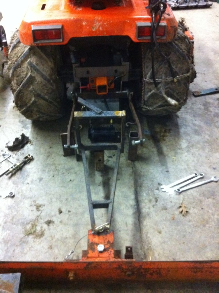

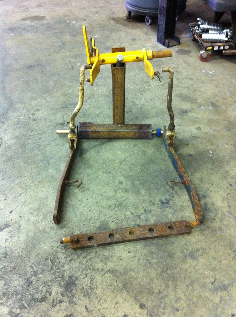

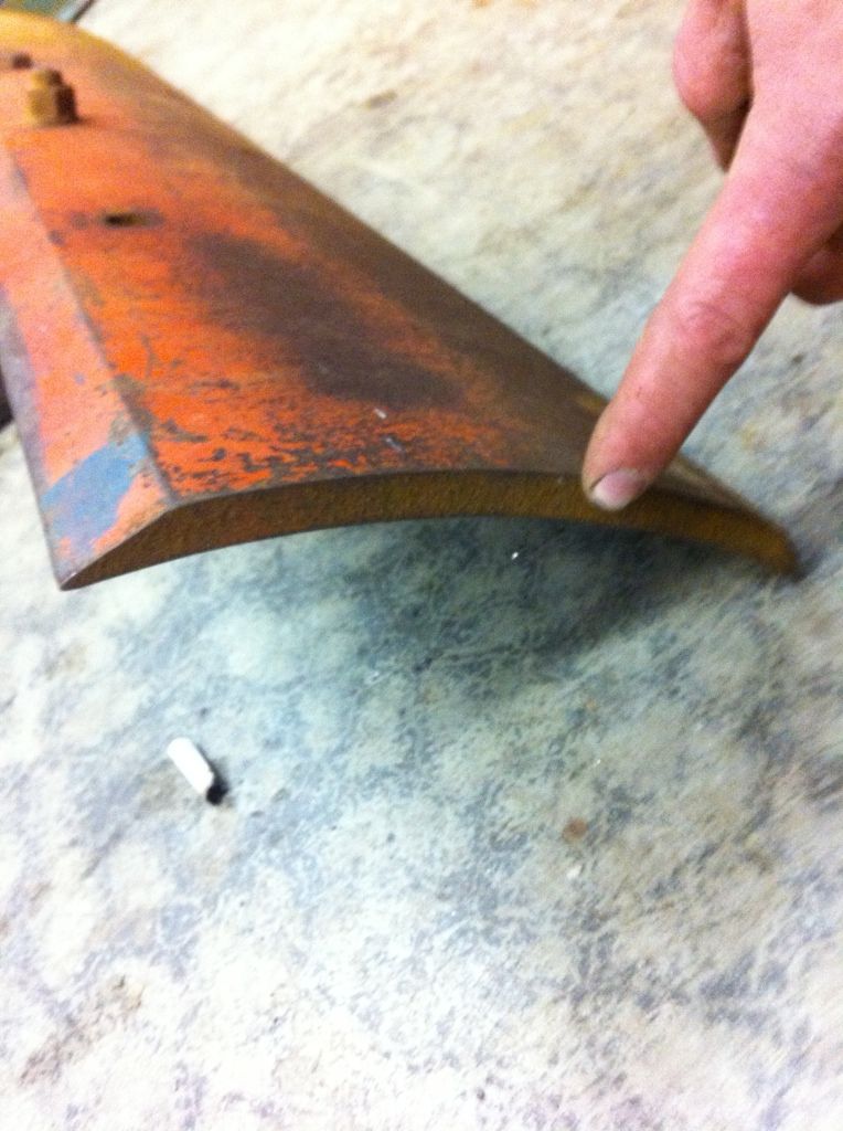

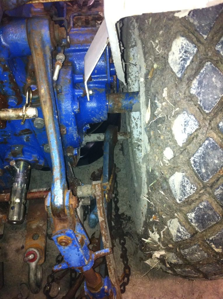

Before I bought my little Satoh 4x4, I starting fabbing up a rear 3 point hitch. They offered one from kubota, but after months of searching for part numbers and trying to find a used one, I just decided to make my own. I picked up a cat 0 sleeve hitch from an old MTD tractor and found a 3/4" thick 45" rear grader blade. It looked like a kubota piece, but cant seem to find out what it was originally. I made a rear blade mount out of a scrap front blade setup from an old wheel horse. I have 40 bucks in the rear hitch, blade and bracket assy.
I reinforced the pivot bolt area as it is only a 3/4" bolt.
I drilled a 1/2 hole in the new block to act as the blade stop/adjustment
The blade head simply bolts on with two 7/8 bolts. It also has an extraset of holes so it can be offset 1 foot to either side, or can be reveresed to push instead of drag.
After scouring another tractor junkyard, I found this cat 0 rear three point setup off of another old style MTD with a drawbar.
I took a piece of 2" x 3/8 wall box tube and welded some 3/4" nuts in it and then took some grade 8 bolts and cut the heads off for the pins, then drilled them for cleavis pins. The tube will get welded to the bottom of the hitch. I cut out some brackets that will get welded to the frame so that the hitch and whole three point will be rigidly mounted to the frame and rear end for extra support.
I got a mower deck lift cylinder and single spool valve from a new holland/ford garden tractor for a whopping 45 bucks shipped off of ebay. The only thing I have left to do is make a cylinder mount on the outside of the frame channel and figure out the upper pivot tube. i've got quite a few different options for the lift arms. I scored the upper top link mount and cub pivot tube assy from the same junkyard as the MTD cat0 three point hitch. I think i have 35 bucks in that whole setup. Now I just need time to finish it. I'm going to make a sleeve hitch adapter so I can use the brinly single bottom plow and the brinly single row disc that my uncle gave me.
