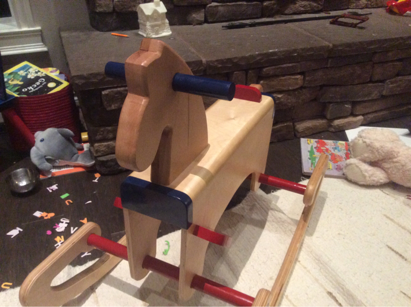

I made a rocking horse for my boys. The body is a single piece of Baltic birch plywood and the bends from the sides of the body to the top are probably only 1-2" radius.
These bends were hard to make, since they are so tight. I made kerf cuts, and I don't remember now, but I think they only had 1/8" space between the kerfs. The kerf goes all the way through the plywood, except for the very last ply. Even with that I had to steam it to get this tight a bend. Once steamed and pliable all the kerfs were filled with hot melt glue from a glue gun and then it was bent around the form and clamped to cool.
If you are not familiar with Baltic birch plywood, it is made of solid birch with no voids between the laminations. Normal plywood has a core of poplar plies and then just a veneer of the desired wood. The plies on Baltic birch are very uniform, so it actually has an appealing edge grain. It comes in 5 by 5 sheets and most lumberyards stock a few sheets of it.
Your project is a much larger radius, so if it were me I would use 1/8" thick Baltic birch which should bend to that radius with no problem. I would make it out of four layers of the 1/8" ply to give me 1/2". The first layer I would bend around the form and attach. Then glue the next layers on. Use white glue, rolled on with a small paint roller, and put it on both surfaces, not just one. Once all the layers are glued and stacked on the form they can be clamped secure with 1" ratchet straps. Once the glue cures it should hold the shape. Maybe do a sample glue up first to get a handle of it before you do the final project.
Either way you chose to do it post some pics!
