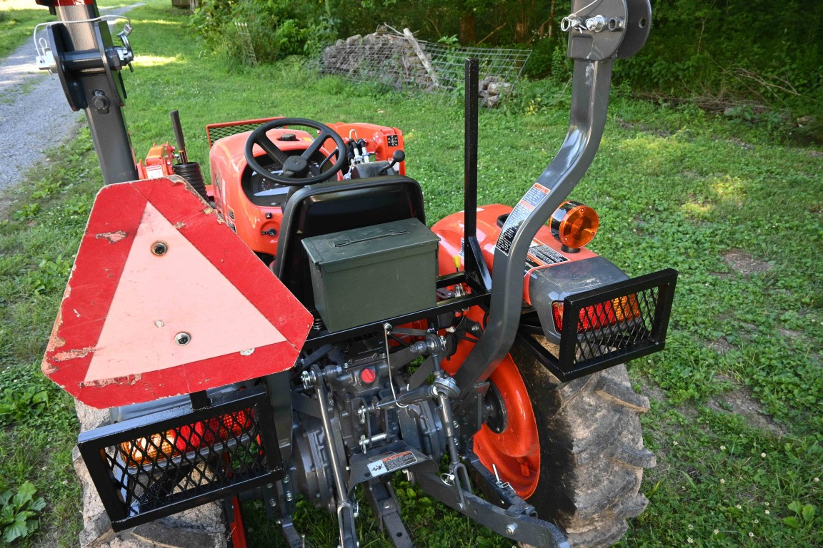

One of the first things I did was to substitute a HF ammo can for the plastic Kubota toolbox, but I wasn't happy with the stability of the cross member holding the can, especially when loaded with a logging chain. I've also been concerned that the Kubota tail lights stick out enough at the rear that it wouldn't take much for them to get damaged. And I wanted a handle to grab when getting onto the tractor.
I had some 1" square tubing that happened to fit between the ROPS and the fender. Ended up making a new cross member assembly to hold the ammo can and added a grab handle. I also extended the tubing to make a protective cover for the tail lights and to hold the slow moving object sign.

Nice work
   / Current pricing L2501 and transmission choice
#85
Thank you.
