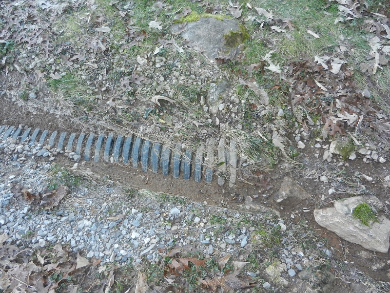

Went out a while ago and started poking around with the hoe.
Looks like it is about 12" ID (eyeballing it) It is single wall and, it's full of sediment!
As I tried to lift the end out of the ground with the backhoe, it broke about three feet of pipe. I'm guessing it will do this to the rest of it as we dig it up. That's ok.... we'll need to get the dirt that's in there, out somehow. Sections will make it easier to handle. Could barely lift this piece (by hand) with the sediment packed in there.
Now, where on earth do you find dual walled corrugated pipe like this?
Box stores don't seem to have it. Been looking online and coming up with nothing nearby.
