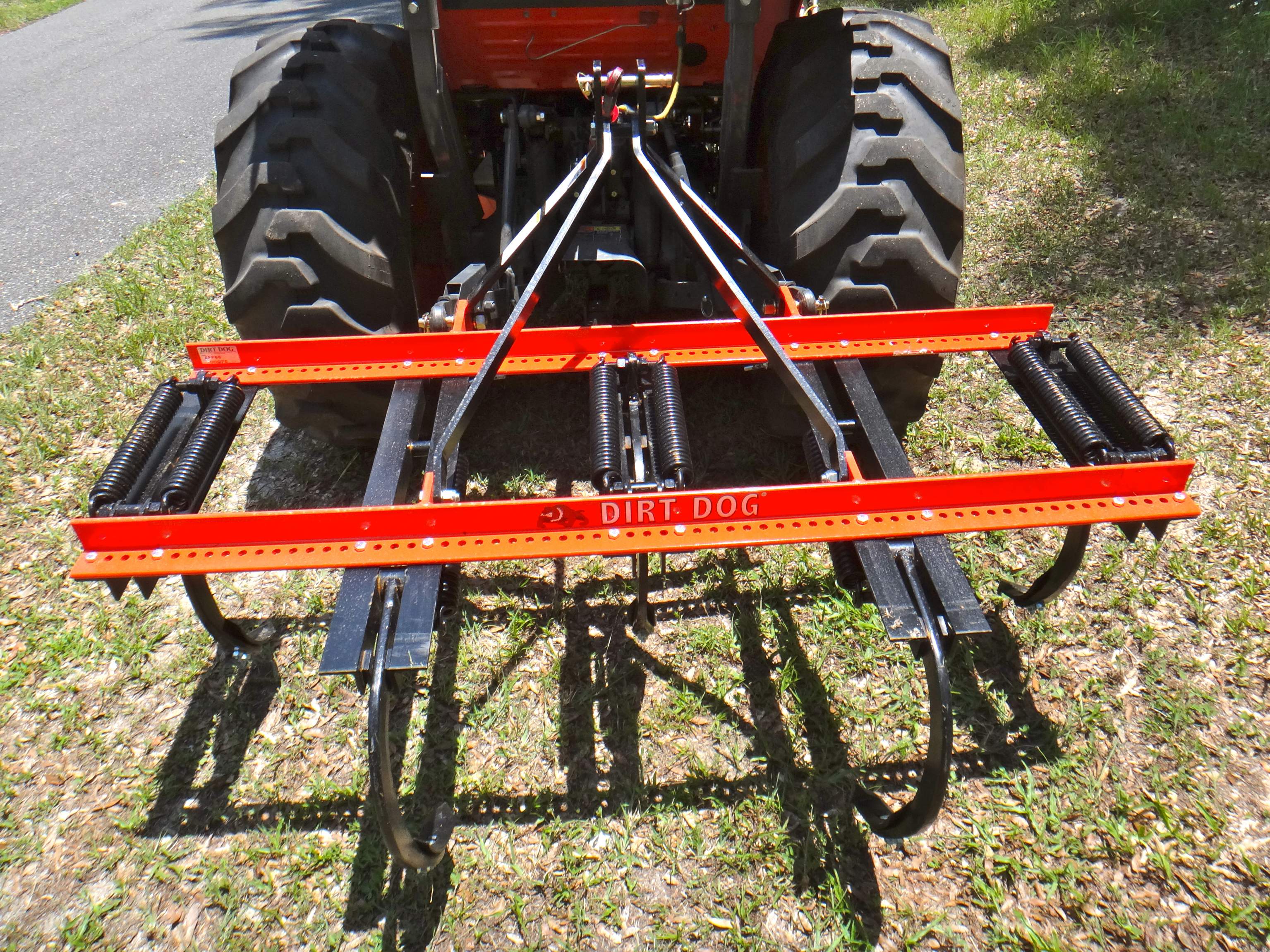

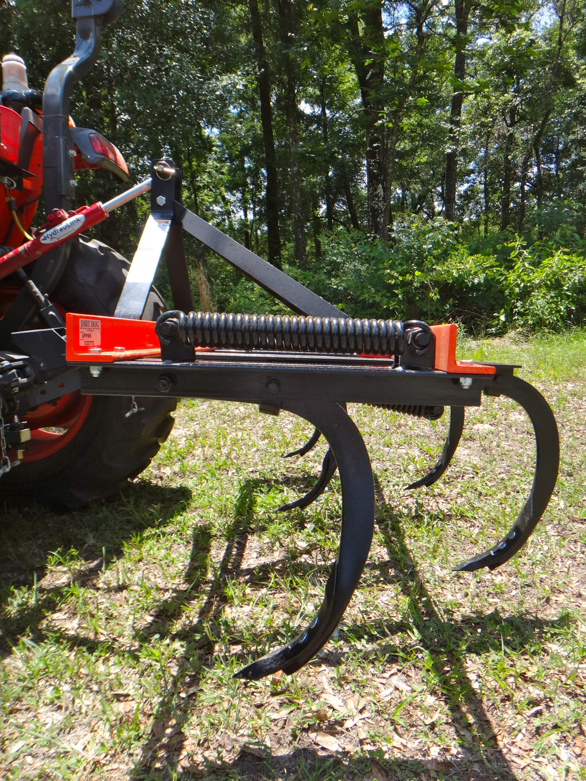

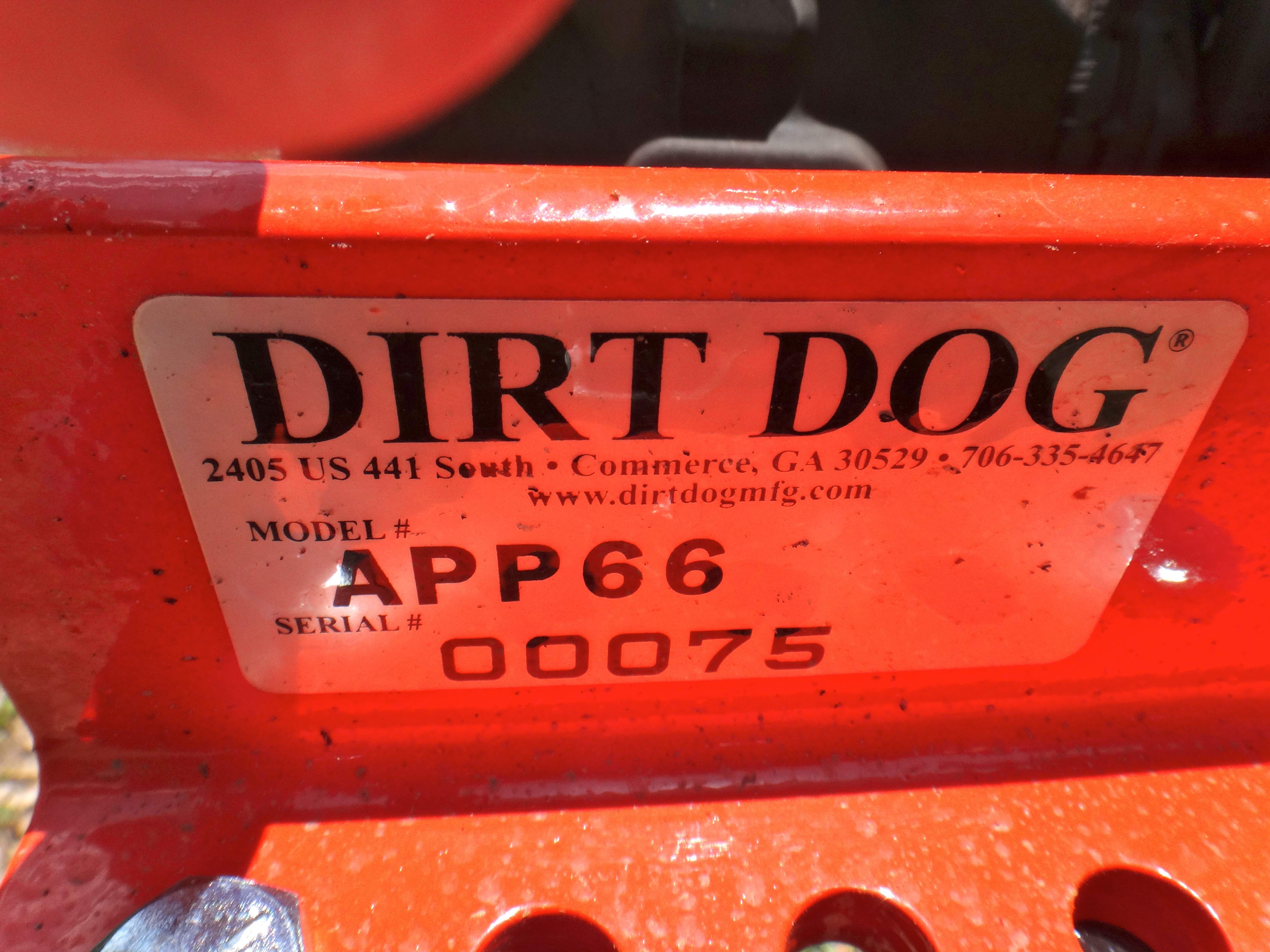

I recently took delivery of a 66" Dirt Dog Field Cultivator. I am researching cultivator Sweeps to occasionally substitute for standard 2" X 10" Chisel Points on five 1/2" width tines. I want to use the Field Cultivator with sweeps, probably 5 X 10", for 2" secondary tillage food plot preparation.
Note 1" tine spacing holes. Photo #2
Note Sweeps in Photo #7.
NICHOLS TILLAGE TOOLS LINK: Nichols Sweeps

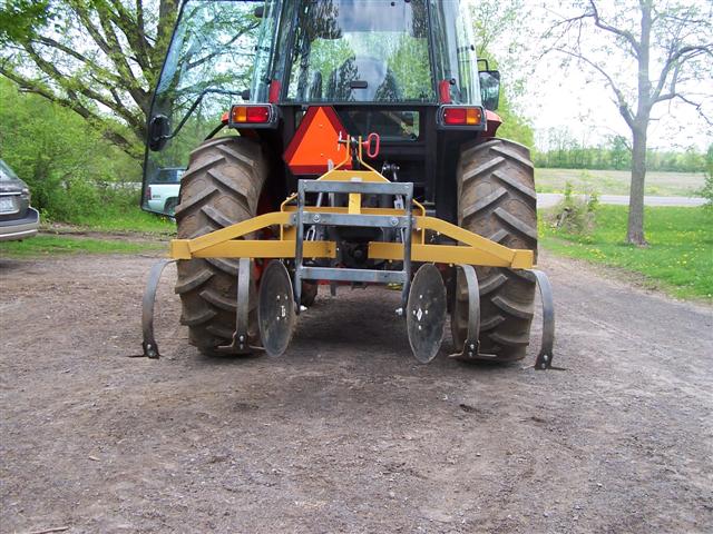

I purchased one from Tractor Supply;removed the center two and made a "hiller/cultivator".Works nicely.
The disc's are bolt on so removed easily to reinstall the center two cultivators.
I also added "peanut"shares on the ends.Great all around tool,can be used as a chisel plow also.
Note: I did reverse the disc after this picture was taken(they are backwards in the pic)

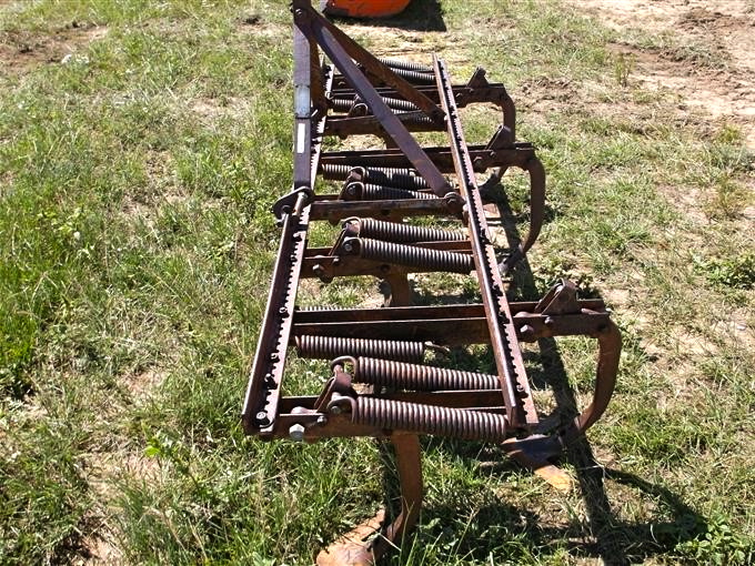

I have a old ferguson sko-20 my grandpa used on small crops , it was set up for two row with side dresser but I switched it around for a single row , works really nice.
