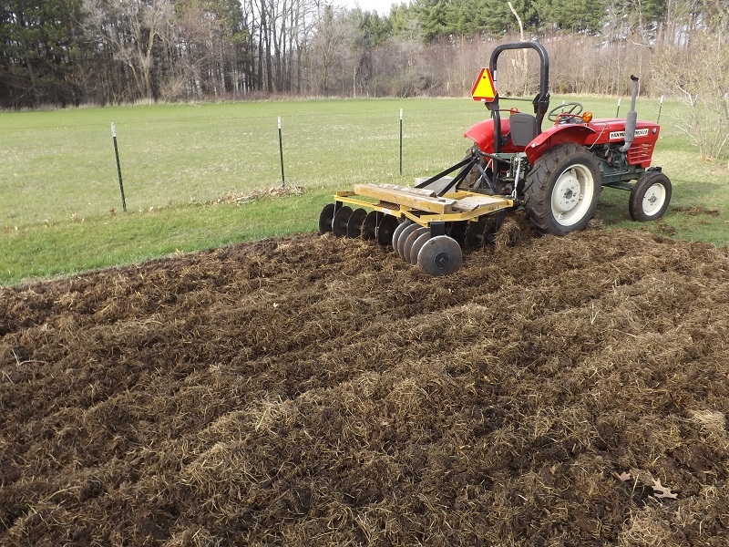

Maybe a disc harrow is the term you are looking for?

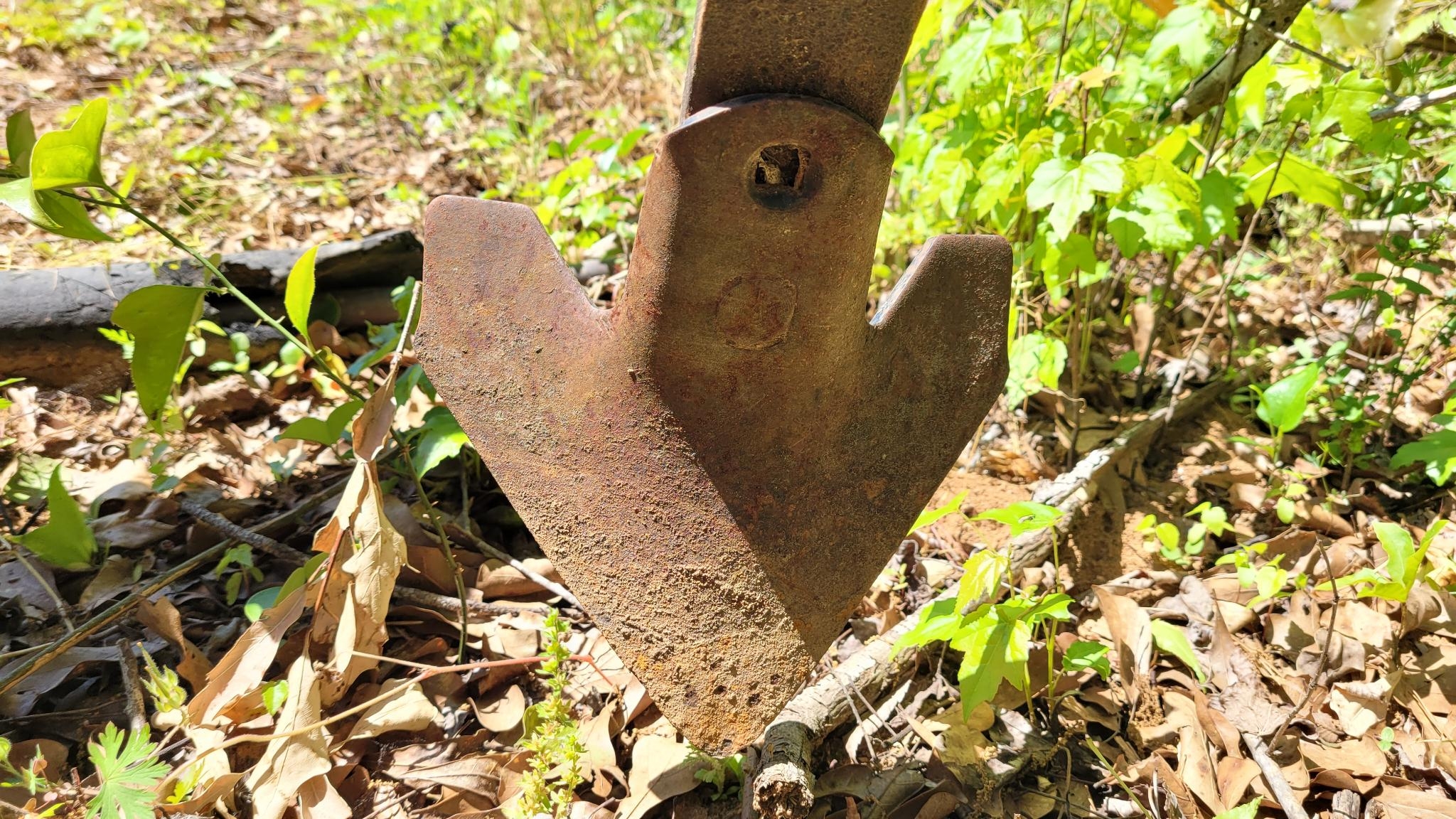

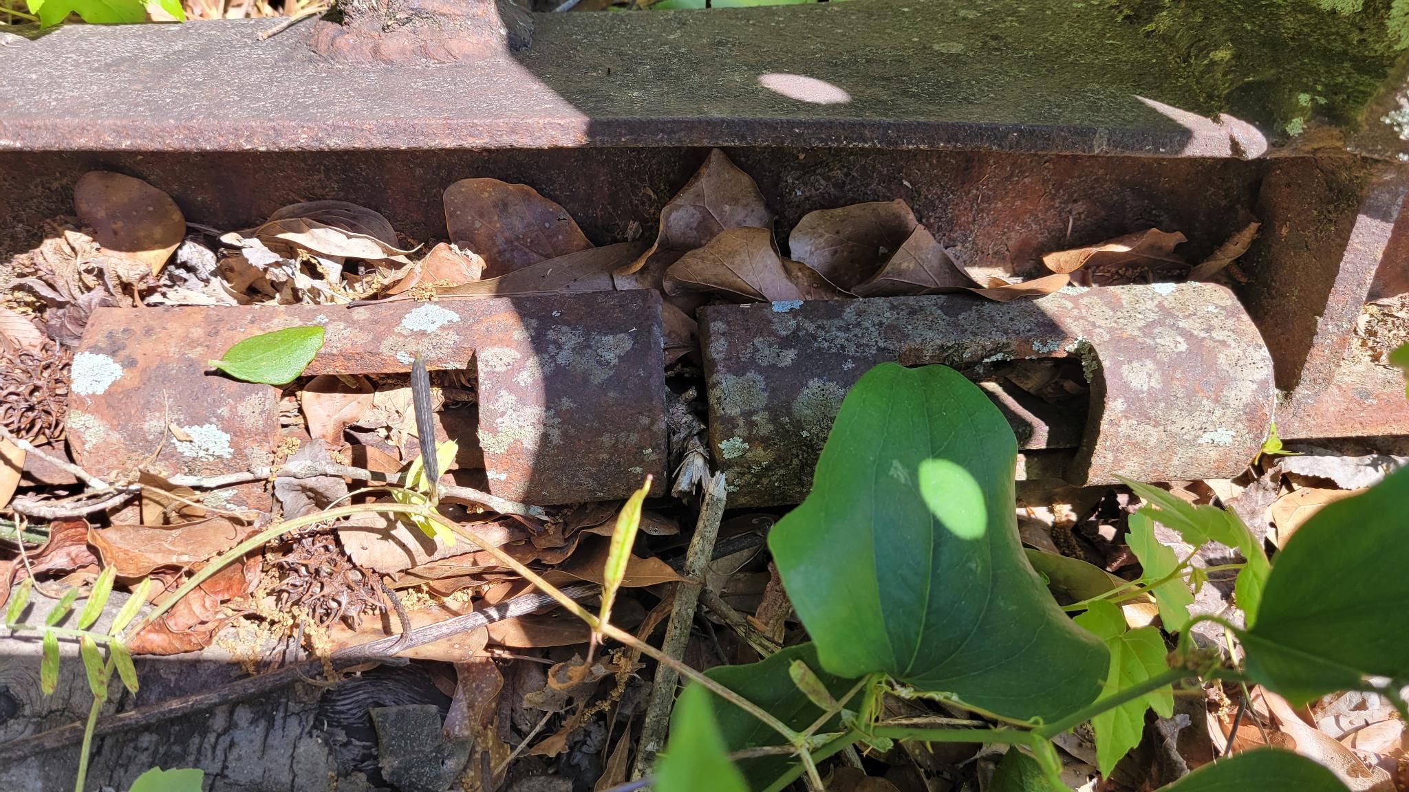

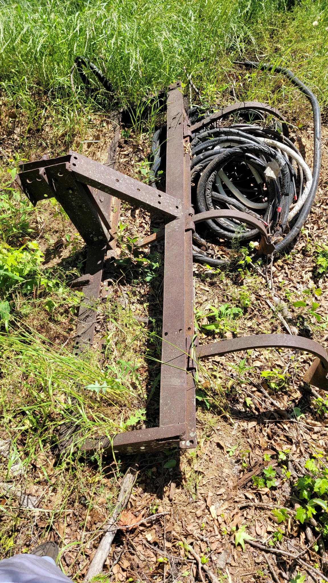

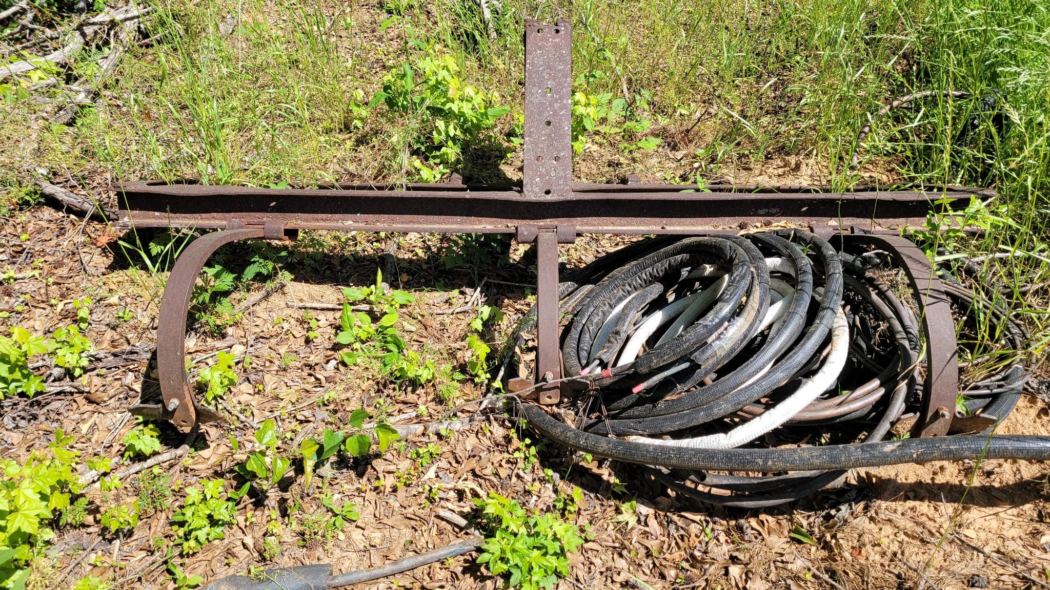

A little update.. found this -ON the property. lol. It has 3 existing shanks, with sweeps on them, and on the front I-beam, there are 3 more of the attachment "things" that the shanks would go in. It has a 3 point hitch on it, looks like cat 2. I can't move it, its heavy. I think I could definitely use this, and most of it is already done for me. My questions would be, how do I identify the shanks on the rear that are already there?? How would I measure them properly to make sure I was getting the same dimension shanks as those? What type of attachment system is this that the shanks slide into, what is it called? How can I tell what degree angle the sweeps are supposed to be? Pictures attached.
FWIW, do you have a PTO tiller? I use the plant a row, skip a row method and use my 60 inch tiller to keep the walkways clean. I use a Howse ridger(hipper/hillier) to build a raised bed and then knock the top flat with a 5 ft. Spike tooth narrow.
