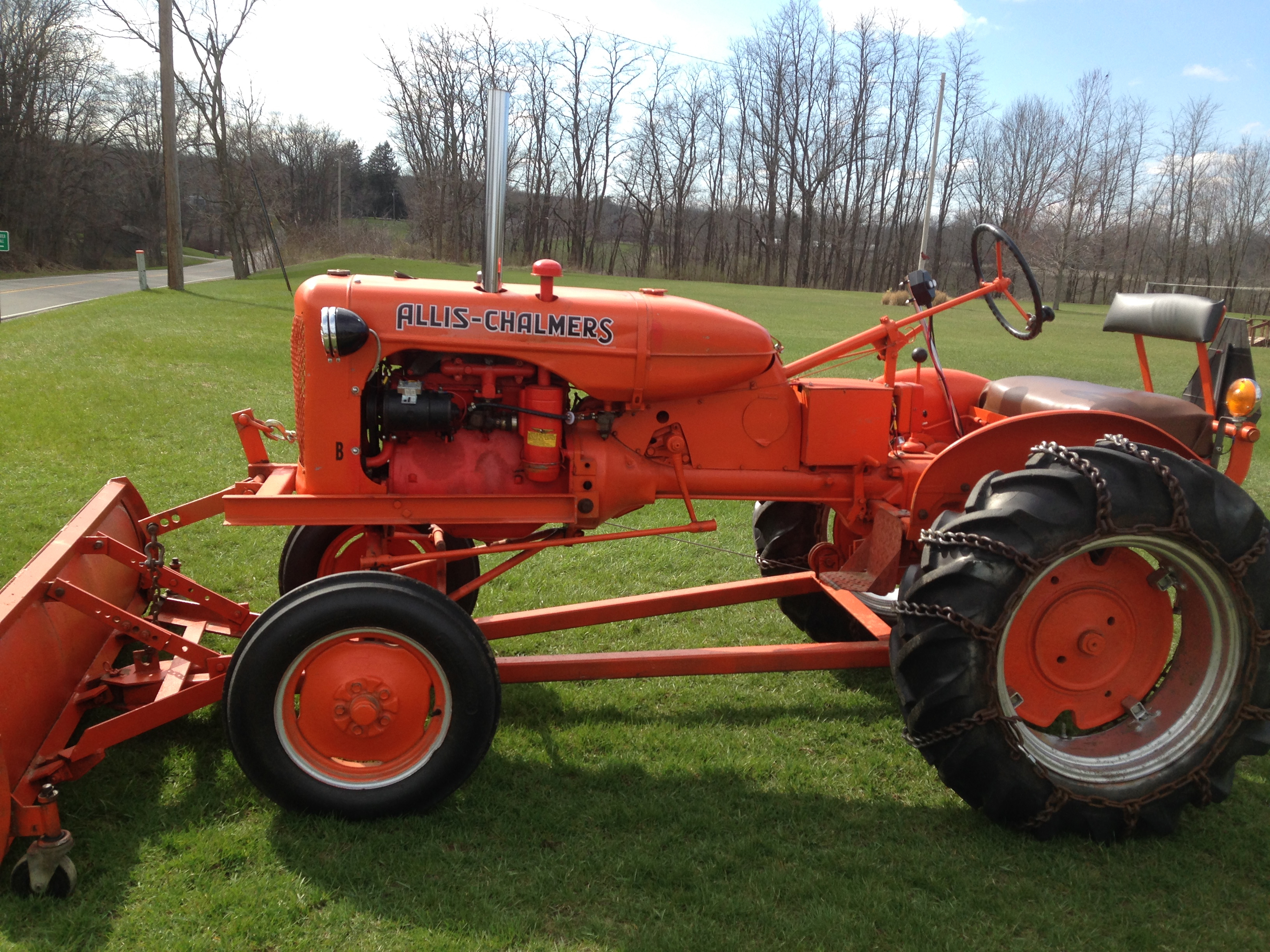

I am new here and new to tractors and homesteading in general but grew up with my dad doing it. Anyway, to the point, I just purchased a 1947 Allis-Chalmers B in great condition (pic attached) and we plan to first use it on about a half acre (or less) garden. What is the best implement to go with? It seems everyone has a different opinion (cultivator, disc or tiller) and I am having a hard time narrowing it down. My plan is/was to first buy this 3pt conversion hitch because I figure I would need it regardless, but I also see there are smaller disks for sale that I could just use a ball hitch on? Any/all advice welcomed. Other plans with the tractor are to use for snow plowing with the blade it came with, brush hogging about 4-5 acres regularly and some other misc stuff to keep up with our 7 acres.
Thanks!
~JB

Nice looking Allis, did you get any garden tools with it? If not might want to start looking for those.

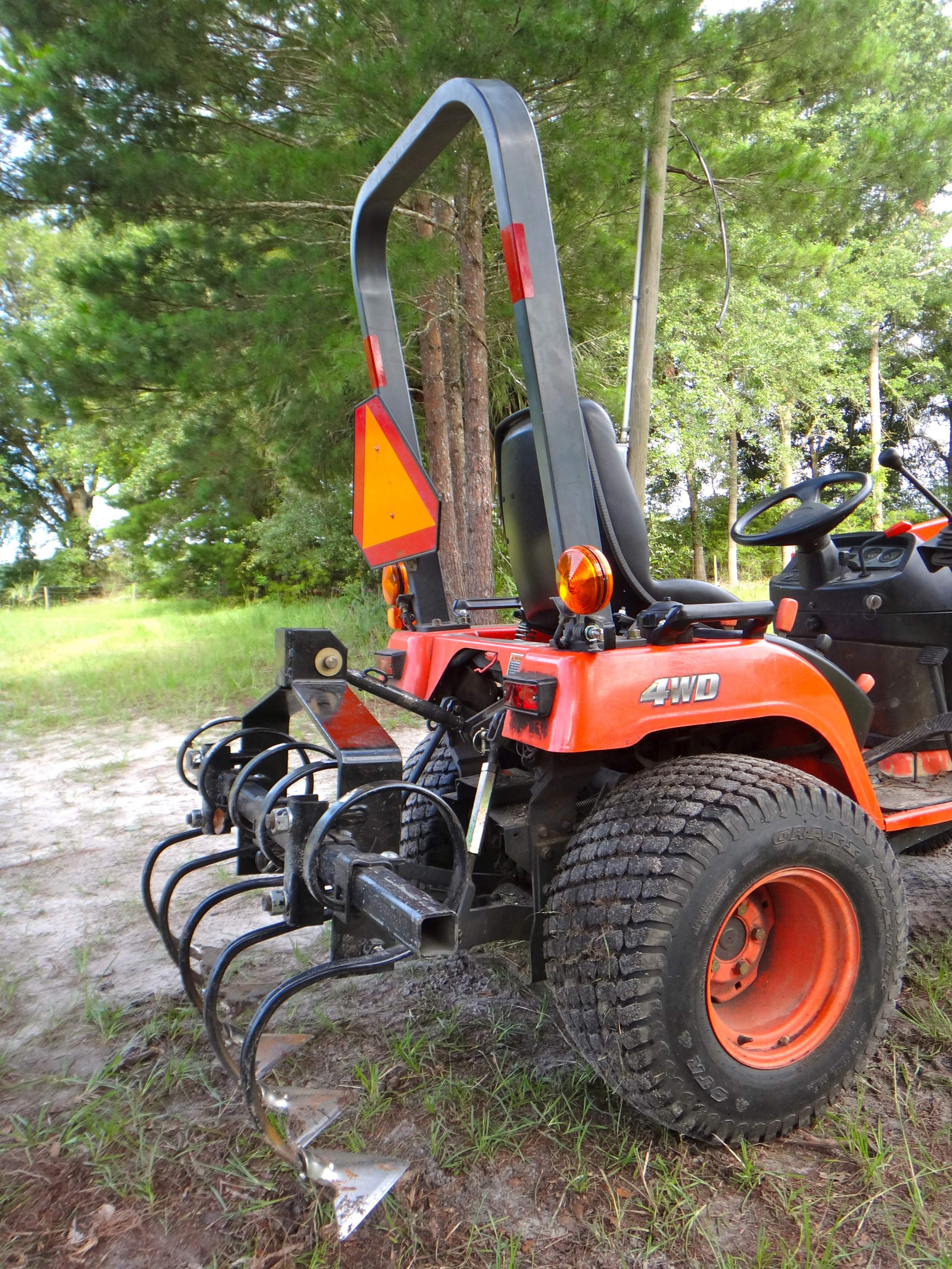

Here is a second Three Point Hitch conversion:
Complete Cat 1 3 point hitch

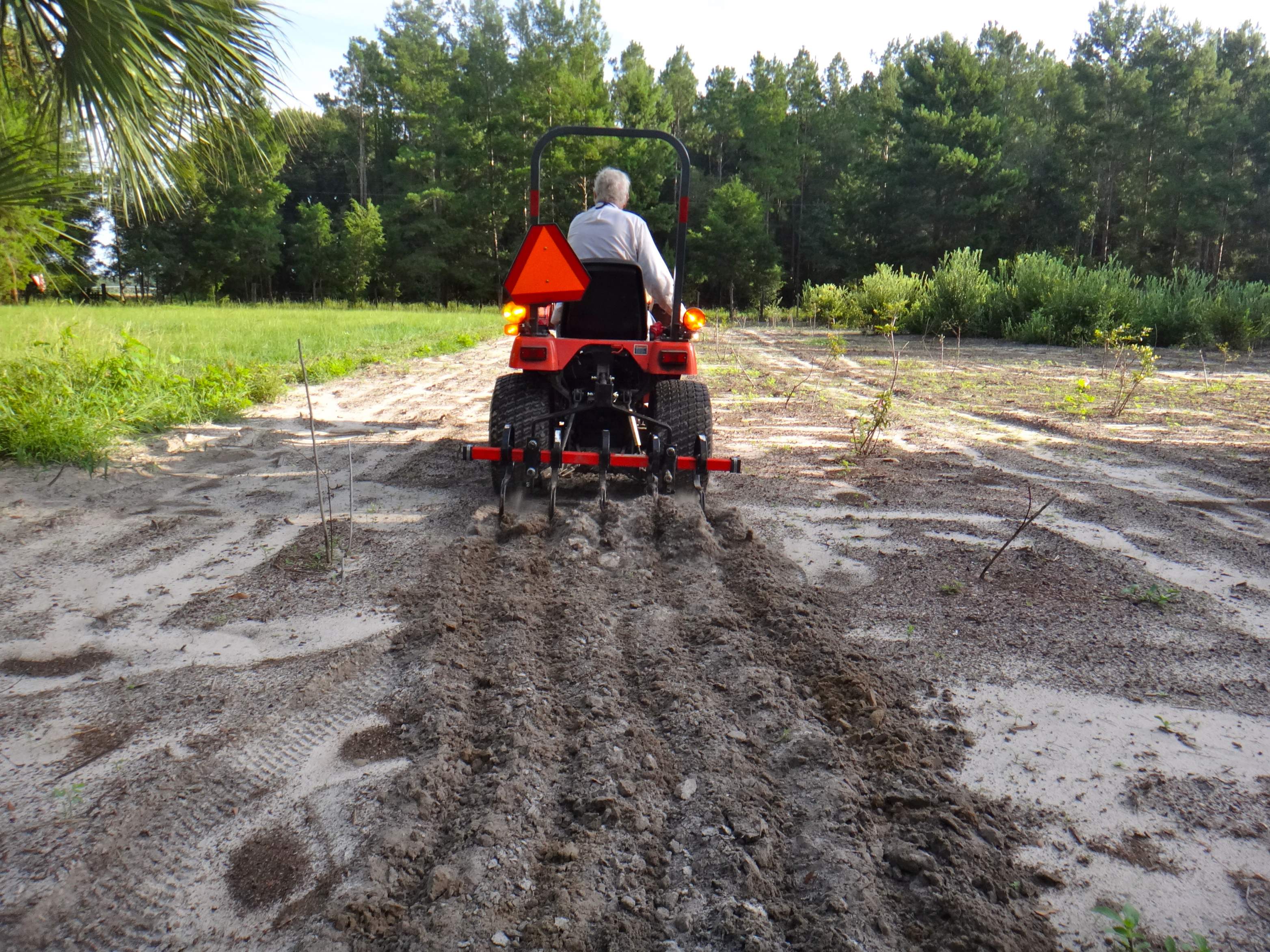

Roto-Tillers are the best ground contact implement for gardens, for contemporary tractors.
In addition, you may want some form of 3-Pt. Cultivator for weed control. If the ground has been recently worked it is possible you could use a Cultivator in lieu of a roto-tiller.
Just the front 76" plow ... My wife and I have been scouring the corners of the web for a good deal on a used sub compact and could't touch a rust bucket for less than 3K+ ... found this locally the day he put it up and bought for $1,500 from a older fellow that works on tractors and owns about 50 garden tractors that he has either restored or kept running ... I think it was a good deal?
/ cultivator, disc or tiller? #8
Judging by the photo.....a great buy.
Congratulations.
