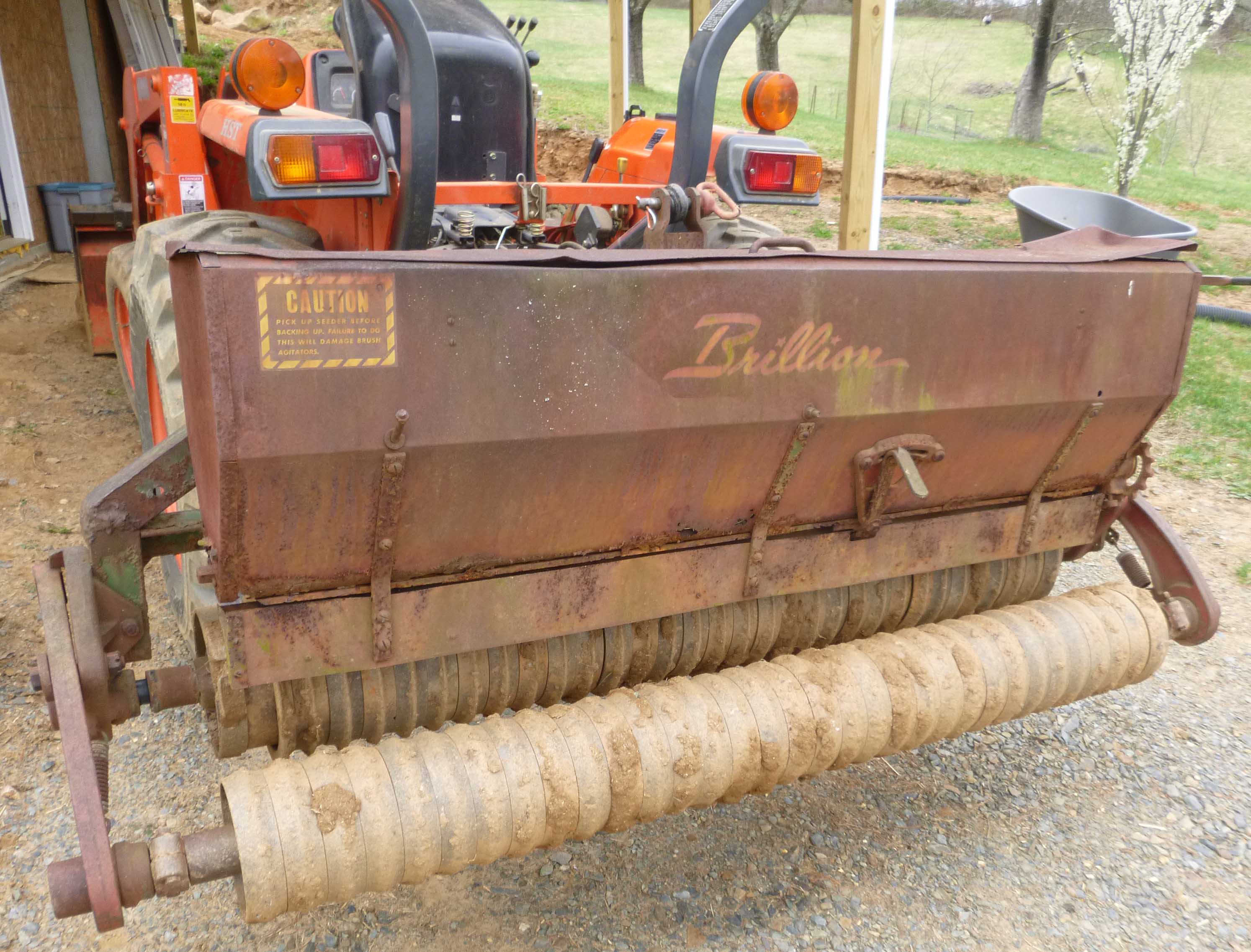

/ Cultipacker #4
Bought this one for $150...
/ Cultipacker
That thing is sweet! I need to see it in action. I thought about doing the culvert pipe thing with pillow blocks.

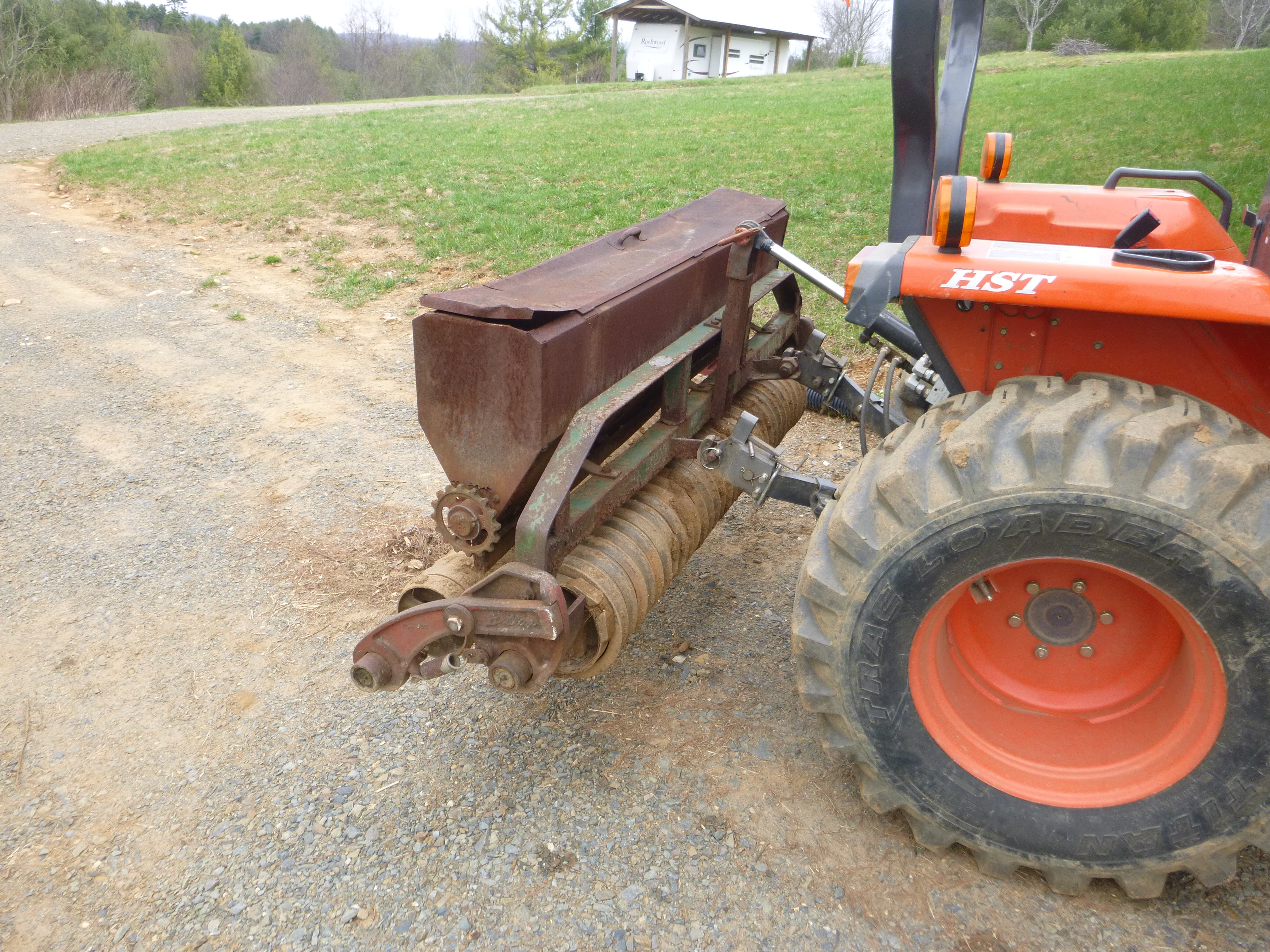

/ Cultipacker #10
Holy $h*T you done better than Billy the Kid and Frank n Jesse ! Awesome fined for your size tractor ! :thumbsup:
Talked to the old feller selling it for a while... he used it to put golf courses in down here in NC (I'm sure he got his money out of it!!!). He had plenty of stories about each course he built... He also had all sorts of cool "junk" that I would have love to played with... Yes, I was lucky on this Craig's list buy err... Steal!!!

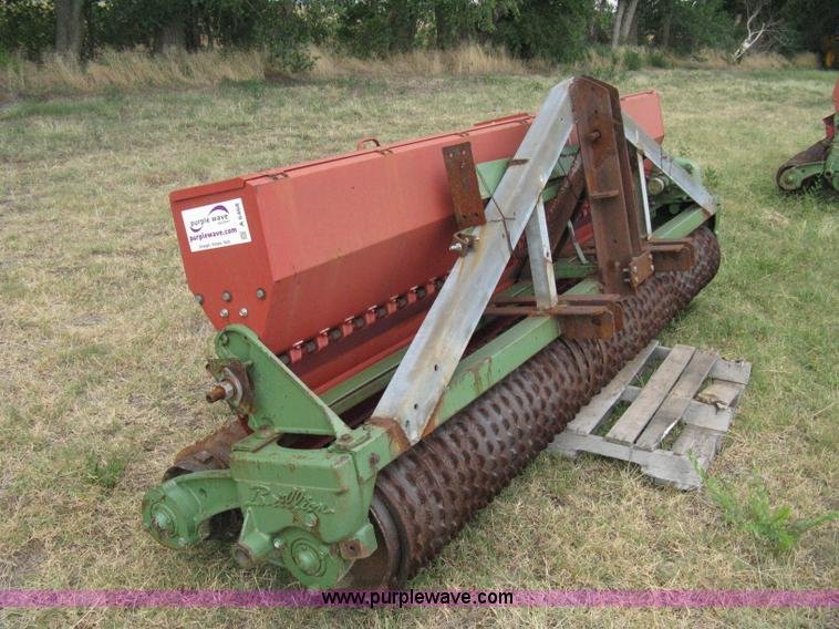

/ Cultipacker #17
I paid $150.00 for this one,
The "Crow Foot" (pictured above) cultipacker seem to be the best design...
