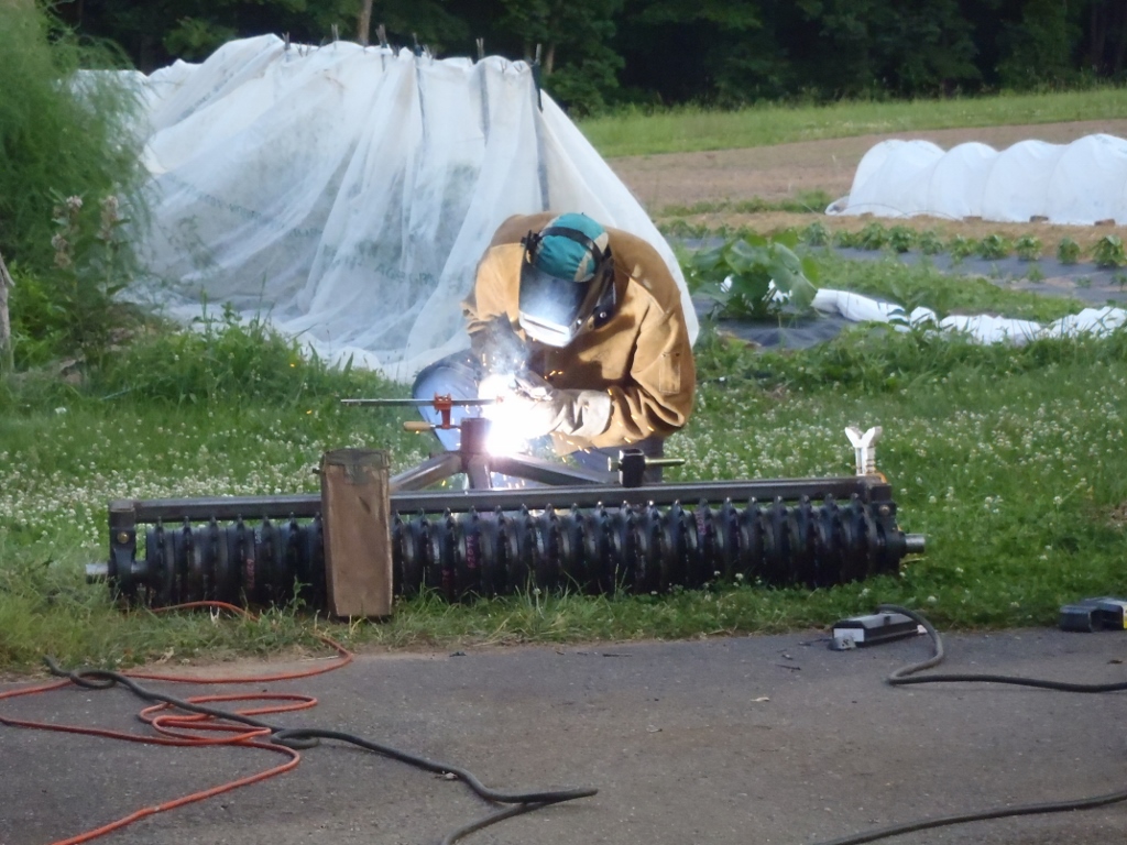

Have been working on this project on and off for several months. The Plant Manager wants to plant buckwheat in our fallow garden plots and supported my effort to get it done and out of the garage, where it's been taking up far too much space.
Welding main frame complete, axle, pillow block and wheel assembly installed.

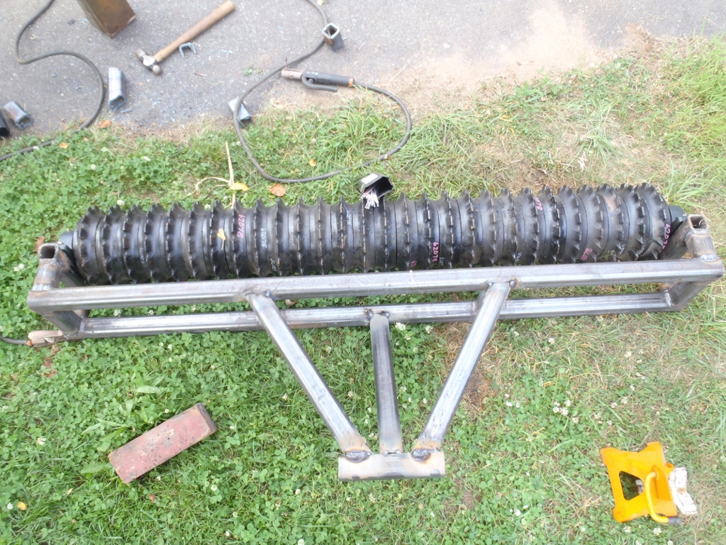

Fit up of the hitch structure commences:
Welding the hitch structure commences:

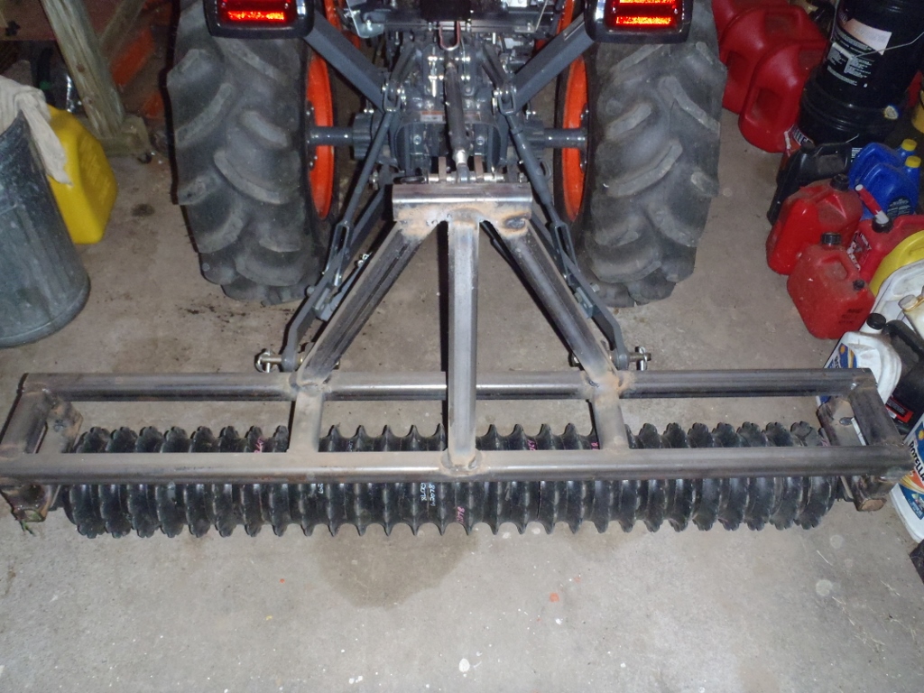

Assembled and inspected:

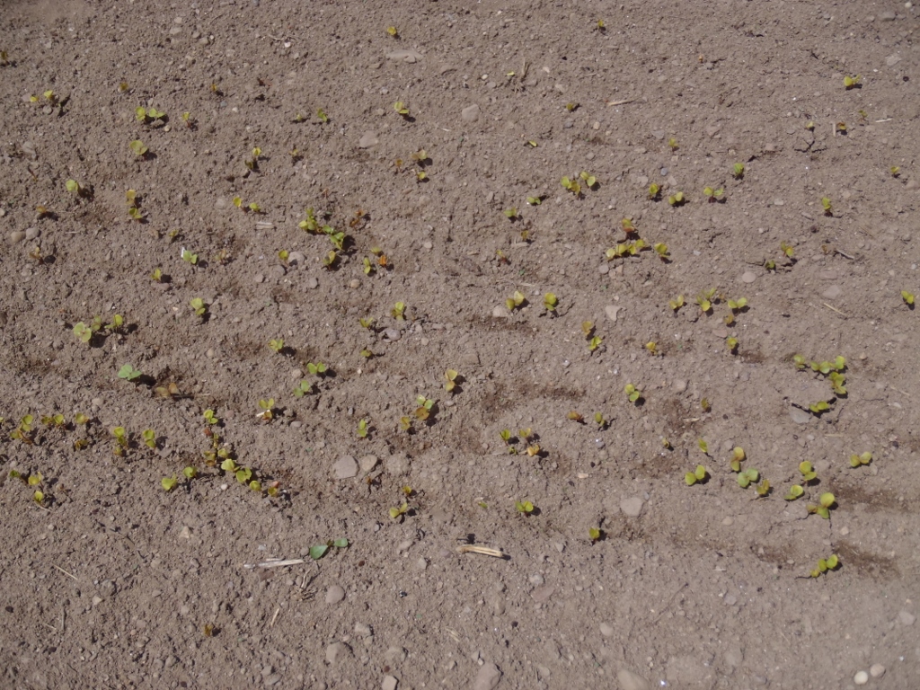

Buckwheat's doing well.
I was expecting about 150 to 200lbs/ft to get a firm compaction. I use light plastic water filled rollers that are 120lbs/ft and have a new build for a steel and concrete roller that is 375lbs/ft.
Wow - that's heavy! I did notice the germination started in the tire tracks, first, then where the packer had pressed the seed, the anywhere the packer had missed.
The soil here has a high clay content, so I'm going to try using just enough pressure to get the desired germination.
Apparently it works alright in it's present configuration ...
I estimate mine weighs 420", as-is, and is 64" outside wheel to outside wheel - so nearly 80lbs/ft.
I packed a day (a very hot day) after tiling and the top layer of soil was very dry and wouldn't hold together much.
Next time I use it I will make a point of packing right after tilling, while the top layer of soil's still moist.

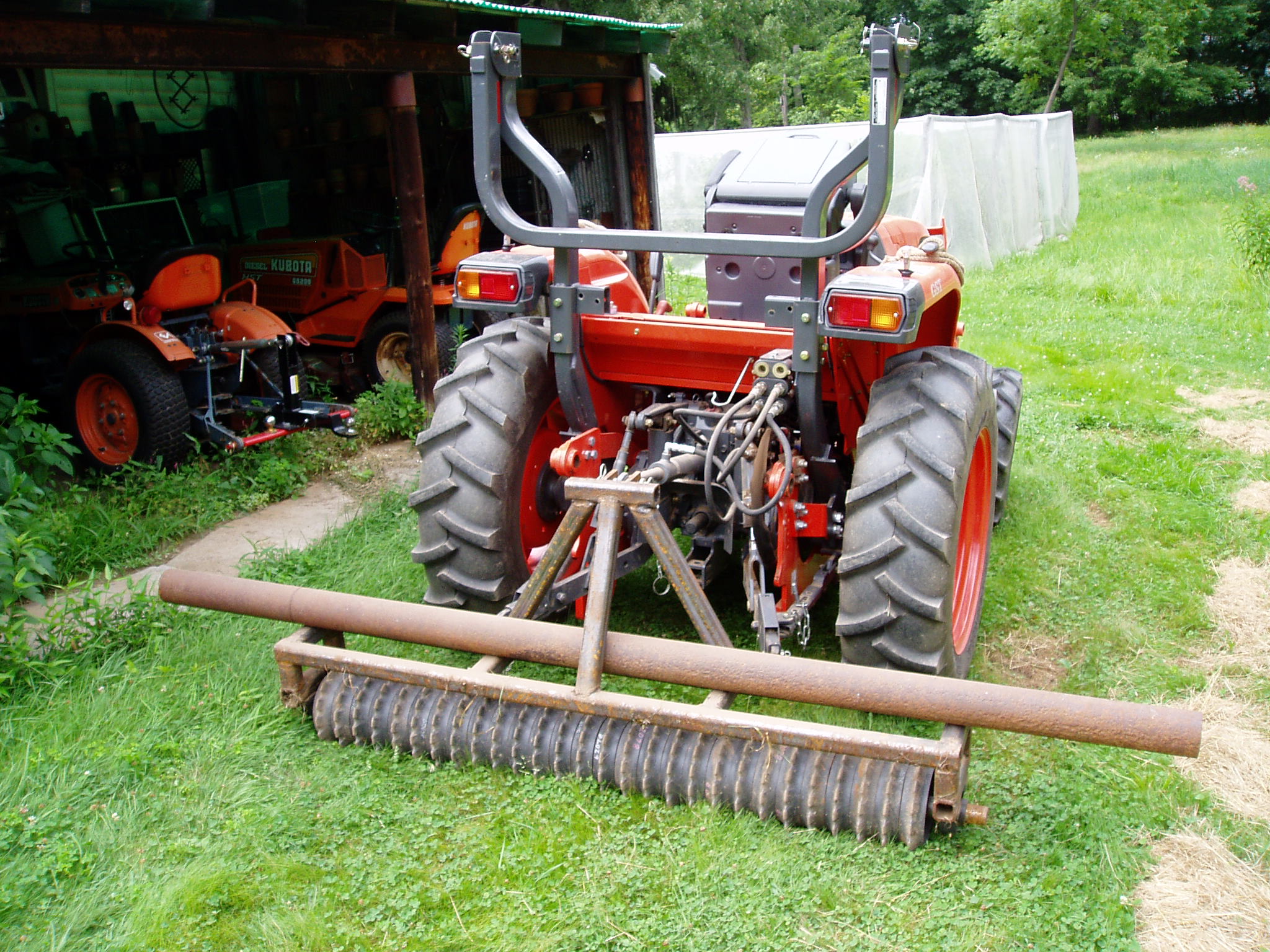

I tried adding an 8 foot, 4" Lally column for an additional 100 to 110 pounds:
This seemed to help when I planted tillage radish in our little North field:
The column got the weight up to 420# + 105# = 525#, or about 100#/ft.
I'd still like to squash the soil down to the tire marks:
Next, I'm going to try laying 2 30 gal ballast tanks on their sides, one on each end, and fill them with water.
This should get me up to about 420# + 480 = 900#, or about 170#/ft.
