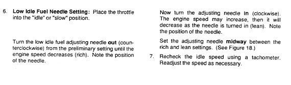

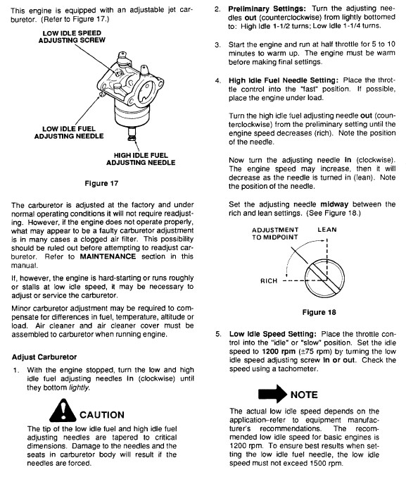

Maybe running a bit too lean. reset the carb.
