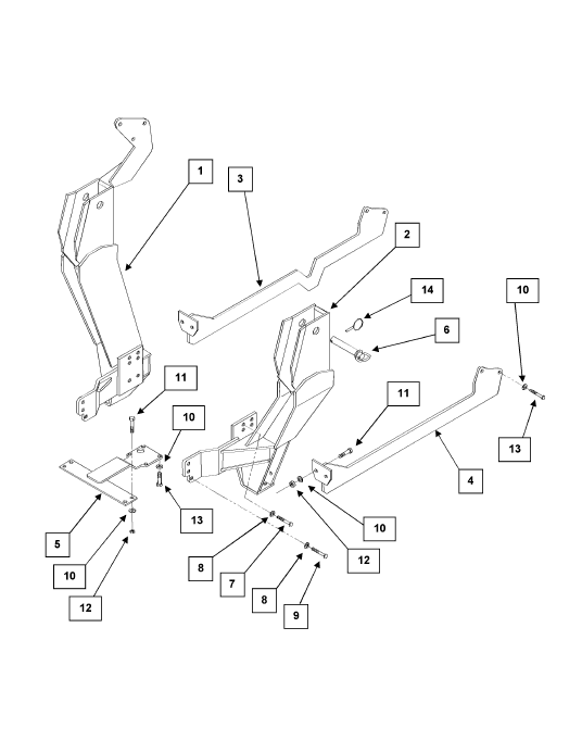

Hopefully this diagram of the Cub Cadet 640 loader I have,will make this post less confusing and more interesting.I can post pictures of the frame of the tractor and of the loader this weekend. Cub Cadet 640 Loader 1.gif

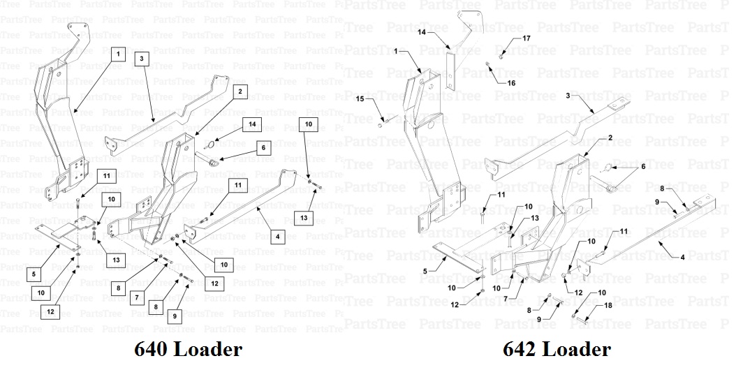

Welcome to the more is better club. Congratulations, that is a good looking tractor.
Here are Partstree side by side parts drawings 640/642 loader mounts

I just measured my DK 35 and the frame width is 11 5/8" wide including the weld on mount plates (didn't measure those, mine are probably 1/2" or so vs 7/8")
   / Cub Cadet 8454 Buy It?
#37
Thanks for more info airbiscuit and to DK35vince for measuring the Kioti DK35 frame.It sounds like you measured the same place I did,just behind the front axle on the frame.So the CC8454 (DK45) frame is 13-3/4" including the weld on plates for the loader,and the DK35's frame is 11-5/8" including the weld on plates for the loader?It is looking like at least the front part of the mounts for the loader are not the same for CC8354 (Kioti DK35) and CC8454 (Kioti DK45).Looking at the diagram that airbiscuit posted seems to show this.
The rear part of the mounts that bolt to the frame look like they could be the same for both tractors,I hope.That would give me a place to start to mount them before I would have to modify.

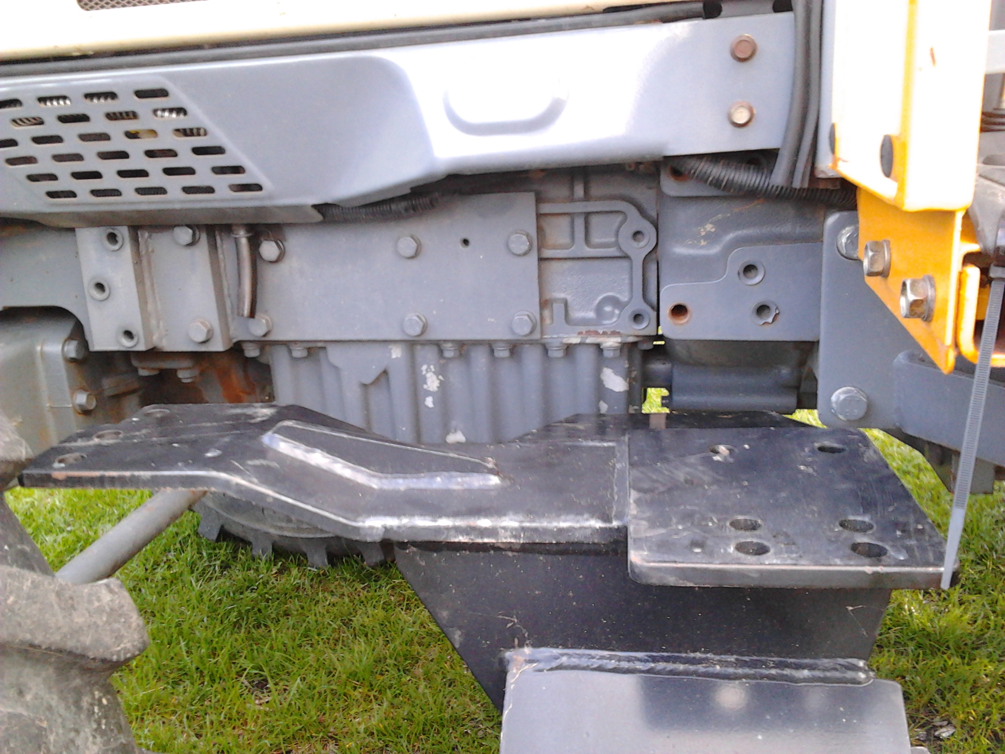

I started in on the loader install,weather here has been lousy this spring.I had time for more research between the CC8354 and CC8454 and have been lucky so far.The loader side mount's rear holes do line up with CC8454 even though mount is made for the CC8354.I am thinking both the CC8354 and CC8454 use the same rear plate that is attached to the engine where these holes are,and because the loader mount cross member I have,for the CC8354,would fit between the two side mounts on my CC8454.So the width of this rear plate of the engine also is the same for the CC8354 and CC8454.Here is a diagram of the CC8354 showing the rear plate attached to the engine,with the holes for loader mount.CC8354FrameDia.JPG
Here is a pic of how the rear holes of the side mounts do line up on my CC8454,but the front part of my side loader mount for the CC8354,is not long enough to reach the front holes on the frame.CC8454MidLoader1.jpg

Thanks for your reply airbuscuit.so far it looks like I just have to refab the front part of the mid loader mount in the picture.There is an offset on the mount between the rear and the front part of the mount that bolts to the frame.I will have to measure the offset between the rear and front part of the frame.That will help to figure what thickness of steel and where to add on the front part of mount.(It does not mount like some tractors that have a frame that you can just bolt a long plate of steel because the frame is flat on the sides).It looks like I will be using 3/8" steel thickness.The side mounts weigh allot on this loader,probably 100 pounds.Not easy to try and get them into position,would be easy for the Hulk or Big John.
Other than that I will find out if my CC640 loader is long enough in the front not to hit the front of the CC8454 tractor when raising or lowering.So far it is too close for me to tell,I will have to keep my fingers crossed when I first use it.
