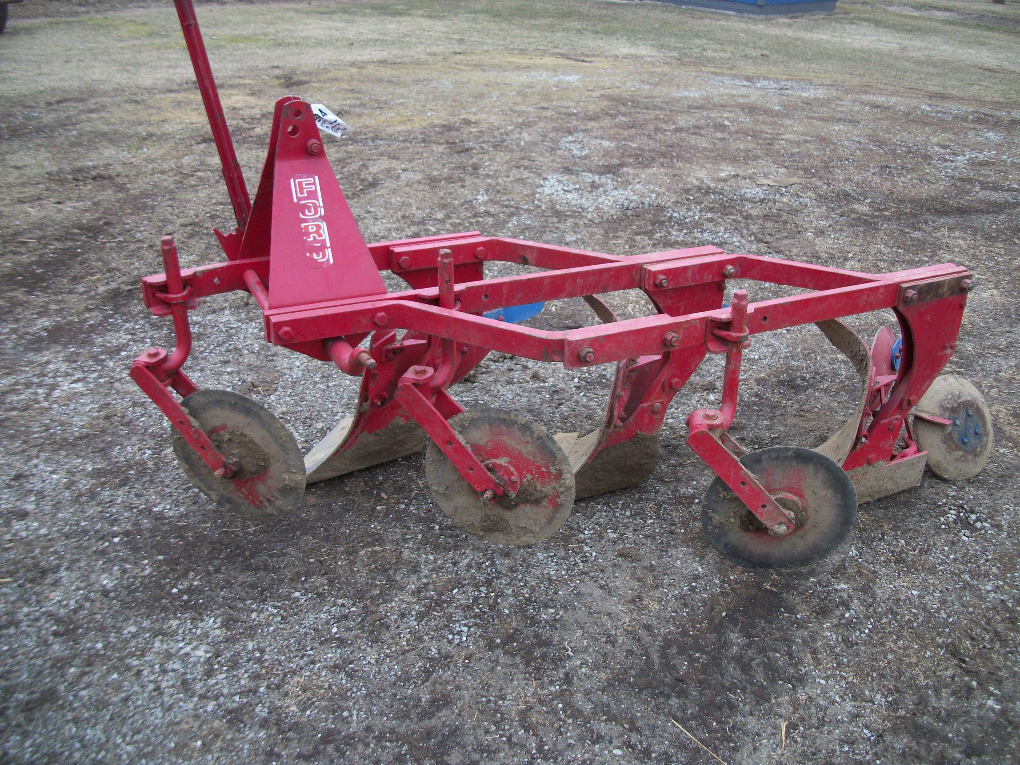

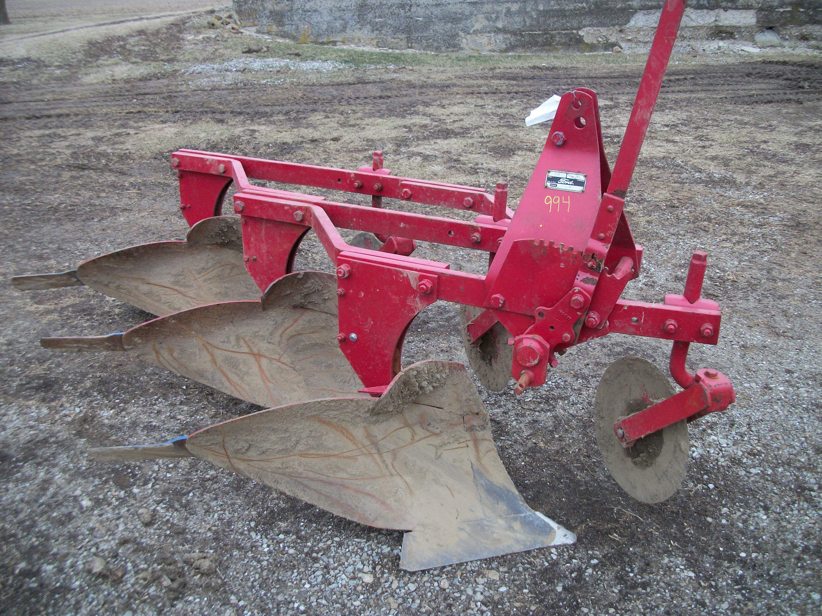

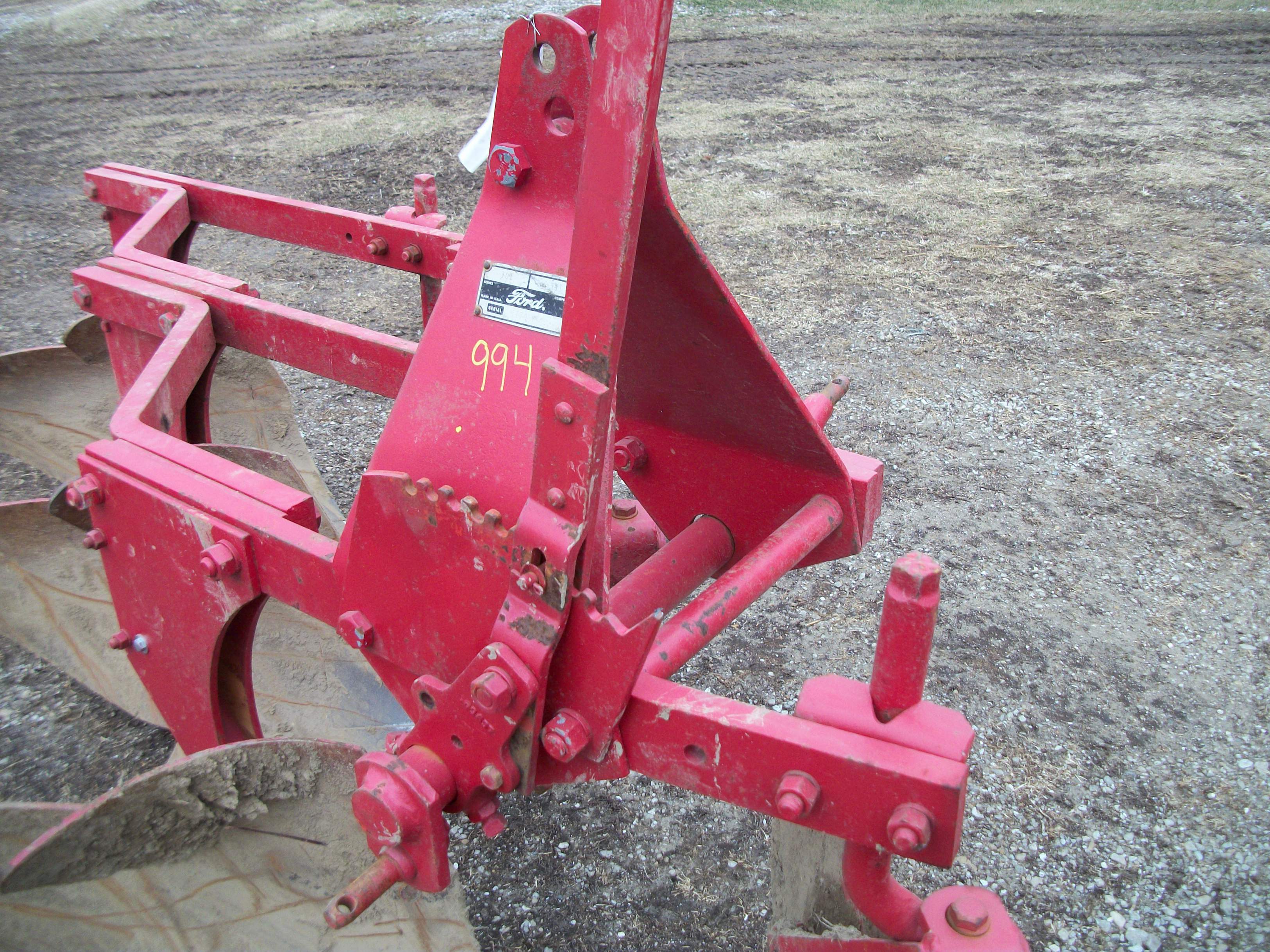

Anyone using a 3 bottom plow with their CT230? I picked up a real nice Ford 3 bottom at an auction a few weeks ago and I am dying to try it out. Unfortunately, it is still too wet and still a little frozen underneath I think. I should add that I beleive it is a 3-14 if I measured correctly.
I feel pretty confident that I can pull a two bottom but three bottom I am not sure. The third bottom is easy enough to take off but I would like to try it first.

Thanks guys. I do have the r4's on mine because I also mow with it and they do a nice job of not tearing up the yard.
I gave it a try last night even though it was still a little wet outside. I was able to pull it until I hit a really wet spot, then it just stopped me and I spun out. Our soil has a little bit of a sandy/rocky mix to it and the place I was plowing had been tilled about 2" last year. I did not measure the depth but it looked like a good 8-9" deep on the pass I made before I got stuck. I have not done any setup on it since i bought it.
That being said, I will probably pull the third bottom off in case I need to plow some ground with a harder soil. I have some guys that are going to put food plots in for deer and quail this year so I am not sure what we will be plowing.
The plow sits really tight up towards the back of my tractor, too close. It hits on my 3pt arms. I was hoping to use it with my quick hitch but the lever on the right hand side that adjusts the tilt of the plow interferes with the QH. I am going to try to figure out a way to make it work with the QH but not sure exactly how yet. I hate having to try to hook something up after using the QH.

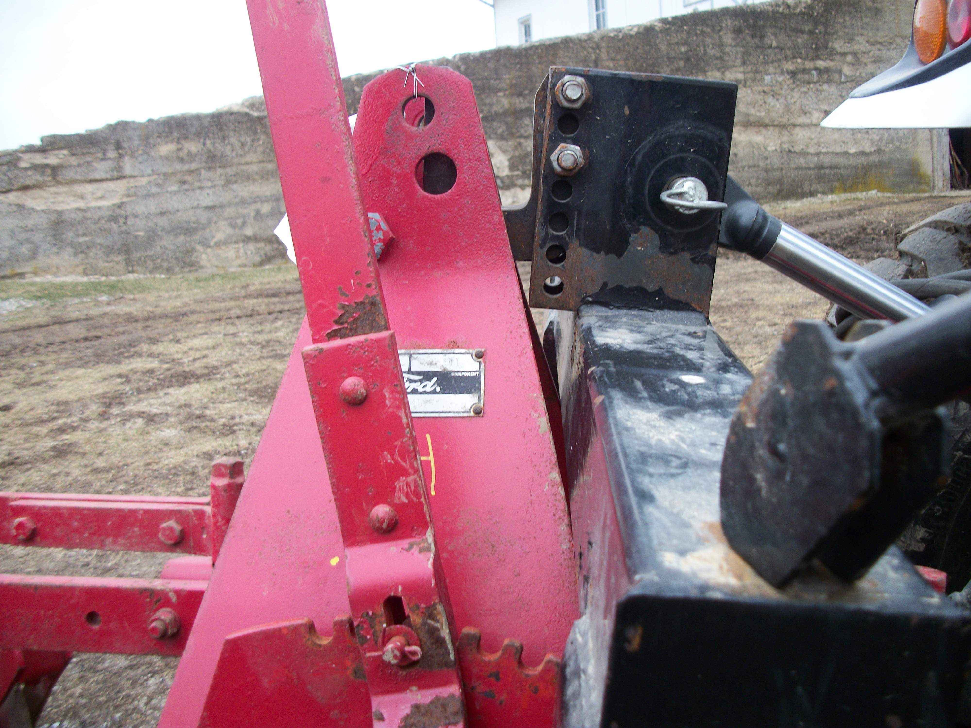

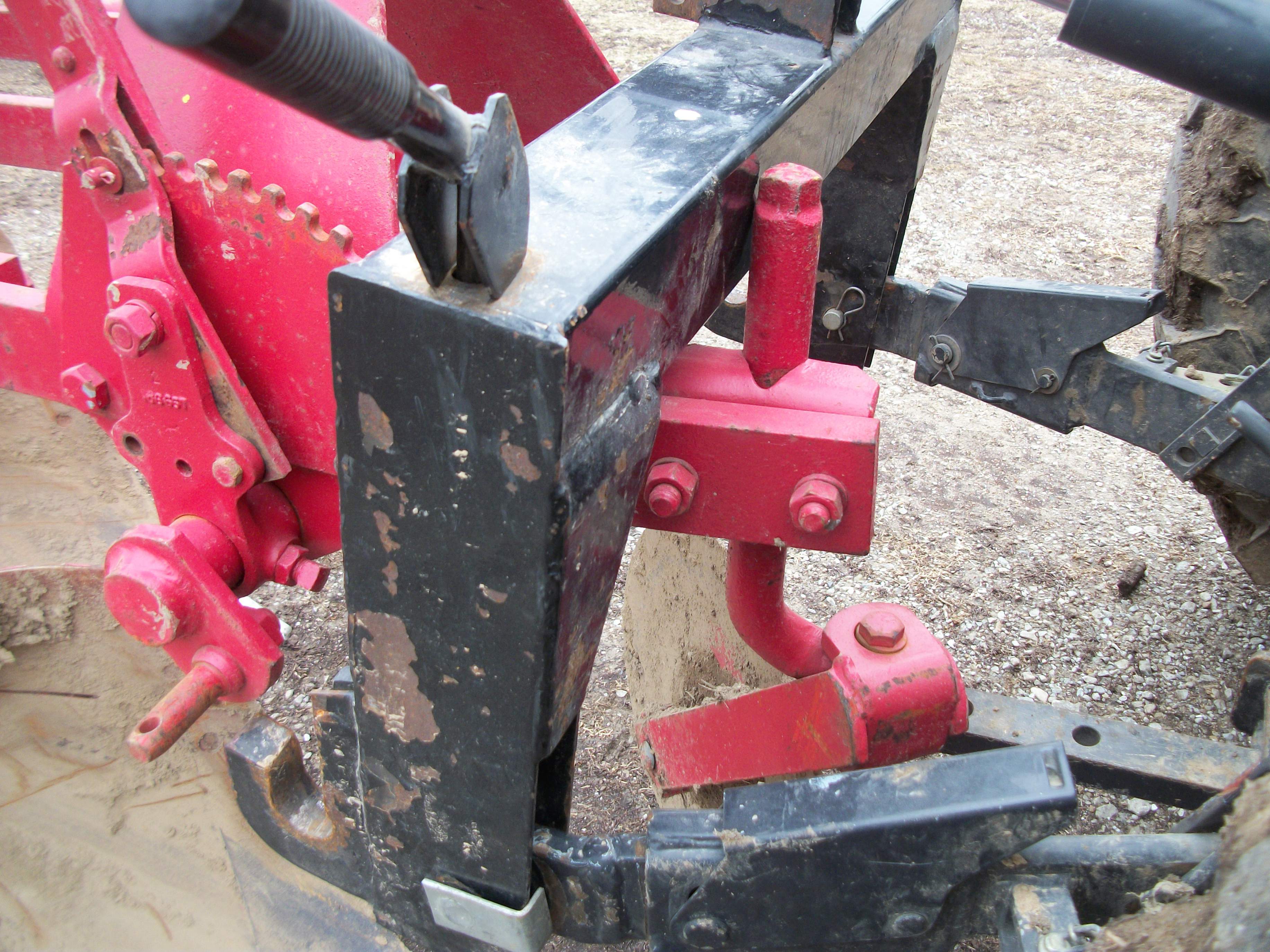

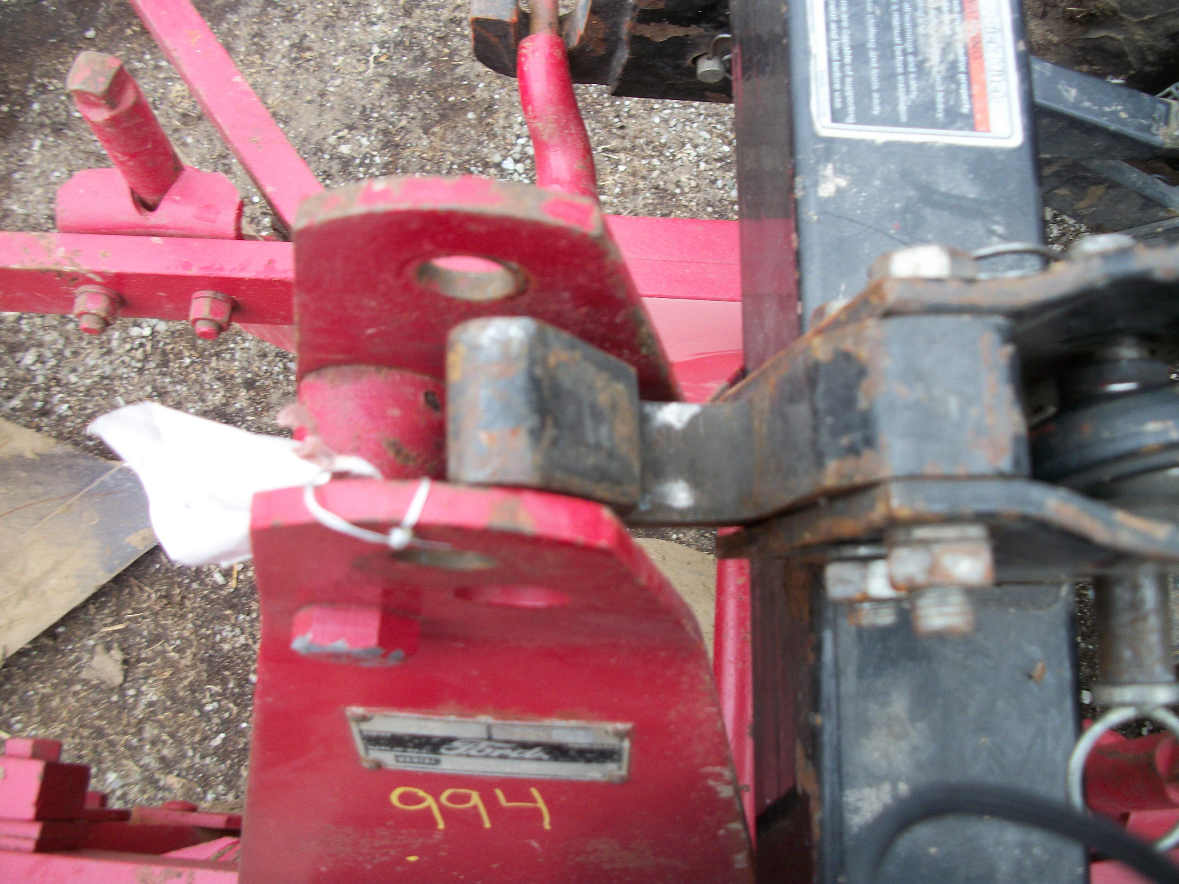

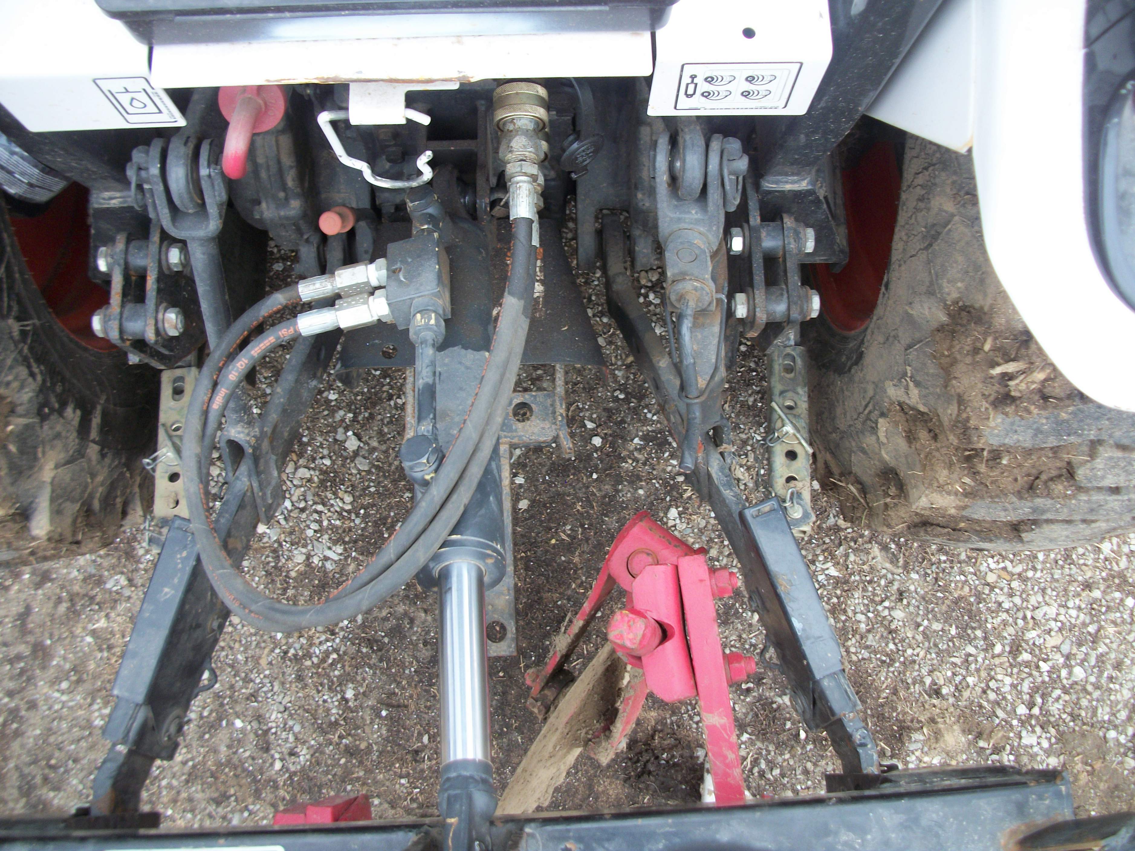

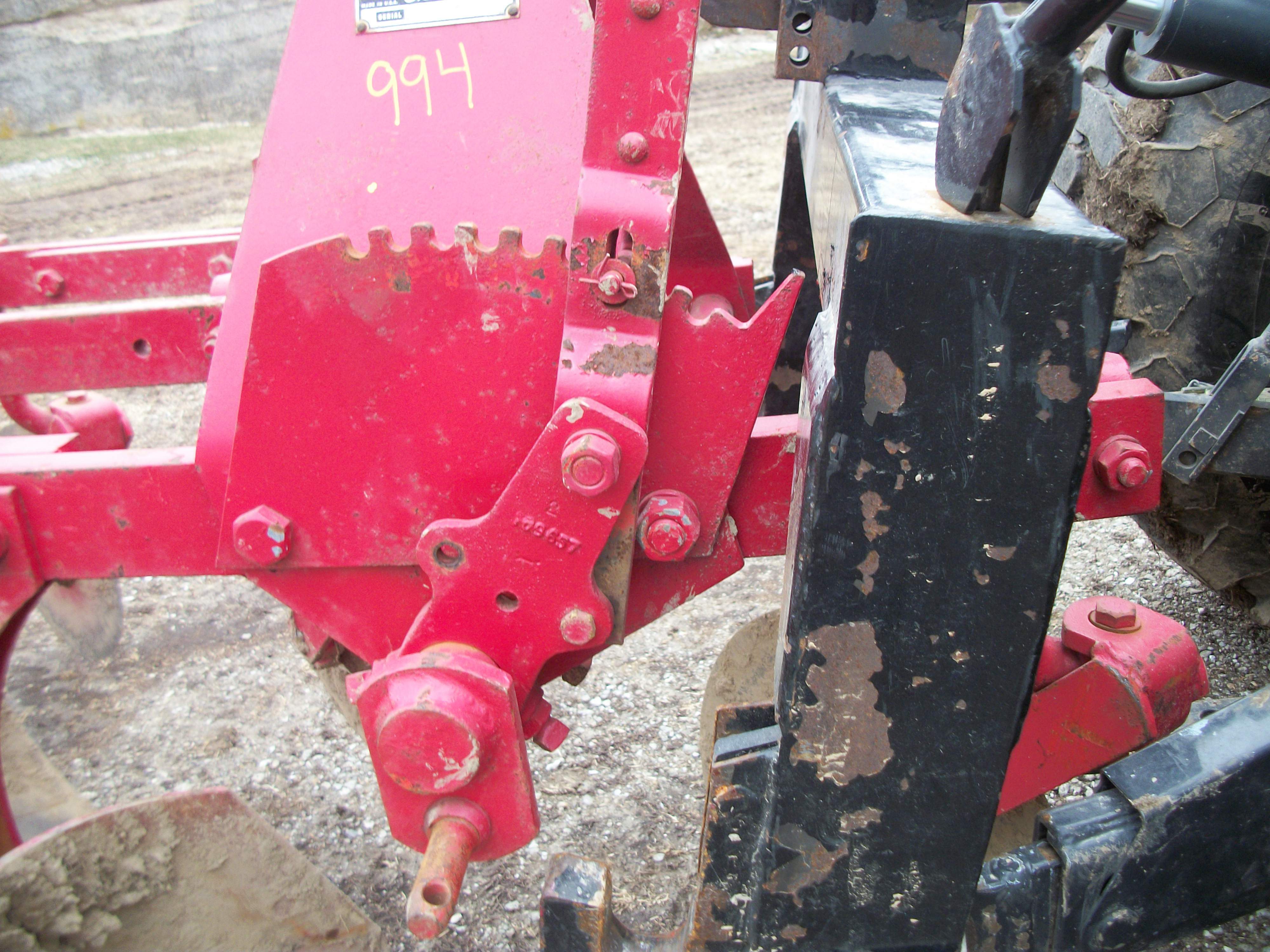

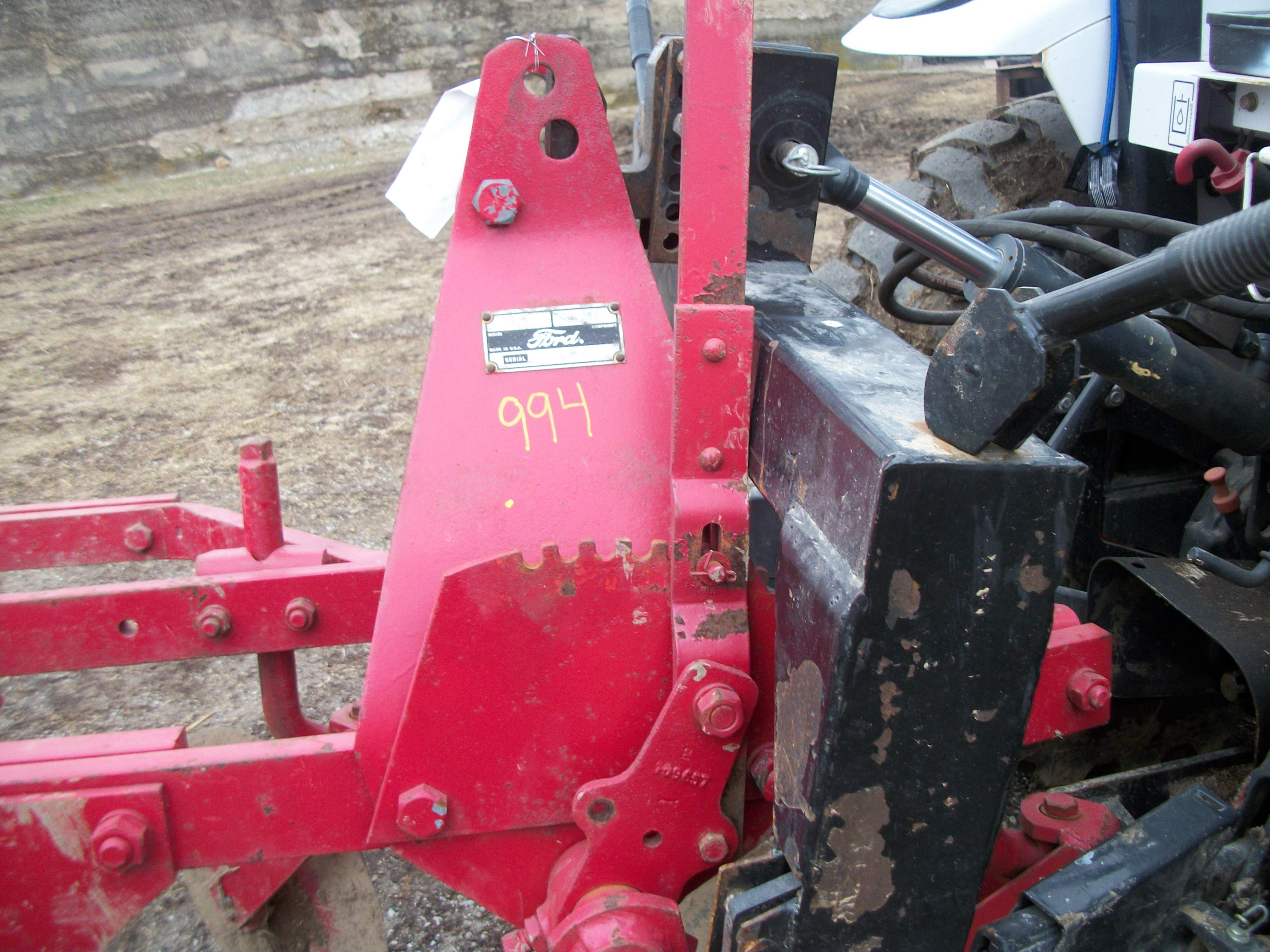

Here are some pics.
The tall tooth is in the way
As you can see, I have to get the QH up over the shaft on the first cutting wheel and then lower it.
The QH interferes with the adjustment lever which by the way I have to twist around to get each lower pin in the QH anyway.
Frame hits the QC so it is short of the top link pen.
Front wheel is very close to the tractor with the QH, even closer without it.
As you can see I have a few things causing issues, the cutting wheel up front, the tall tooth on the lever and the A frame for the top link. I am not sure if all plows are made like this but you may experience the issues.
Any ideas on how to make this work with the QH? I really hate taking it off.

If I had a QH like yours I wouldn't be able to hook up my plow. All the adjustments for my plow have to be done with the top link and the adjustable right draw arm.

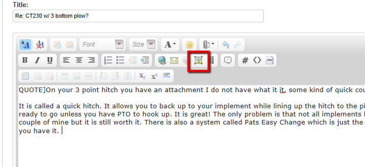

As far as attaching a pic, it is pretty simple. Just click on the symbol shown below, browse to the file on your computer and then hit "upload"

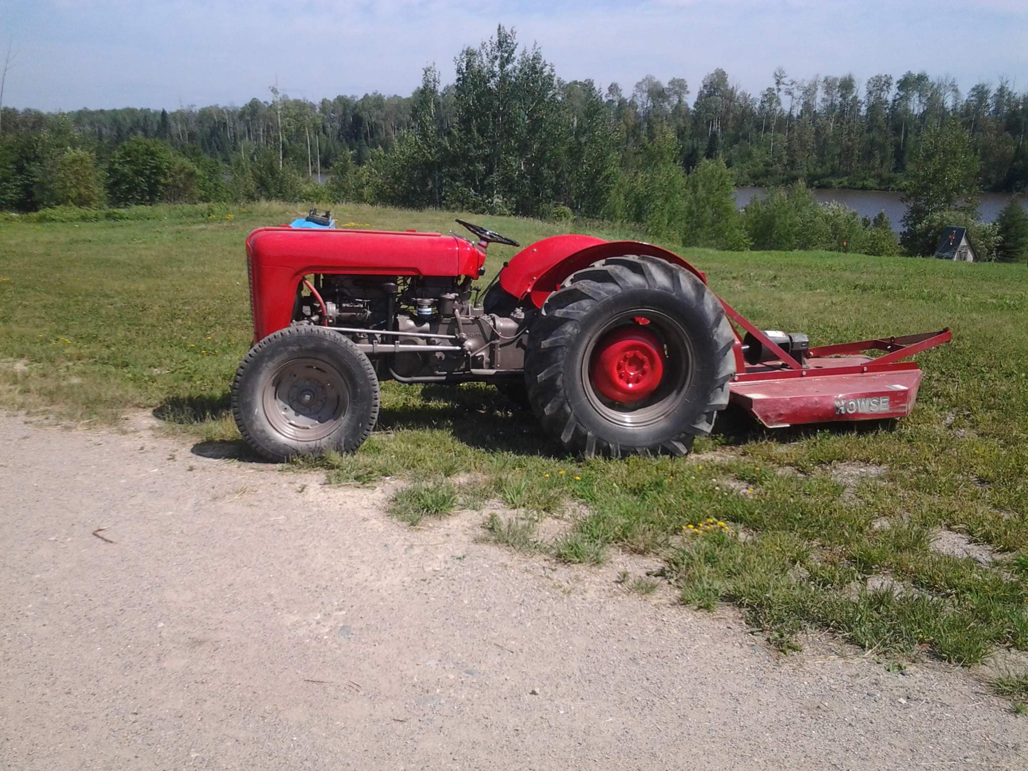

I like this pats easy change I will probable get me a set this summer. Oh by the way I tried to attach a picture of my old massey, I dont know if i should have posted in a Bob cat area, but.... funny thing is I dont even have a picture of my Bob Cat, well not yet any way. I will take a picture this afternoon when I am show blowing.
I dont see this pictures, so maybe I have to post this in order to see the picutre, my first try at posting a picture let's see what happens.

First of all - that's a pretty tractor. Nice and clean.
