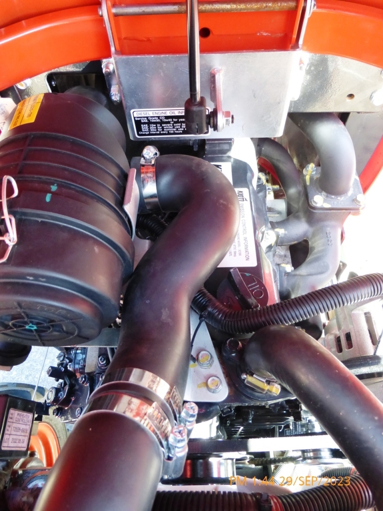

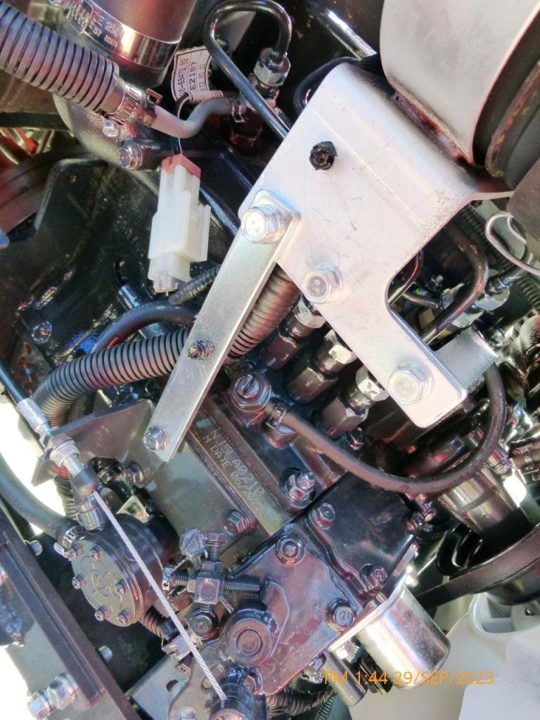

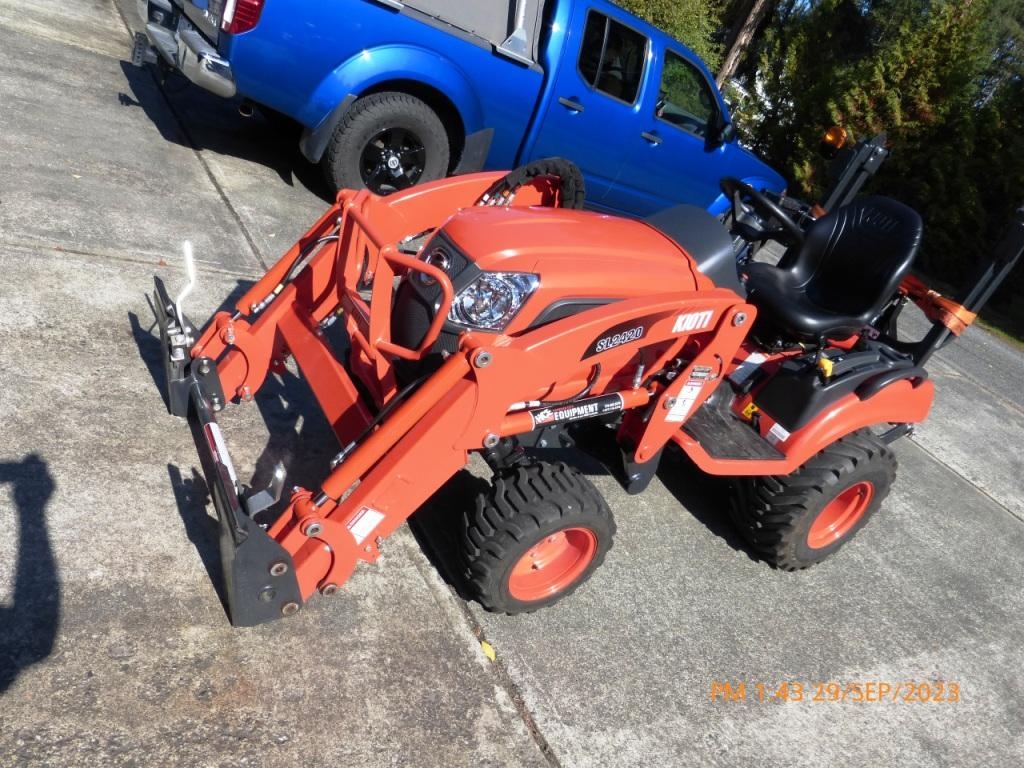

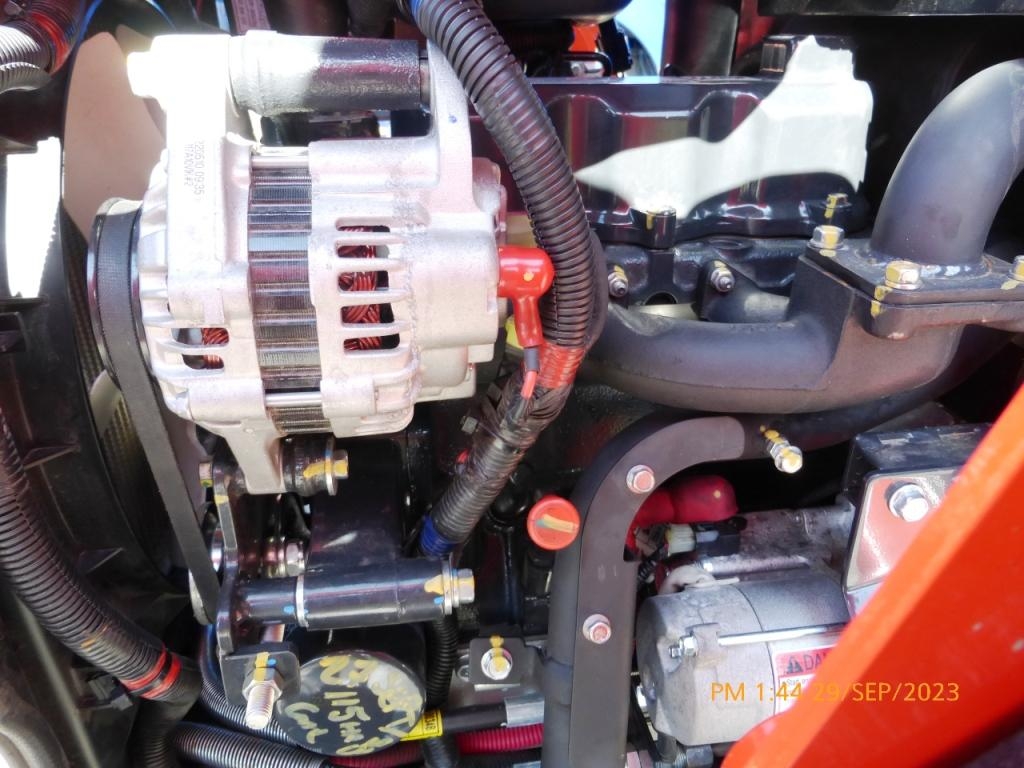

Post Surgery Epilogue: It is fixed and waiting for a ride home from the hospital. The list of repairs and replacement parts includes: 3 head, valve well flanges ground down, 6 new valves (apparently they are somehow new and different from the originals??), 3 new glow plugs, 3 new injectors, 1 new head gasket, oil & filter change and some top up of lost coolant fluid. Tech check torques and marked the nuts/bolts (see pics). Outside the pistons and the crank shaft it was pretty much a top end rebuild.
