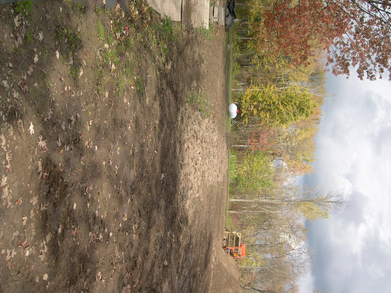

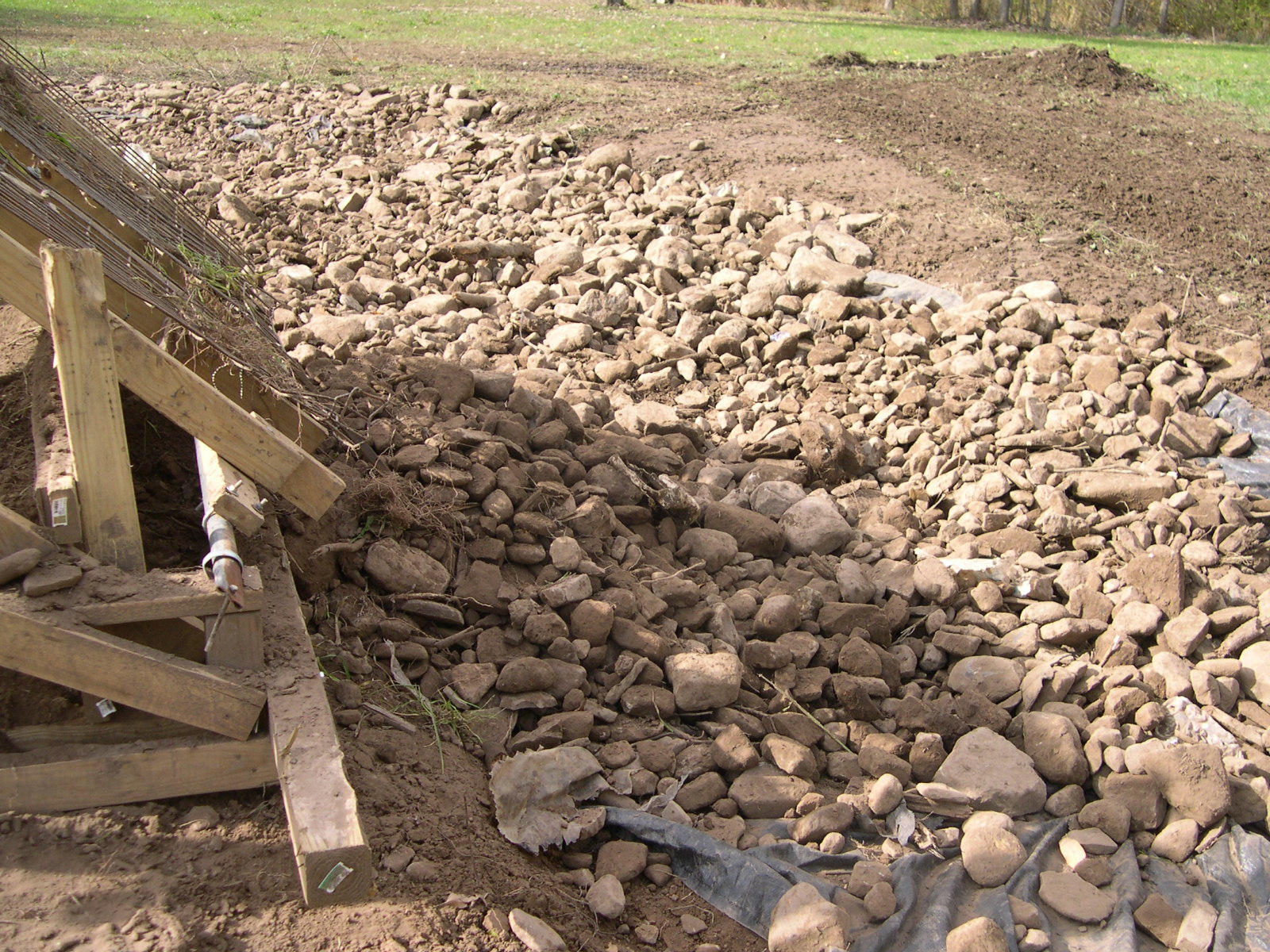

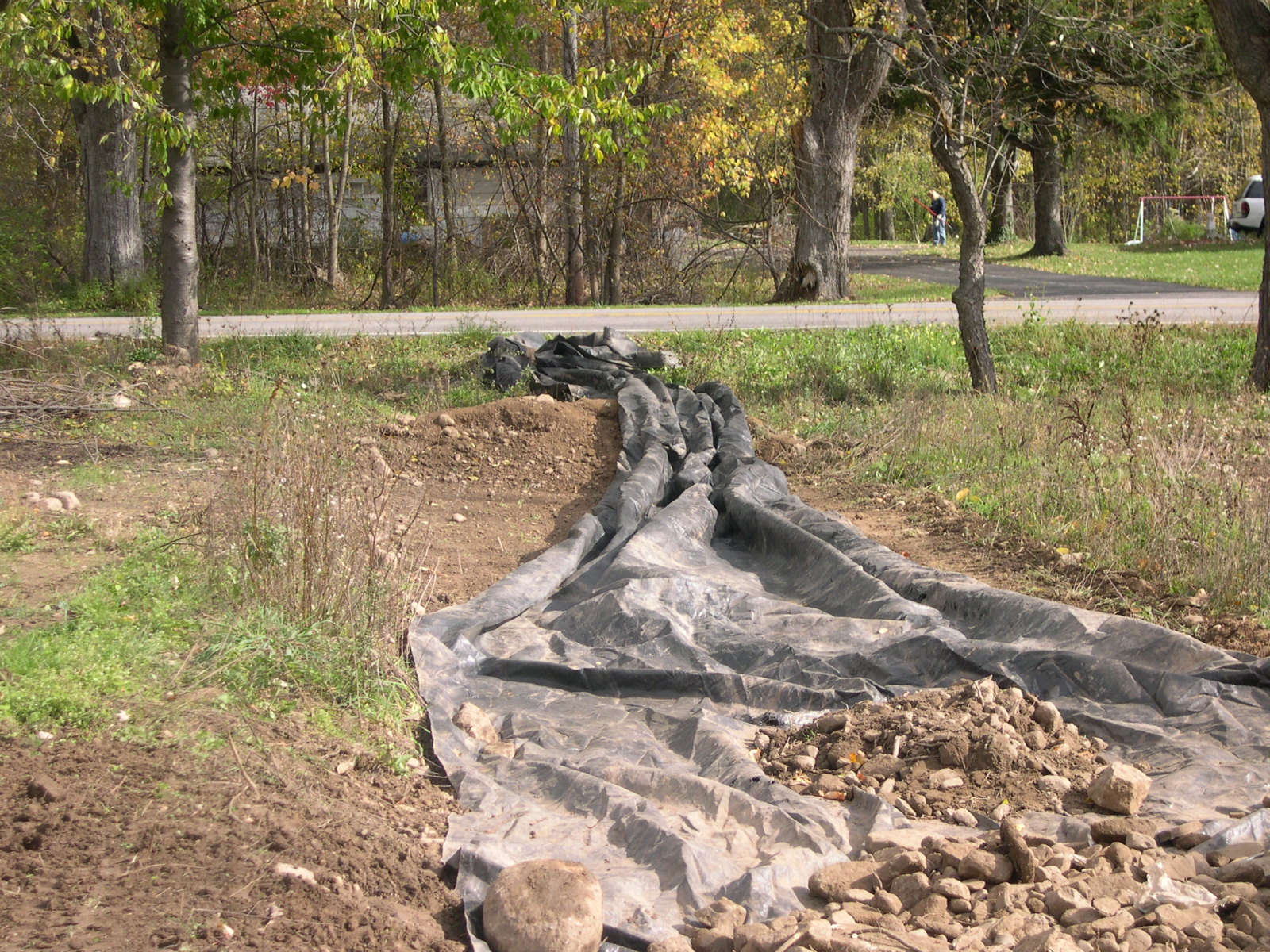

Been working on a driveway for a while now (doing it all myself) and here is what I did. Dug down about 8-10", placed tarp on the bottom, screened my own rock (between 80-90 ton, or so I'm told). Base rock is no smaller than 4" on average. I have attached pictures so you can see the size screen that I used for the base. When the base is down I have a friend with a very heavy JD that I will use to pack it down. I will then throw a sheet of expanded metal of the screener and run the dirt down it again to get the smaller stone for the top layer. Now I have well screened top soil and a fairly cheap stone driveway. The idea is to get all those smaller stones down into the cracks of the big ones so they bind and not shift. When I'm done packing it down I'll order in some 1" crusher Run W/binder and smooth it out. The 1st 50' of my drive way was done this way 3 years ago and is "ROCK Solid":D . I plan on paving after a few years of settling and as soon as I win the lottery. If the pictures don't work, somebody let me know and I'll try again.

Instead of winning the lottery, maybe you could have saved the fuel cost of screening so much dirt for just some rocks, and with that saving, pay transport for someone who wanted to get rid of a heap of rocks, and pay the paver too... ? ;)
