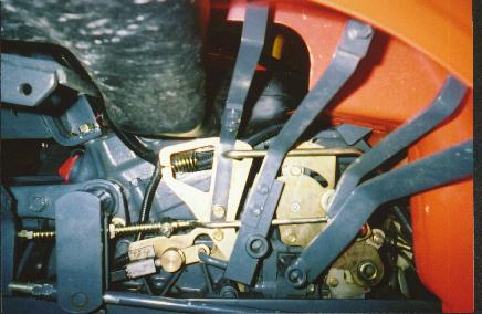

/ Cruise Control BX2200 #21
view of all levers and linkage installed

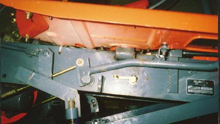

/ Cruise Control BX2200 #22
Release actuated by the brake pedal
/ Cruise Control BX2200 #23
outer view of all levers

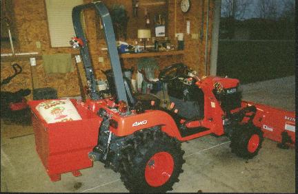

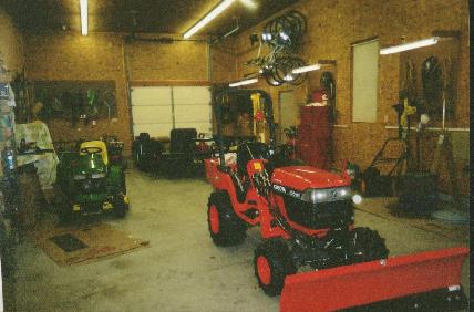

/ Cruise Control BX2200 #24
pic of the BX
/ Cruise Control BX2200 #25
another
/ Cruise Control BX2200 #26
rear view
/ Cruise Control BX2200 #27
side view
/ Cruise Control BX2200 #28
right side , that should be about all the pics I took , the installation isn't that hard ,just time consuming.
