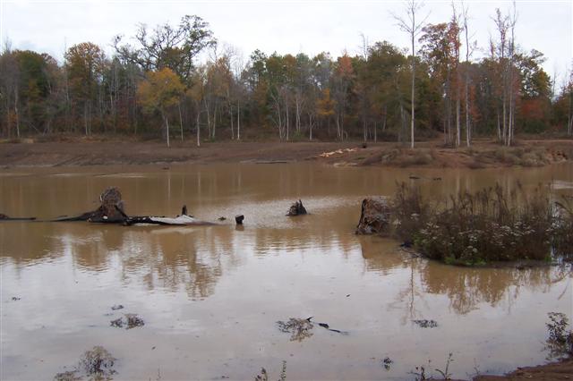

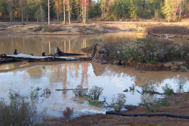

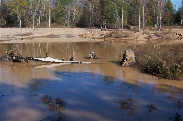

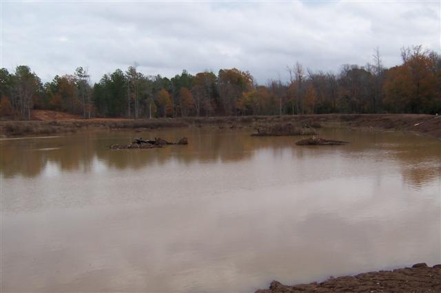

Yep. That's what I was counting on with placing this dam and getting the most for my money and time.
Large shallow bodies of water have lots of surface area for the volume. They heat and cool more quickly and are subject to greater evaporation losses. Deeper impoundments with less surface area for the stored volume are slower to heat and cool and lose much less of a percent of their volume to evaporation.
It is easy to get carried away with surface area and not get enough depth. All this is relative of course and depends on many factors. If you have ample RELIABLE rainfall or reliable springs and or no droughts then shallow isn't as risky. Bigger surface looks more impressive until a drought if you don't have sufficient depth.
I do want sufficient depth in this lake, and do expect to have to take the surface down a bit, but also plan to take advantage of the valley there to provide much of that depth. There is a big difference between digging a 10 acre/30 ft deep lake and damming up a 26 foot deep valley that is 10 acres long. I also want max depth at the dam with some shallow-er fingers for fish habitats. What I've read here and on PondBoss so far you don't need massively deep waters for LMB - which is my favorite. This might help visualizing it. Here's a cap from Google Earth in their 3D mode of the valley. It's not detailed like an actual photo from the air, but will do. The dam would be near the viewer with the lake backing up away from you.

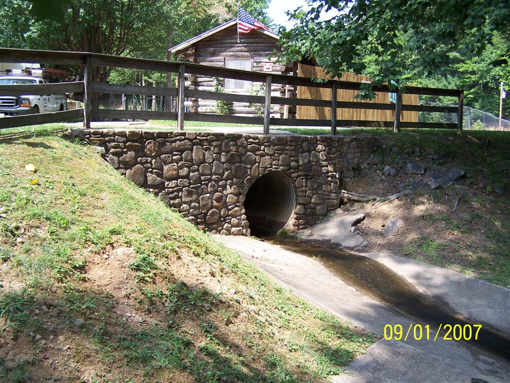

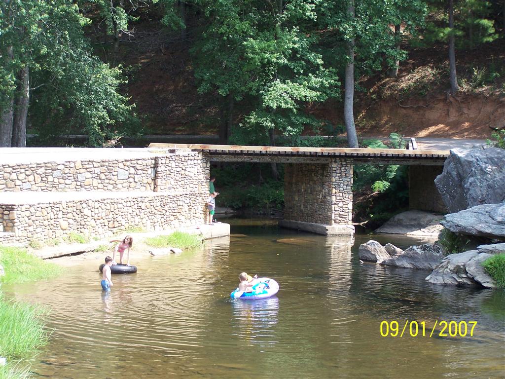

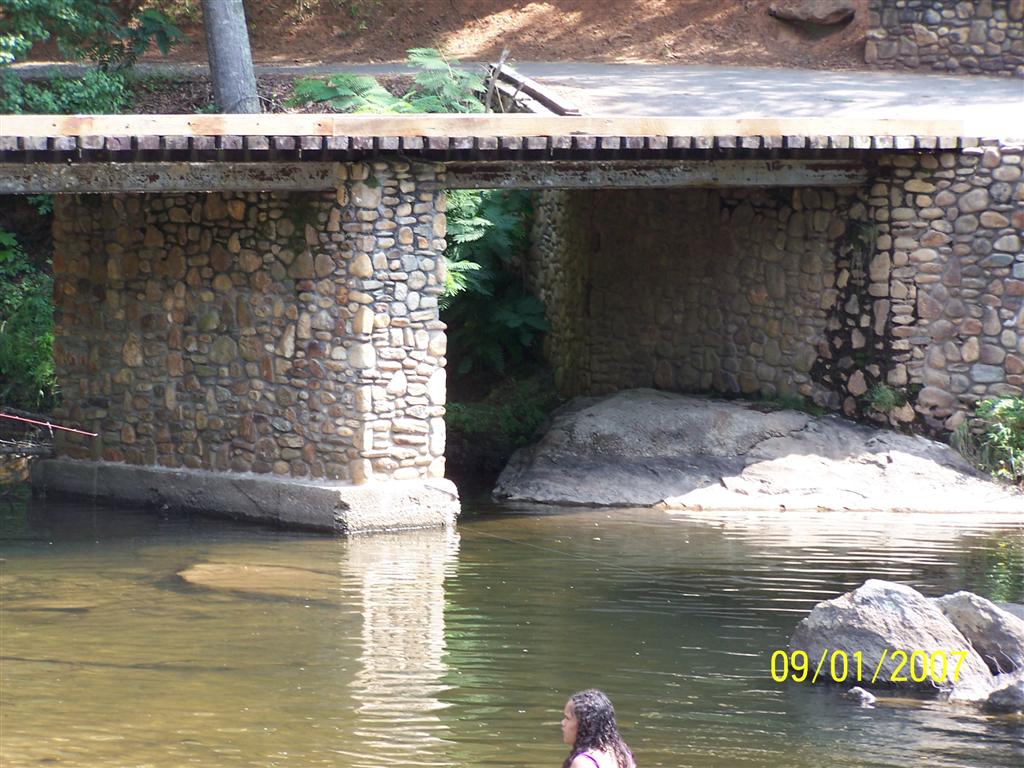

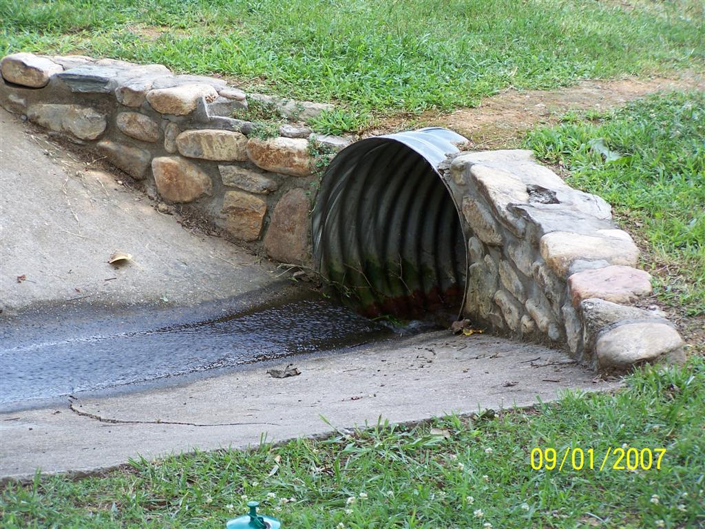

The campground I have my RV at has a lot of nice rock work and attractive bridge made from river rock. I will be up there this weekend and if I can remember to take the camera I take a few pictures a post them next week.
I'll also take a few of there pond and culverts.
David
Eddie,
Here are the pics of the bridge and culverts.

David,
That rock really looks great!! I can see that it was added after the bridge was built, but done so in a very nice way. Just being in that creek looks very inviting!!!!
My bridge won't be nearly as tall There will be two feet from the bottom of the bridge to the spillway. In that two feet, I'm gonna put on a dry stack, ledgestone cultured stone. It will also just be for walking across. No cars.
What will make it unique and an attraction will be my railings. When done, it should be one of those places people want to stop and take pictures. If I do this right, it will be just such a location.
Thanks again for the pics. I really like it!!!
