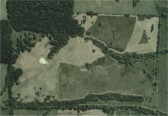

EddieWalker said:
Don't let your tractor limit you on how big to make your lake. My first couple ponds were dug by shovel. Then I graduated up to a backhoe and have a 3/4 acre pond next to my home that I dug in several months of working seven days a week hauling dirt out for ten hours at a time. It's not hard to do, just ming numbing boredom of doing the same thing over and over again. Then it took me half a year to get rid of the dirt pile I made digging out that pond.
Ha! Pond by shovel. :eek: That hurts just thinking about it. No worries on me making it too small. I pulled up my farm on Google Earth and used their measuring thing to figure out about how big the lake would be. (rough estimate anyways) Since I'd be damming up a valley it's hard to say exactly where the water will go until I get out there to survey it, but from just walking the fields there would be several fingers, maybe 10 to 12-ish acres under water. That's WAY too much for me to do all by myself, but like I said, after reading your posts I'm inspired to do as much as I can. Here's the lay of the land and another with the lake outlined and the proposed dam in red. The square there on the right is about 80 acres for scale. The existing pond in the field on the left is about 1/2 acre.
I'm sure I'll have many many questions when I get into that project and I have some equipment yet to buy, so unfortunately it will be a little while. I'll probably just start by taking out some of those trees - maybe even have them harvested as there's mature wild cherry and white oak all through there. It would be great if I could get someone to pay ME to do some of the logging work for me! :)

Spiveyman,
Thanks for the pictures. They really help show what you have to work with and how cool a lake you will have when you build it. With that much area to work with, you won't have any problems getting dirt to buidl the dam. Just push it up from the bottom.
What you need to think about is the size of the dam, not so much the size of the lake. A guy with a big dozer with a straight blade can move an incredible amount of dirt in a day. My dozer is 169 hp and has an 8 way blade. It's the wrong type of blade for moving lots of dirt, as it's rated for three yards. A similar sized dozer with a straigt blade can move five yards easily. Go up in size to a D7 and your moving 7 yards at a time. Those extra yards of materail really make a HUGE difference in time, and time is money.
In a perfect world, I'd much rather have your layout for a lake then what I had tot deal with. I love a lake that has fingers, points and a more random shape.

/ Creating a Lake #1,178
Thanks for the tips on the Dozer work. I don't know how many dozer guys I'm going to have available to choose from, but it sounds like that would be a good quesiton to ask - what's the dozer rated for in terms of yards of dirt? Is there a better way to ask that?
I'm very excited about the possibilities on the back of our farm. We run the cattle up front, but I wanted to leave that back section for rec purposes - ATV trails, horse trails, camping, shooting, fishing, and also pull hay for the cattle. I'll tell you though, here's my real motivation for putting in that lake. This is my little girl, 3 years old with her first blue gill last weekend! :) That's my papaw's pond just down the road from our farm.

Spiveyman,
Beautiful picture!!!! She's a cutey.
I can relate to your motivation, as mine is very similar. I like to build things and work on the land, but for me, the real pleasure is in making Steph and the kids happy. By nature, I'm lazy and tend to procrastinate. If it wasn't for them, nothing would get done and I'd spend all my free time relaxing and getting fat.
Getting into the world of hireing dozers is about as tricky as they come. It's one of those trades thats ripe with thieves, liers and outright crooks. In no other area have I seen so many problems as hiring a guy to move dirt.
A few things to consider before hiring anybody.
Get multiple bids and be sure you are comparing apples to apples. Pricing is either gonna be hourly, or for the job. Both have there disadvantages. Hourly can drag it on forever and keep running up a bill. Bidding the entire job doesn't gurantee that it will get done for that price, but it might mean that corners are cut to get it done and get out of there.
I prefer hourly myself as I can keep an eye on what's happening and see right off if I'm being taken advantage of. For smaller projects when I hire somebody, it's usualy the price for the job, but that's just the way it is in home construction.
Then be sure you agree up front to what hours you are paying for. It's very common to charge hours for down time, maintenance time and repairs. You don't want to pay for this. Also be sure they are honest in their hours. I've had problems with guys starting at one time, but billing for an earlier time, or just saying they worked 8 hours that day and it wasn't even close to that.
Rates vary all over the place, but here, you can hire a small, 80hp tractor and operator for around $80 an hour. This is way too small for what you want to do, but just a starting point. A D6 sized dozer will run in the low $100's an hour and probably charge a delivery fee of $200 to $400. A bigger dozer, like a D8 is about the same to deliver as a D6, but will run another $40 to $50 an hour to hire.
The huge difference is that the D8 will move twice as much dirt as the D6. You pay a little more per hour, but you get twice the work out of it. Sometimes it's more like three times the work depending on machines and blades.
Be upfront with everyone you talk to. How much dirt is the dozer rated for? What size machine and how old is it? Older machines still work fine, but they tend to break down more often and it might take months to get it fixed. You don't want a dozer sitting around for months on your land with nothing getting done!!!
Track loaders and dump trucks will move dirt over greated distance faster and cheaper then a dozer, but I don't think that's what you need in your area. A belly scraper is the fastest way to move dirt, but again, you need to be moving it over some distance to be effective.
If you talk to a guy who has all these tools, he's probably gonna be able to go in and get it done really fast. In this case, a bid price is the way to go.
Also make sure you know how much dirt you will be moving. Measure it out, do the math and go into this with as much info as you can. If it's a hundred thousand yards, you need to know that beforehand so you can compare the bid price with an hourly rate.
Some guys will also charge by the yard. This complicates things since there is so much gray area when figuring yards to build a dam. The bigger the dam, the stronger it is, but also the nicer looking it is. This is more money to move more dirt, so you have to know where to draw the line.
When you figure it all out and what it will cost, you might consider buying a large dozer. I paid $25,000 for my dozer and have another ten grand into it with a new engine and hydralic pump. I can't even guess right now what I have into it in fuel and oil, but it's probably close to another seven grand. So I have either $40,000 plus into my lake, or when I sell my dozer, I have what's left over after deducting the sales price. Of course, I've also put a couple thousand hours on the dozer using it on other things and will be using it for anoher few thousand hours at least. To build a pond, the general rule of thumb that I came across was $5,000 to $8,000 per acre of water. My situation was different since my dam is over 900 feet long and that price was closer to twice as much. I built my dam three times thicker then it needed to be, so that would have increased the price allot more too. My guess is that if I'd hired it out, I would have spent $60,000 to have it done, maybe more. I couldn't afford that. I really couldn't afford what I have into it, but somehow, it all worked out.
