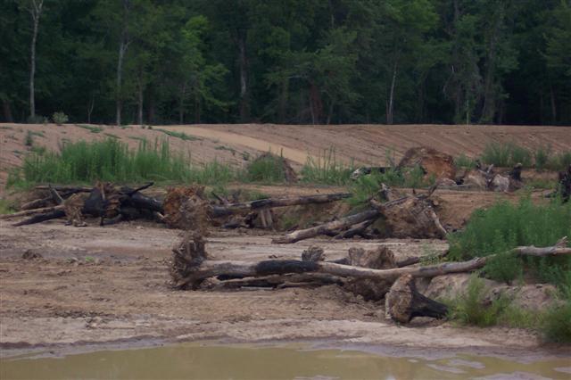

The stuff you see in that picture is just some floating debri. The wind blows it all to one area and it happened to be by the spillway, where I stood to take that picture.
The water is clearing up along the edges. I can see a few inches through it. Unlike the water in my small pond, this water has a differenent shade of brown to it and is constantly changing. It's real bad after a rain, but starts to clear up after sitting for awhile.
It's along the edge I'm talking about. Where the water seems to be only a few inches deep, it looks like you can see junk on the bottom. Like a big mud puddle that's been left alone for a while.
I'd strongly suspect that once you get some ground cover around that lake, it's going to be crystal clear. Just gorgeous!

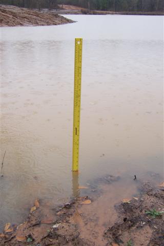

I went to Lowes today and bought a yard stick. At one time, I had a bunch of cheapy yard sticks that were free from home shows, but they seem to have walked off over the years. :rolleyes:
I put it in the ground at my overflow and waters edge, then layed down on the ground and adjusted the height by by best guestamate.
It reads that I'm 29 inches low. (see picture)
My watershed is really good in the areas I've cleared. The water just runs off the grass and dirt, with most of it making it to the lake.
There is a wooded area that is still very thick that might make up ten acres or so that sits just before the lake. This area doesn't seem to let hardly any water through it. This is where I should be getting the majority of my watershed, and from what I see in my drainage ditches, it's very minimal. With the wooded area, ther is another 20 t0 40 acres that should be giving me water that I'm not getting. Where is it going?
As I clear that wooded ten acres, I'll figure it out and do what I can to catch more water and direct it to the lake. I want every drop I can get!!! :D

We had an inch of water in my rain guage this morning, so Steph and I figured it would make the math real easy to see how much the water came up in the lake.
I was 29 inches low when I put the yardstick in the ground, and this morning, it reads that I'm 26 inches low.
One inch of rain, raised the lake three inches.
This is allot less than I expected. I have at least 20 acres of watershed, and it could be as much as twice that with my neighbors land above me. What I'm seeing is the areas that I've cleared the trees, I'm getting lots of water run off. The area with all the timber still on it isn't giving me hardly anything.
In my previous post, you can see all the water that I'm getting through my 15 inch culvert. That is the small one. I have an 18 inch culvert that should be handeling almost twice as much area, but it's not getting half the water the 15 inch culvert is.
I've walked the area and there is just no sign of runoff, erosion or any evidence of water running across the ground. All I can think of is that the ground is just sucking it all up. :confused:
