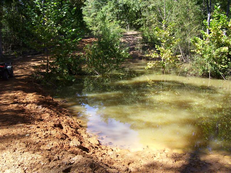

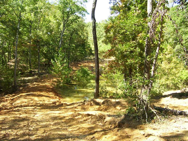

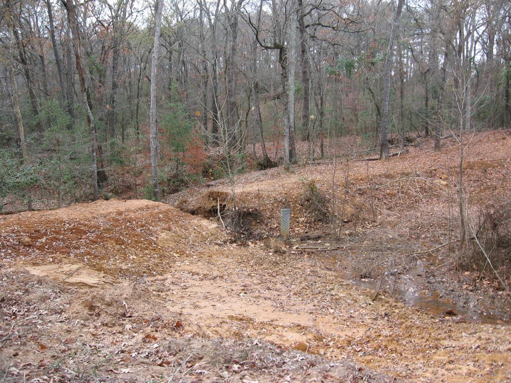

A couple pics taken from Sunday that a dam can fail. I will say that while the dam in this pictures was constructed just fine (lot of red clay, decent size), the overflow could not handle the hard rain. We figure it took less than 30 minutes to wash it out once the water started going over the top because (if I can find the pic), the water was backed up behind it a ways.

I don't know, but it looks as though there were more contributing factors than just the the heavy rains. The before pics show trees growing on the inside of the dam, read that roots. And, the overflow is directly in the path of the breach in the dam. Water could have been weakening the dam along the sides of the pipe for years. The heavy rains may just have been the little extra push needed to cause the breach.
Anyone else out there have an opinion?

It is important that there be a way for the impounded water to escape in an overflow event WITHOUT going over an earthen (gravity) dam. The turbulance in the water going over the back side of the dam will erode it very quickly. Ideally there will be a wide and shallow angle "swale" to lead the overflow water away from the backside of the dam. The wide shallow angle swale reduces the errosion forces and it is less likely you'll get a big inconvenient errosion cut ditch.
I'm not arguing against an overflow drain pipe. Some of my ponds have them but whether or not a pond has one it must have a safe way of passing water safely away from the dam in an overflow event. I have seen 9 out of ten of my ponds overflow much more water than the ones with pipes could handle.
I have one small pond, downstream of a couple others, with a 30 inch drain pipe. THis little pond get overflowed into by two larger ponds and NEEDS the 30 inch drain. I have some second thoughts where I think maybe the 30 incher isn't enough as my driveway goes over that dam and an overflow event would endanger the driveway/dam as there is no safe away-from-the-dam water path. When constructing the house there woiuild be times when there was excess concrete to have to dispose of. I had them dump on the backside of that dam. It is nearly all coated in a couple inches or more of concrete on the backside. I expect that to help wth the backside erosion problem shoiuld the 30 inch pipe not keep up.
A couple observatioins:
1. The pix of the dam seem to show that the top of the dam was the lowest place surrounding the pond so in an overflow event the water would go over the dam not some other place more safe.
2. The dam didn't look to be high enough in the air above the water level to have enough weight to properly hold the underwater portion of the dam in place.
An earthen dam should NEVER have the water get close to the top.
Pat

Thanks for posting the pics. It's very sad to see a failed dam, but of the ones I have seen, they are all just like that one. Small farm tank that had water come over the top and erode a ditch through it.
At least it's a simple fix and a good oportunity to clean up those trees. It almost looks like a good thing as now it can be done better than before!!!
I spent allot of hours agonizing over where to put the overflow until I figured out the simplest way was going to also be the best way. You wouldn't believe the plans I had drawn up for a concrete spillway over the dam. hahahhhaha
Luckily the whole project took long enough for me to not rush into doing something that I'd regret. I'm very pleased with my spillway, but still want to see how it performs under an extreme storm so I can make modifications if I need to.

This one has a long and short story. The short part is this dam washed out after 10 days of being rebuilt. The first big rain took it out(actually the first rain). It was built up bigger than before and that's why the trees are so close. The long story is my BIL continues to try and rebuild it. A single 12" pipe will not handle the overflow. This branch is in a perfect location. Collects tons of water, has a couple springs that run year round, even the past 3 years, never dry. But he is going to have to handle the surge. A 3 or 4' culvert would be the minimun if there wasn't a pond. It would need a couple 24's to handle the overflow. Since the dam is very short, he'd have to build it up higher, then put in the 24's as sort of a high culvert, then let them spill on the back side of the dam on some of the huge rocks there.
But I think he's finally given up and is going with my suggestions...a bridge or a low water cement crossing. He needs to get some 10000# tractors and pickups across it. For the past 2-3 years we build a wood bridge big enough for ATV's.
