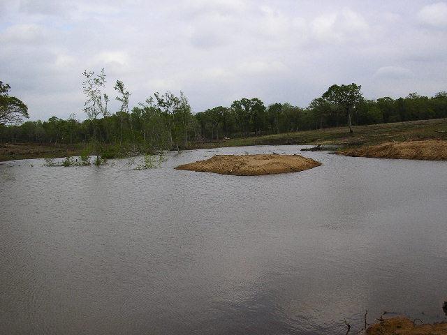

Yes, I'm still pumping.
I've attached a few pictures of the pump that show the creek, the pump and the hose as it climbs over the dam.
My goal is to fill the lake before Christmas, but those who suggested that I couldn't do it are probably right. My guess is I'll be a foot or two low unless I get some rain. It's just an amazing amount of water!!!
On Christmas Eve we're have a party, so I'll pull the pump that morning and put it away. The rest of the water will be from rain runoff.
Nathan,
It's a very, very shallow drop for the overflow. I coldn't have planed a more gentle location for running water to do as little damage as possible. Just guesing, I'd think the slope drops about one foot in 200 feet of travel.
The path the water takes is just inside my boundry. I've left a line of trees and brush about 20 feet thick along the boundry line as a buffer, then there will be this path for the water. It will erode part of the bank as it enters if the creek is low, but if the creek is running full, like it should if the lake if overflowing, than it's anybodies guess what will happen with erosion. :eek:
