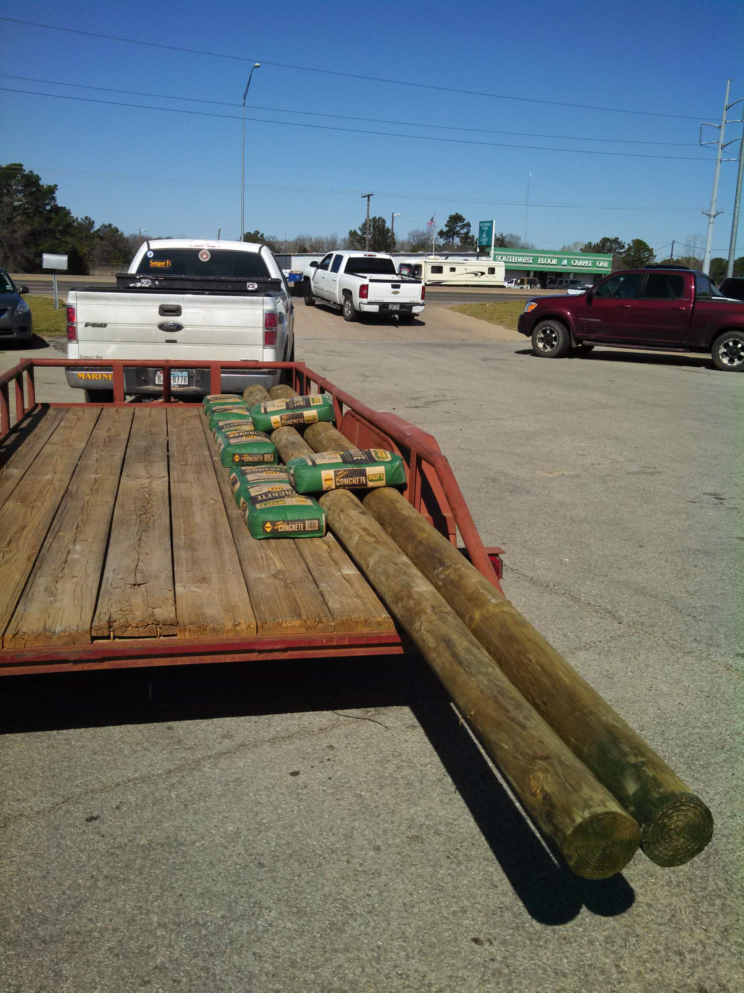

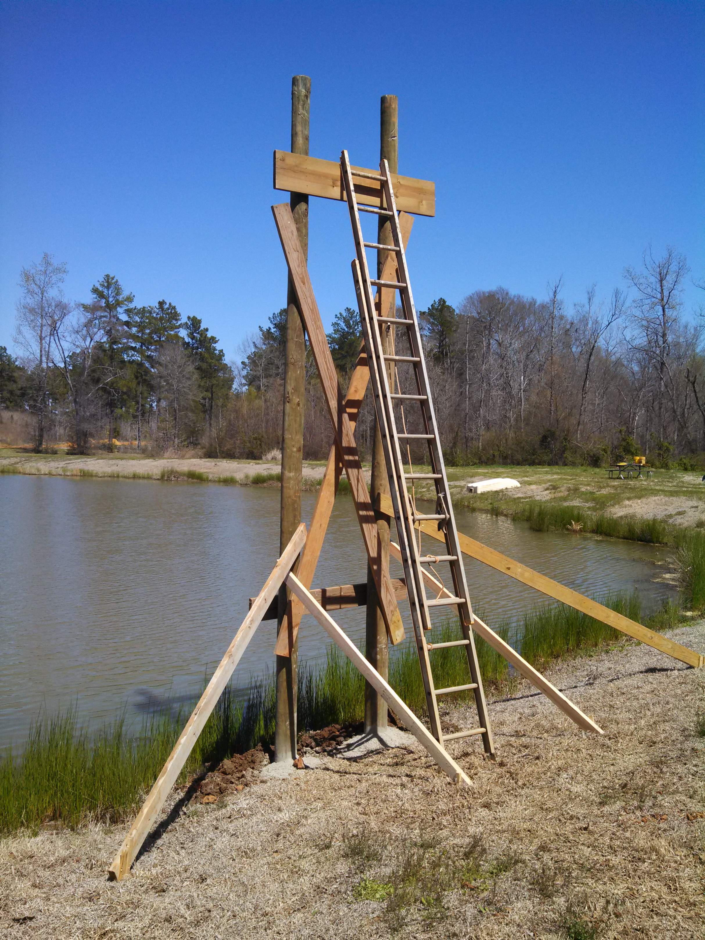

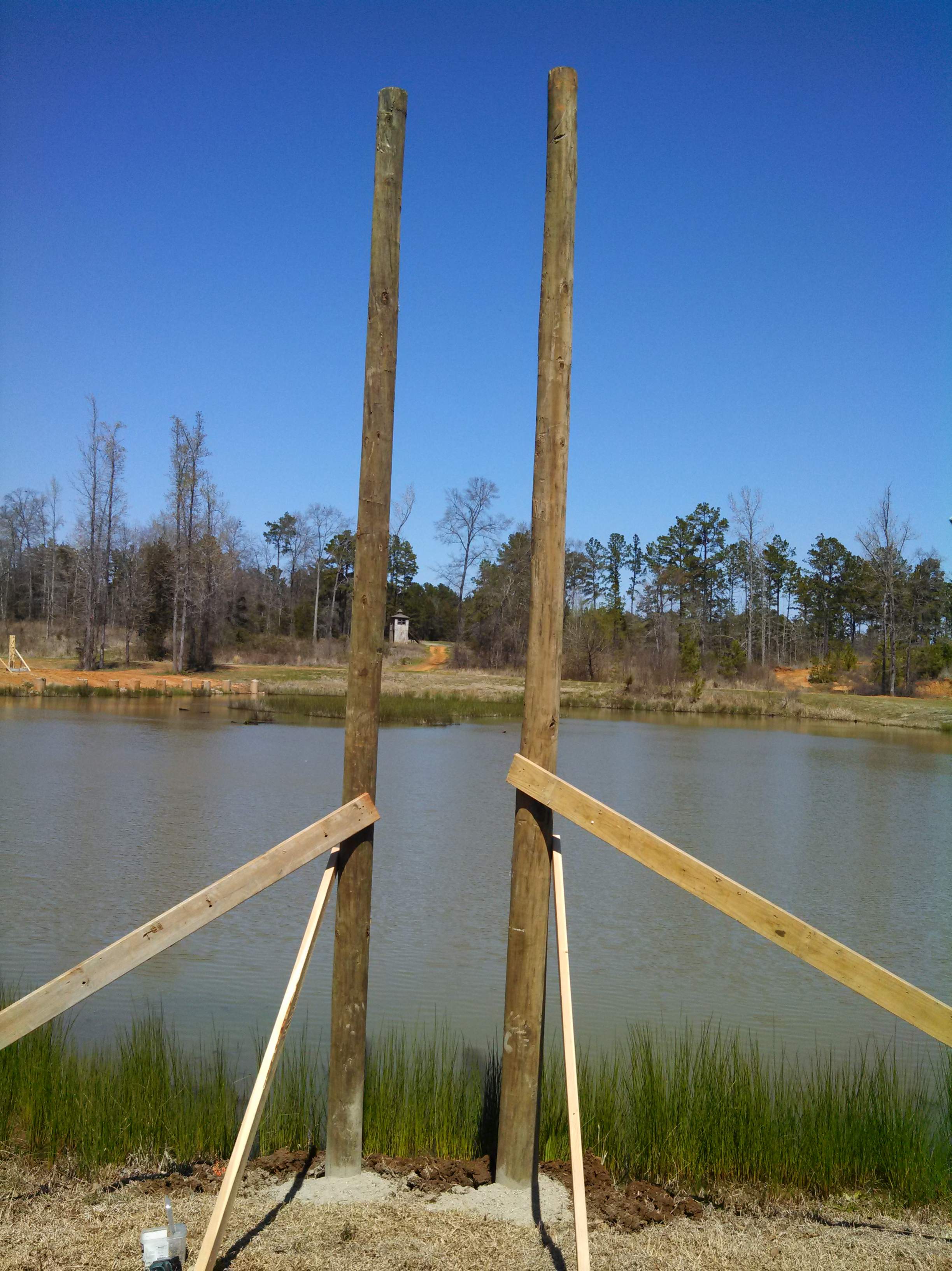

One of the things we want to offer for those sticking around for the party after the wedding is a zip line. Karen and I enjoyed it a lot on our last cruise when we stopped in Roatan Honduras. While the pond is still low, I put in two 20ft treated poles at the edge of the water. My next step will be to run the cable from a big oak tree 50 feet behind the poles and then over the deep end of the pond. The actual run of the zip line will be 400 feet and I'm going to buy a 500 ft roll of 3/8 galvanized cable.
I wont know where to mount the end of the cable until I get it run and see how it looks. The same applies to the platform on the poles. Once I see where the cable height is at the poles, I'll know where to build the platform. The platform will have stairs that go up to it to make it easy to get up there and feel safe. Then it will extend 8 feet out over the pond. This is also for safety. The trolley will be a handle style that you can attach a seat to. If you fall off or can't hold on, the fall will be into the pond.
One thing that we haven't been able to figure out is how to get the trolley back to the platform after going down it. Probably have to have a light rope or heavy string attached to it and then just pull it back by hand, but that might be an issue keeping it from getting tangled. I also thought about a fishing real type set up. If I used a heavy test line and a surf type reel, that might work. Any other, better ideas? The trolley that I'm looking at is bolted together over the cable, so unhooking it and carrying it back isn't a good option. Maybe I'll find another style of trolley?

A friend of mine currently has the longest zip line in the US on his land in Bethel Maine. You will have to add back anchor guide lines to secure those post for forward load. On the opposite end you should set up a counter weight to keep the line loaded. You can buy a quick attach truck to put on your line and carry it back. Don't forget to calculate in the weight of the cable for your loads.

I hope I don't have to add a line to anchor the tree side of the line. It's right at my property line and I'd have to cross the creek and go onto my neighbors land. I'm sure it wont be a problem, but crossing the creek scares me. It's where I see the water moccasins all time.

Run a clothesline off to the side of the zipline? The zipline doesn't have to be permanently attached to it, just when it is at the low end you clip it to the clothesline and start the clothesline moving in the right direction. It should take the zipline back across as long as you have a clip that is secure enough that it doesn't come unhooked in the middle of the lake. Maybe if you want to get fancy you could even add a little electric motor to spin the clothesline pulley and take the thing back. At least that way you don't have to worry about the line getting tangled, or slowing down (or even strangling) the the zip liner.

I came up with what I think is a pretty cool idea for returning a zipline.
A small piece of string/cable would attach the zipline trolley to a winch drum type setup (you could use a small wood spool), attached with pulleys/belts to another spool with another cable. This cable would have a steel weight on the end, and be able to fall all the way to the ground from the top.
What would happen is as you went down the zipline, it would raise the weight (with a ratio appropriate to the distance). As soon as you let go, the zipline would return to the top.
