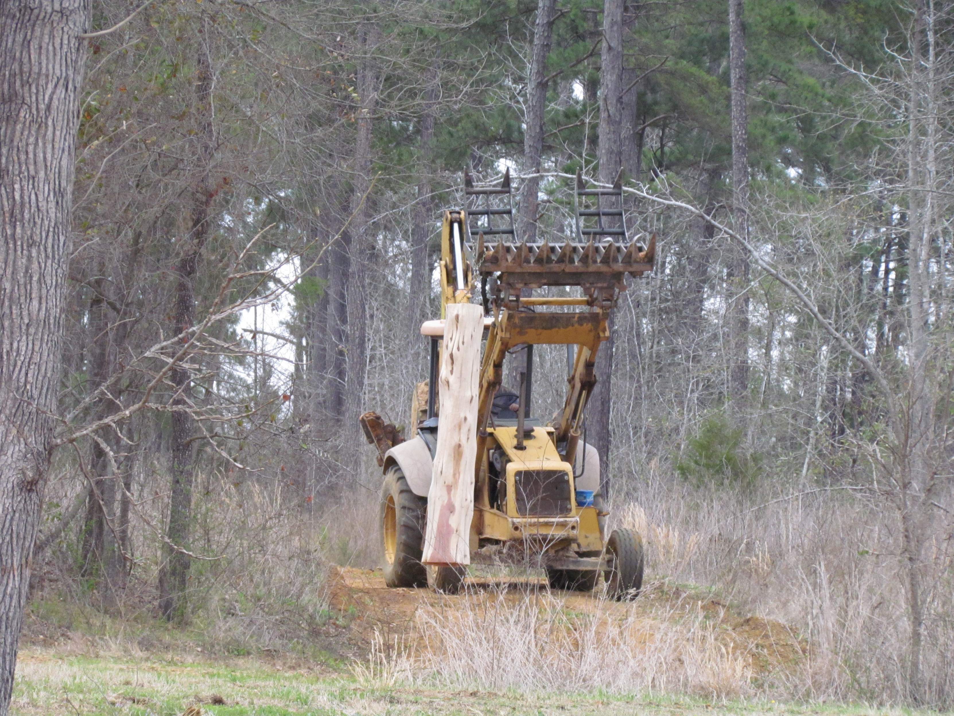

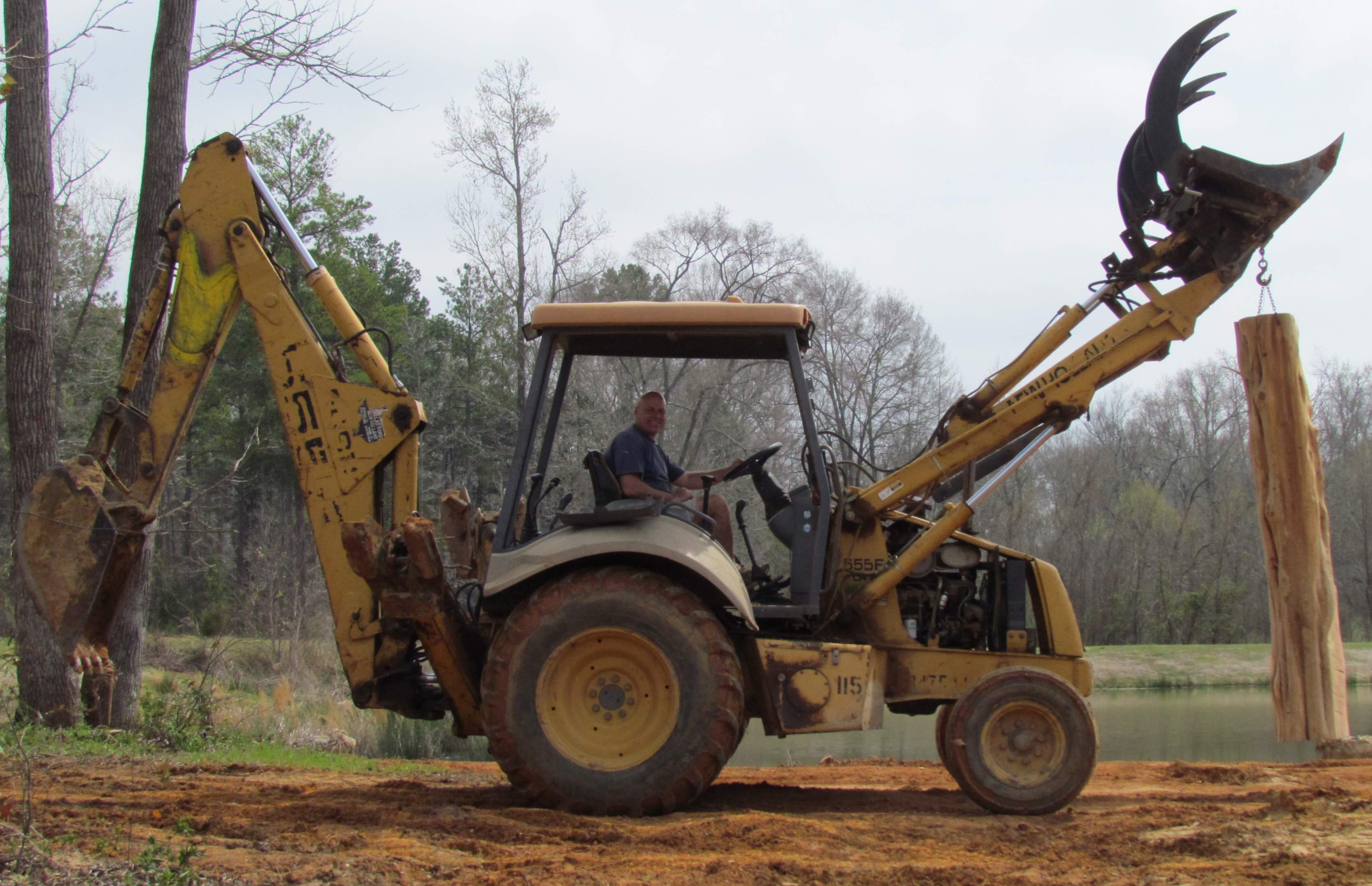

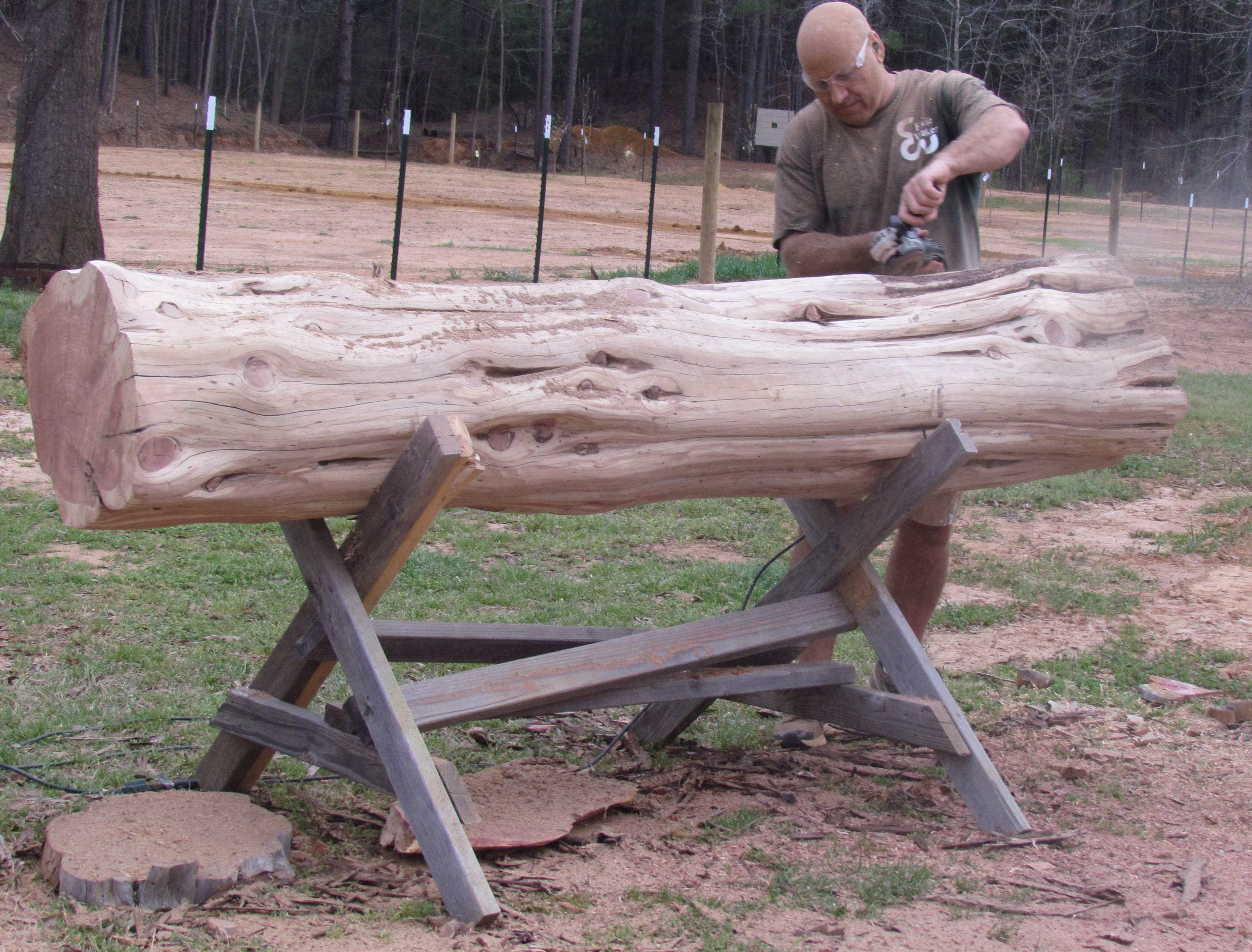

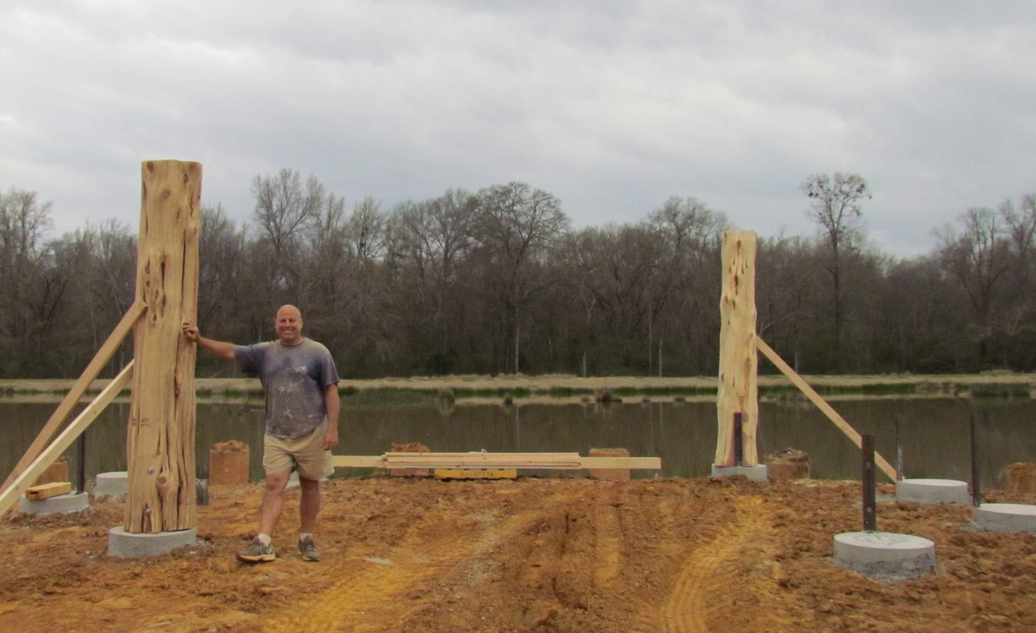

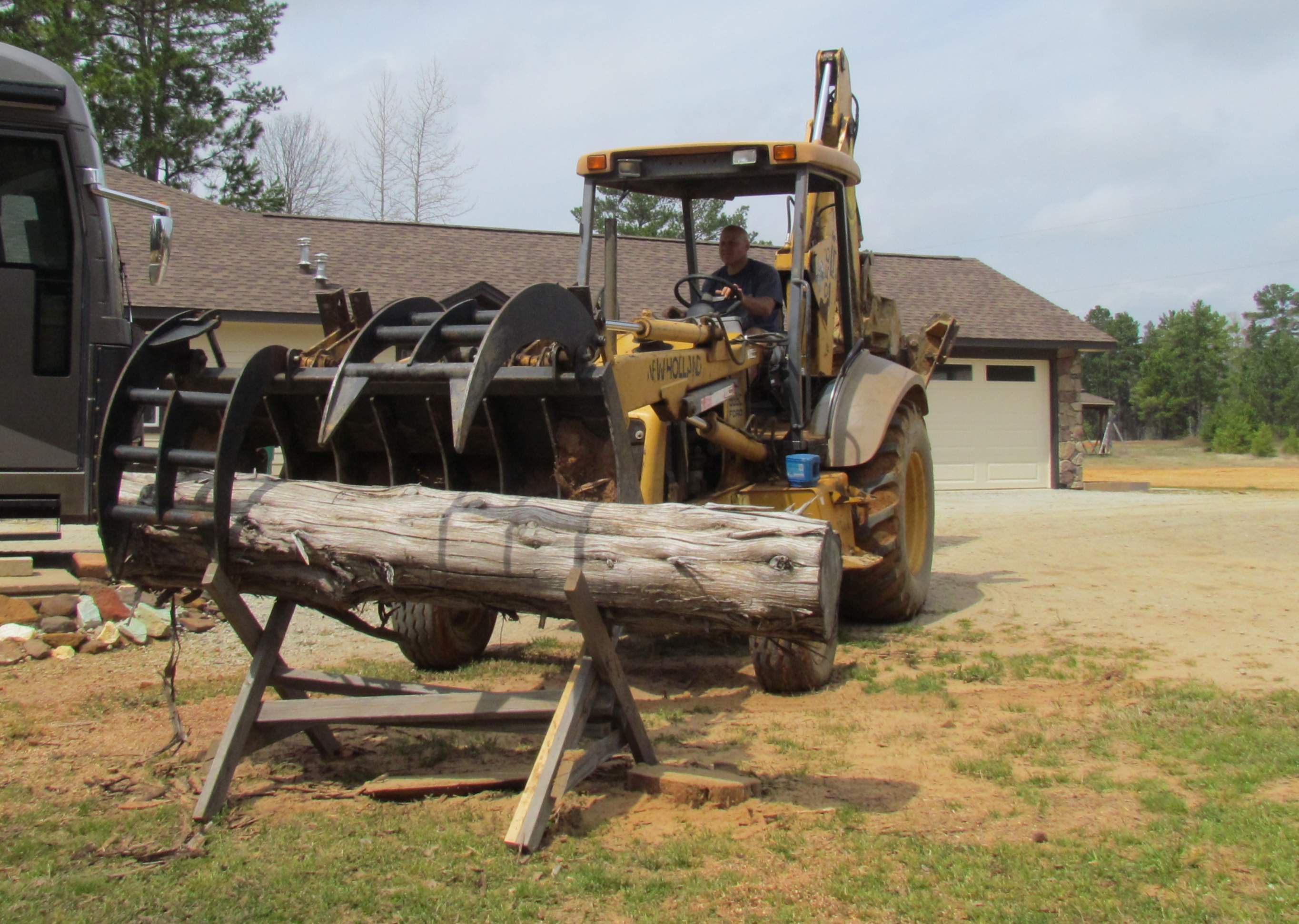

Started on the logs. I have a pile of cedar logs that we've taken out of the land over the years. I picked out the four biggest to get started and have three more marked in the pile. Number 8 is eluding me, but there are plenty to look at, so I'm sure I'll find him.

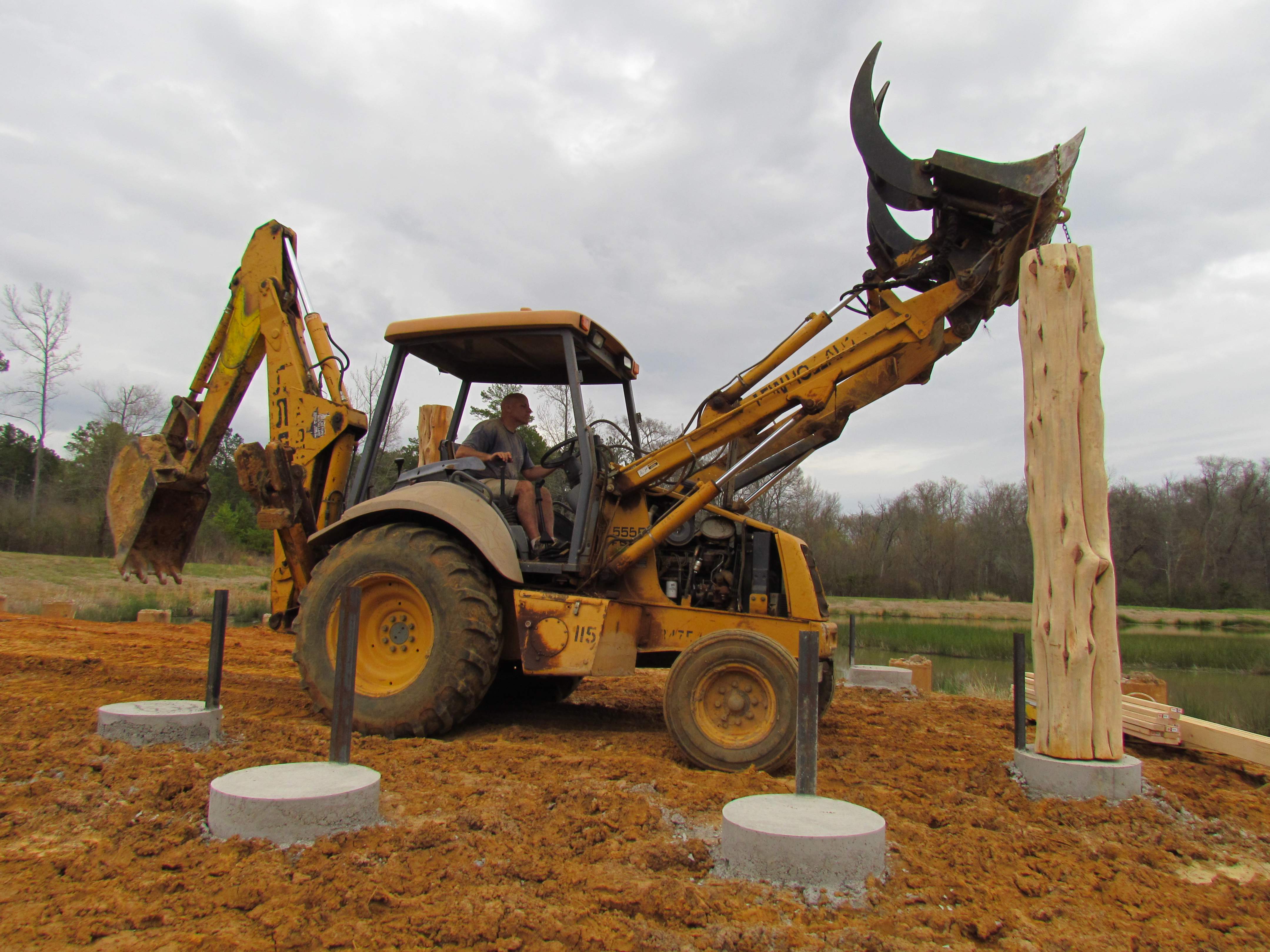

I put them on a rack that I made a few years ago, cut them to 102 inches, cut out al the branches and grind it smooth with a paddle disk in my 4 1/2 inch grinder. Then I put a chain at the end of the log, pick it up with the tines on the grapple and carry it to the peninsula.

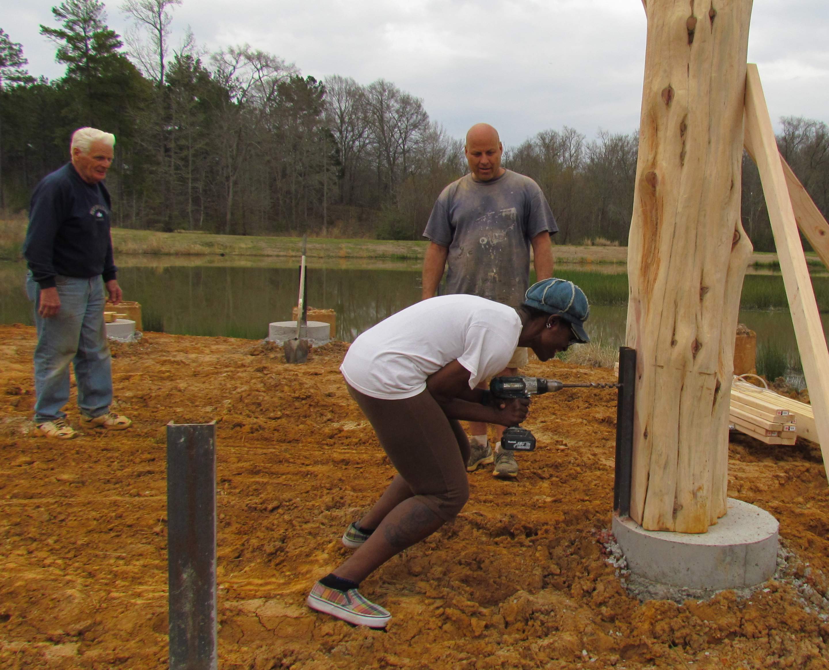

I line it up, brace it and drill two 3/4 inch holes through the logs through the holes in the 3 inch C channel. I'm using 3/4 inch hot dipped galvanized threaded rod. I tried using really long 3/4 carriage bolts on my last gazebo and found them to be short most of the time. This time around I'm going with cutting each rod to length after getting it through the log and bolted together from both ends. So far, this seems to work a lot better.

/ Creating a Lake #2,150
Eddie,
Dad called that kind of rack a saw buck. Looking GREAT, as usual.

/ Creating a Lake #2,151
Holy Cow, Eddie!! When you said you were going to build a "gazebo", I was thinking something that was going to use 4x4s, 2x4s, etc. and would measure about 12' across. That's what folks call a gazebo up here. That is going to be more of a pavillion!!! Always bigger and better in Texas! :laughing: I can't wait to see the pics of it done - it's going to be beautiful!! Are you going to use smaller logs for the roof beams too?
