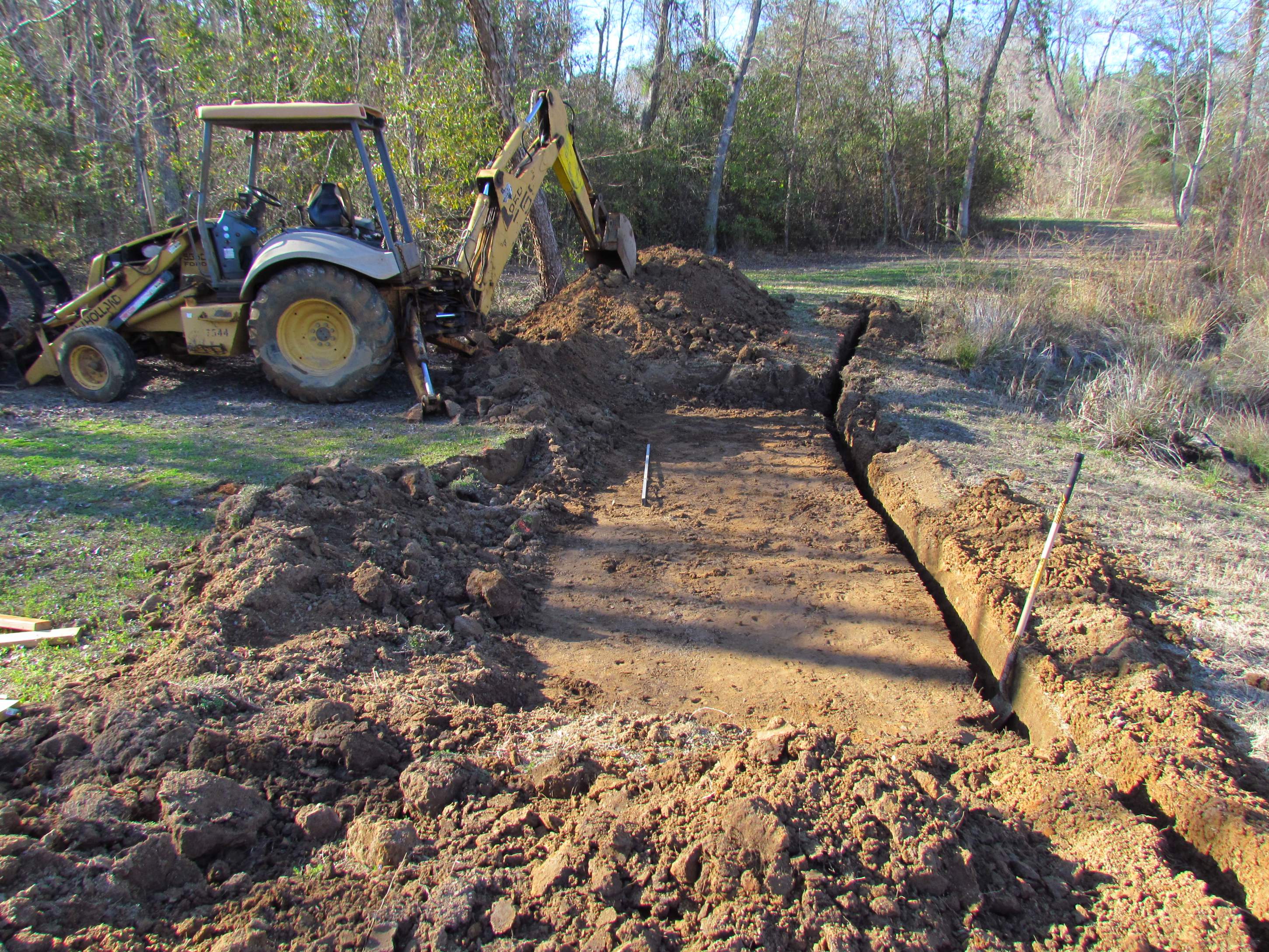

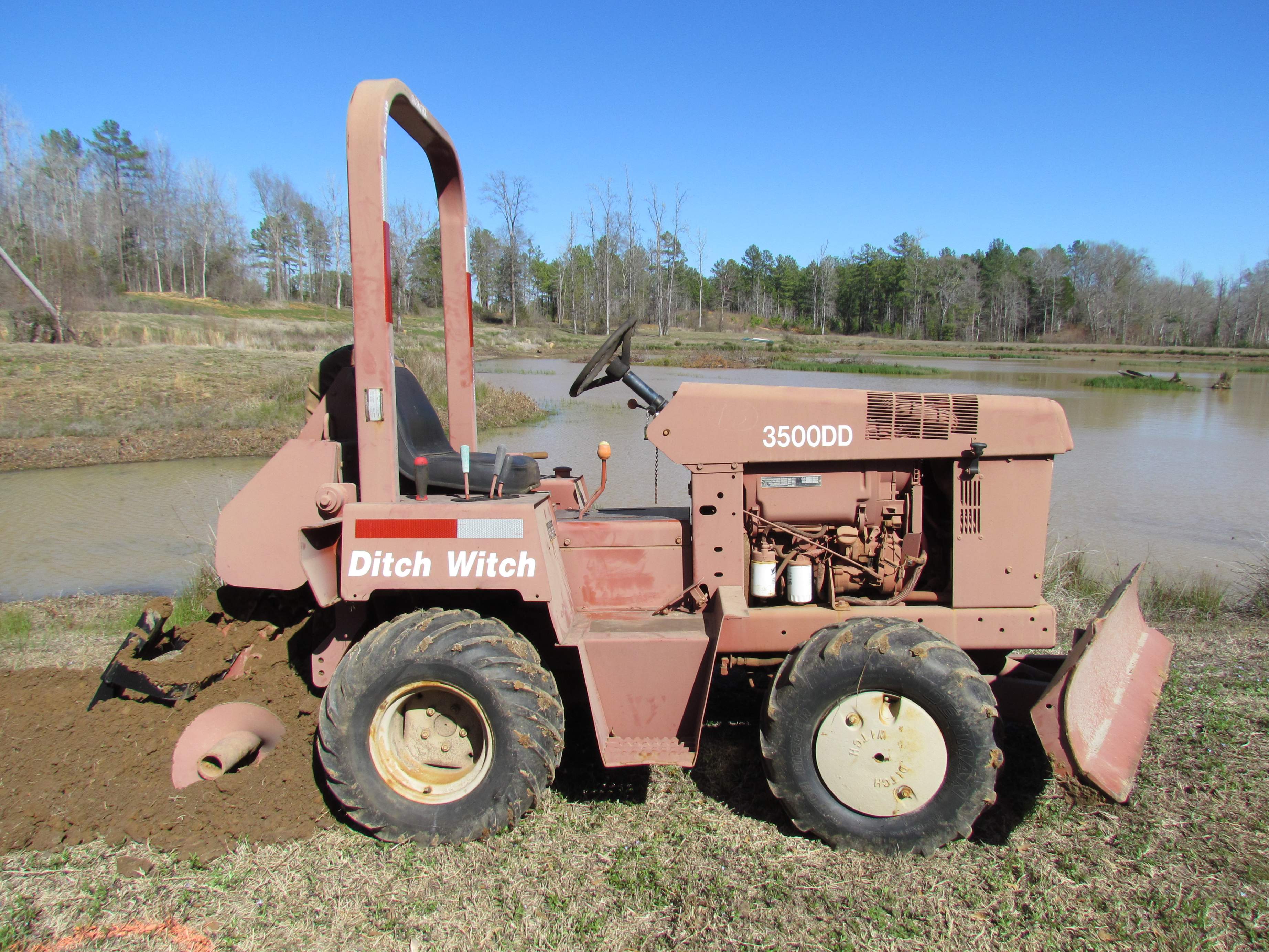

After putting this off for a few years, I started on my bridge today.
My goal is to be able to walk across the spillway when water is running through it. The worse I've seen it is after an 8 1/2 inch storm. The water was half way up my calf when I walked through the deepest part.
My other goal is to create something really nice to look at. Maybe even have people want to have their picture taken when standingon it!!! That would really make me happy!!! :)

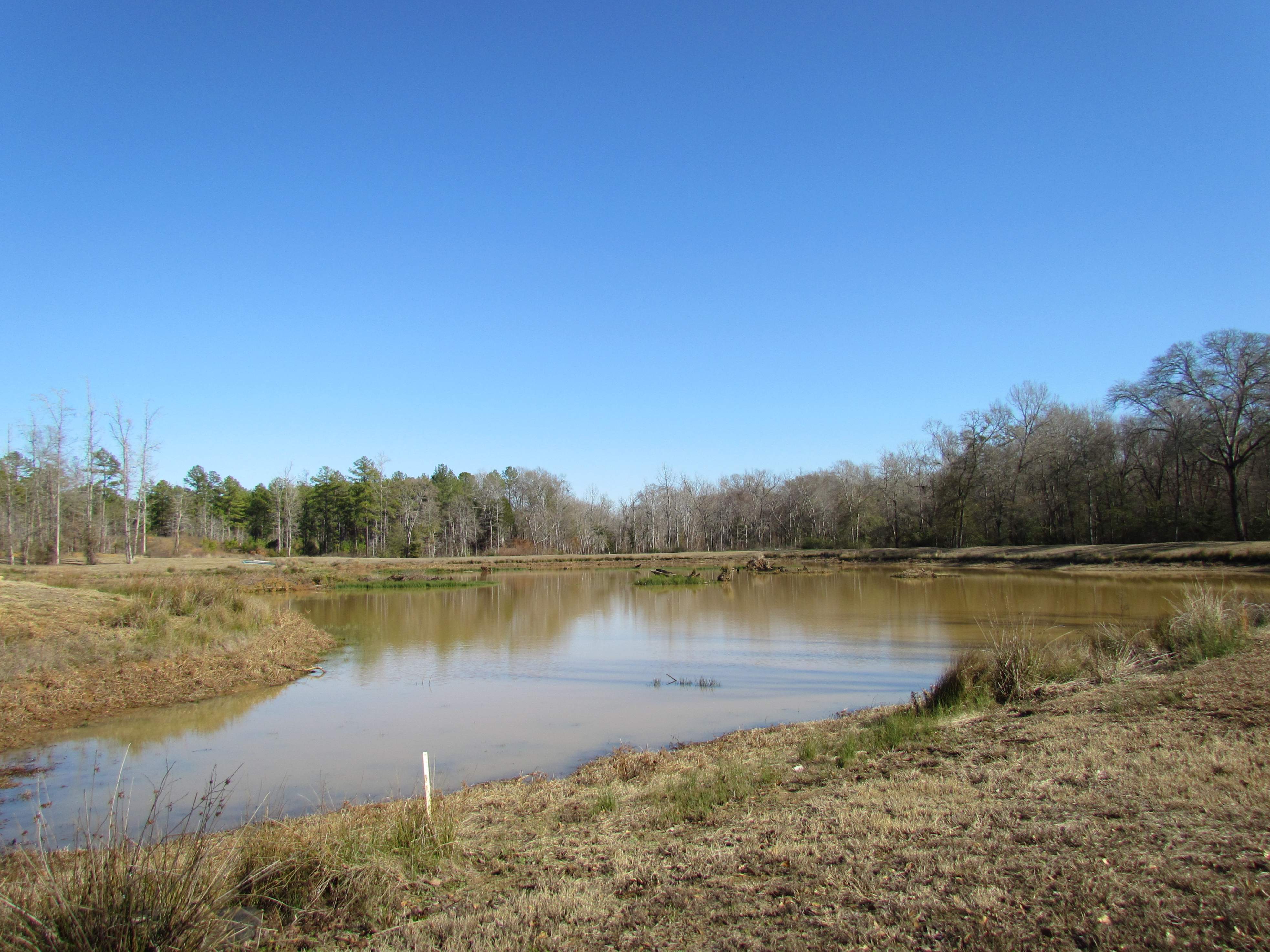

And after a very hot and dry summer, and losing 6 feet of water, I want to raise the water level at least a foot. One more foot of water gives me that much longer for it to evaporate.
I've spent months going over different ideas and designing plans. Not being an engineer, I tried to find something online, but nothing seemed to fit. So I'm winging it. :laughing:
My foundation is going to be done in three stages. First stage is to pour a pad that I can build up on. Second stage will be to install the blocks that will support the wood for the bridge. Third stage will be to pour the concrete wall that will be the dam.
My thinking is that the water will flow over the dam and spash real bad, so I'm pouring a full pad under the bridge to deal with this.

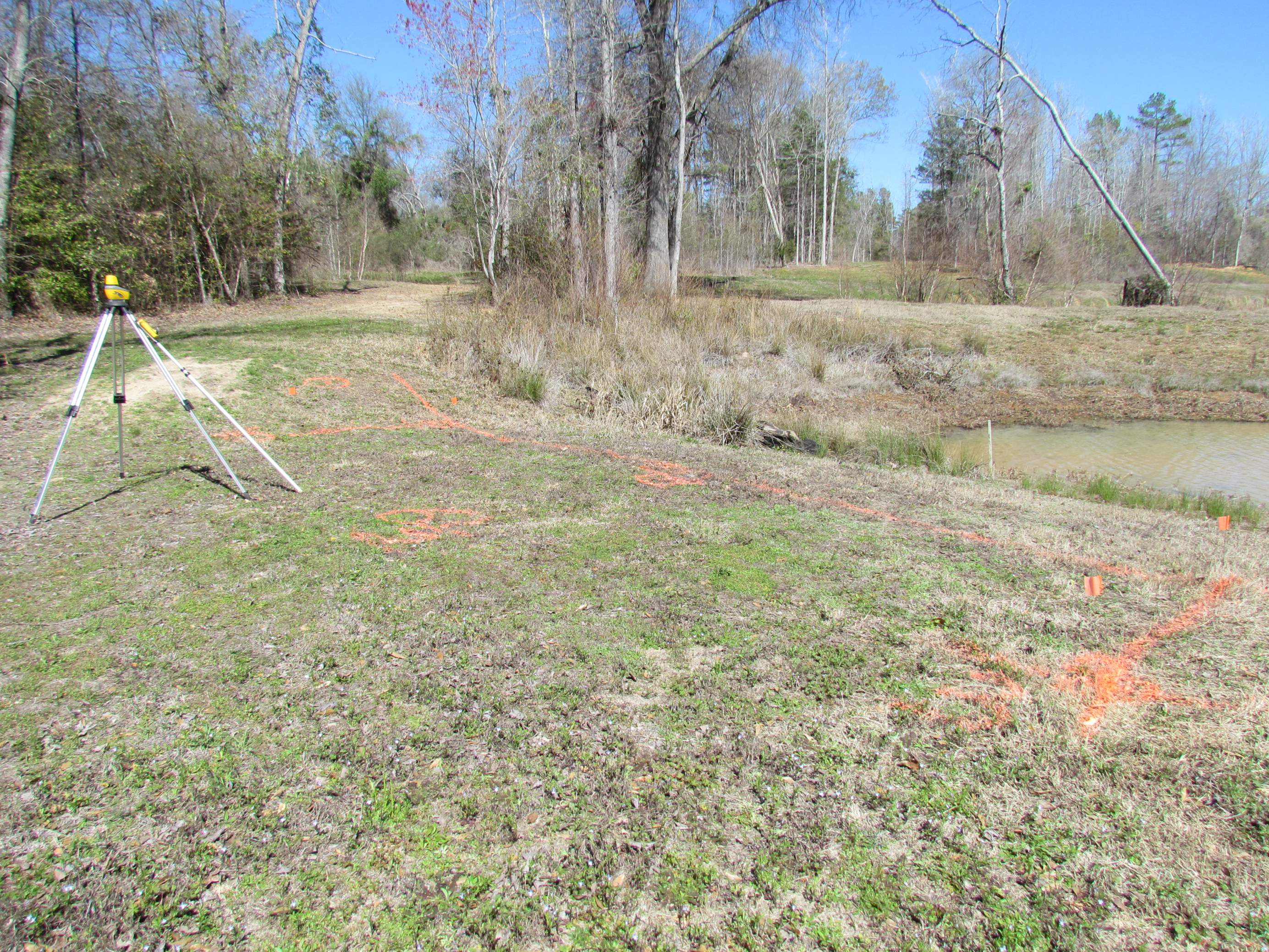

Today I measured the area and checked for level. I was surprised to find out that there is a 7 inch difference from the low side of the spillway to the high side. I was also surprised to find out that the top of the dam is only 22 inches above the lowest part of the spillway.

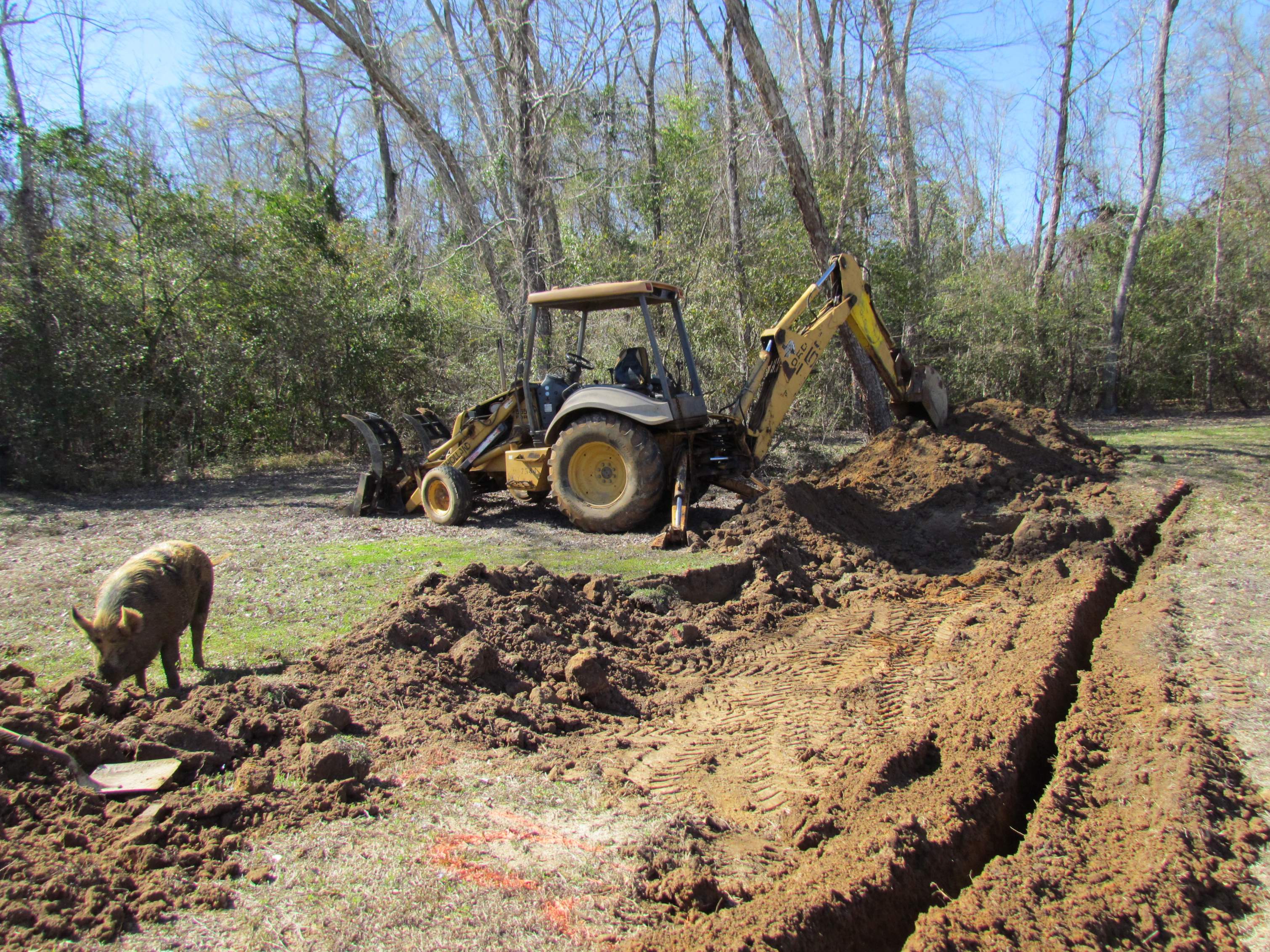

First I dug out the area for the pad with my backhoe.

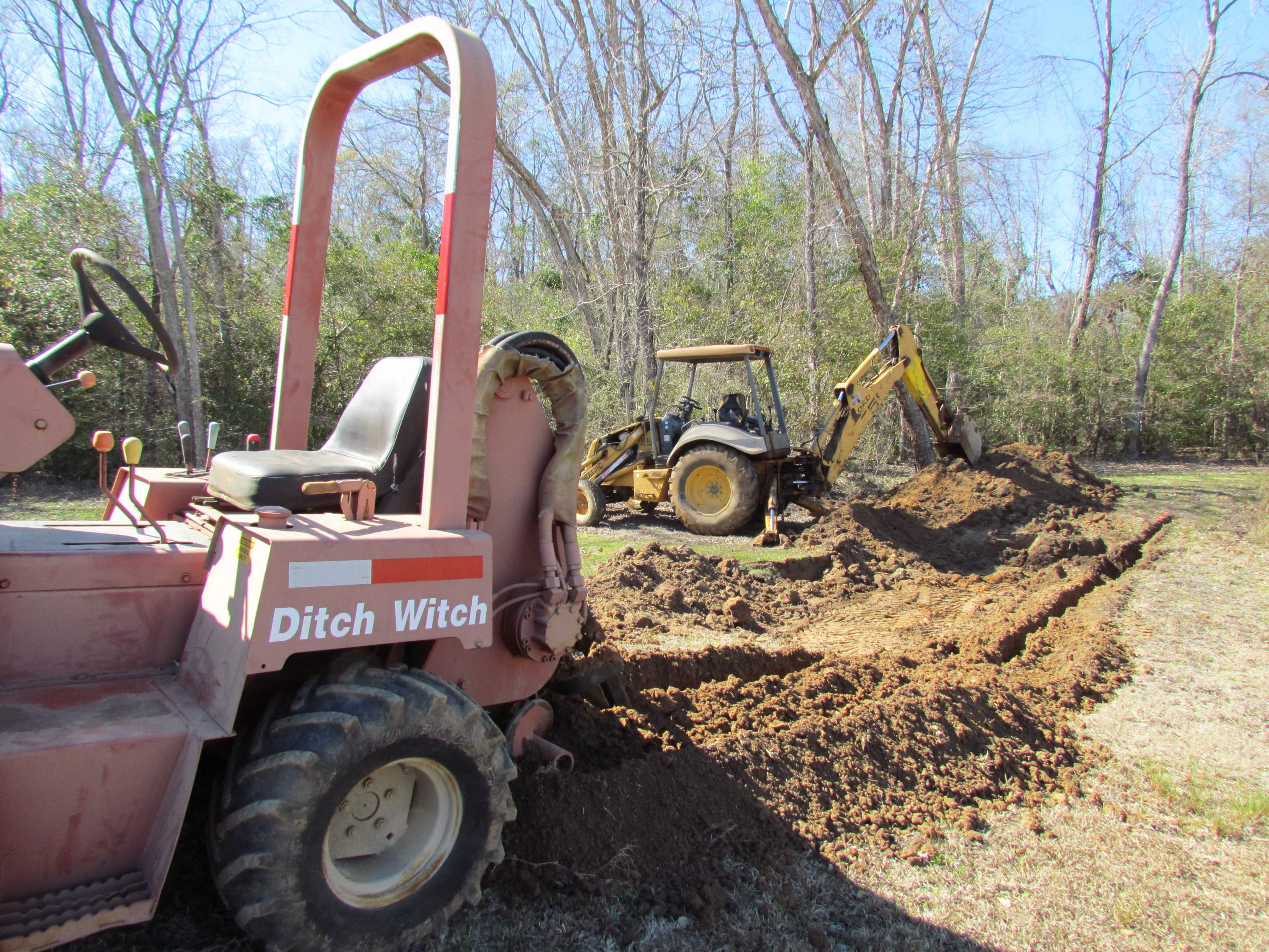

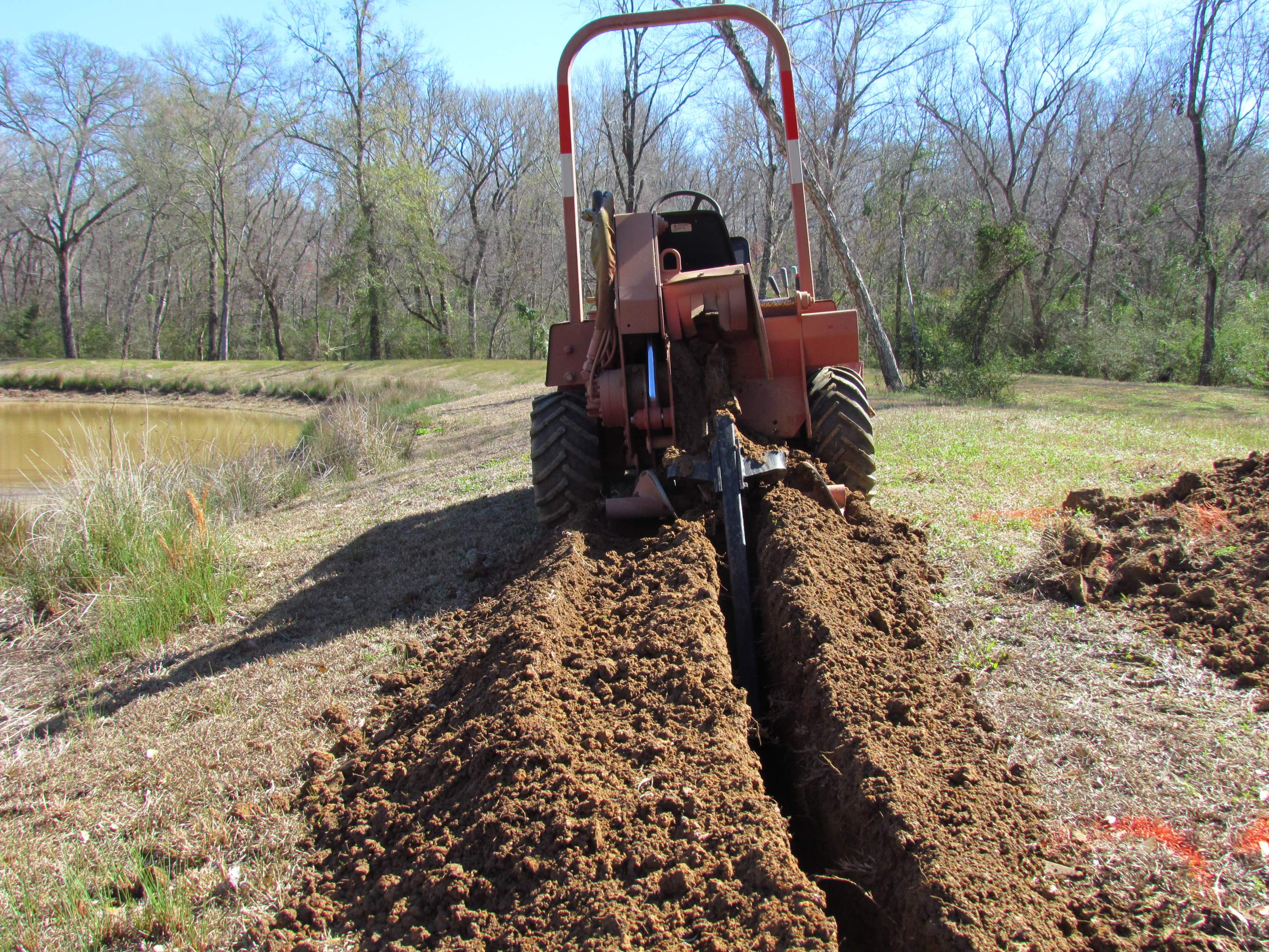

Then I dug a trench along the water side of the pad for the dam. I need this dub now because I will have rebar sticking through my forms to tie it all together. I can't run the trencher where I want the trench with rebar sticking out.
Next time I will build the forms and set my rebar.
