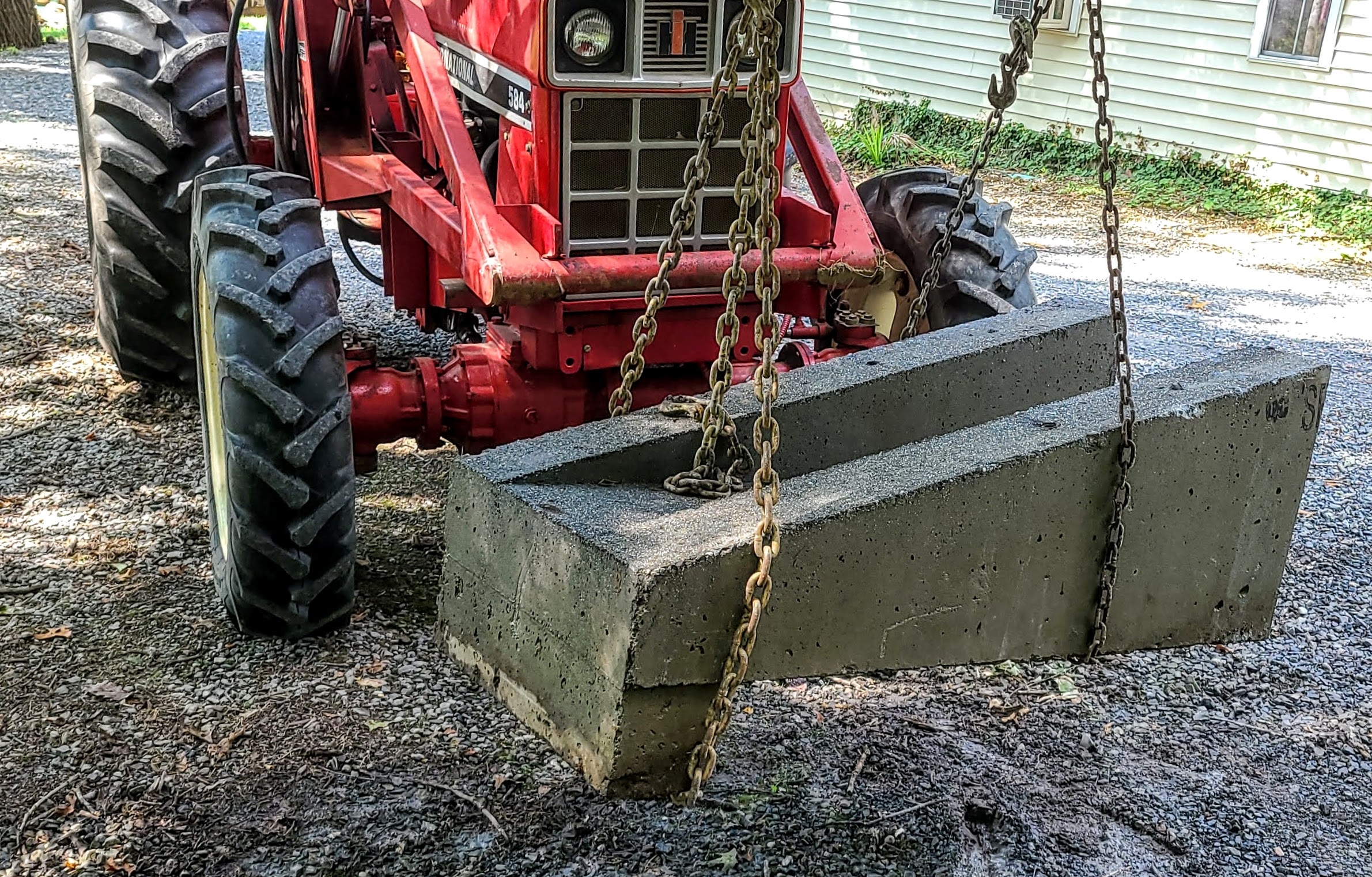

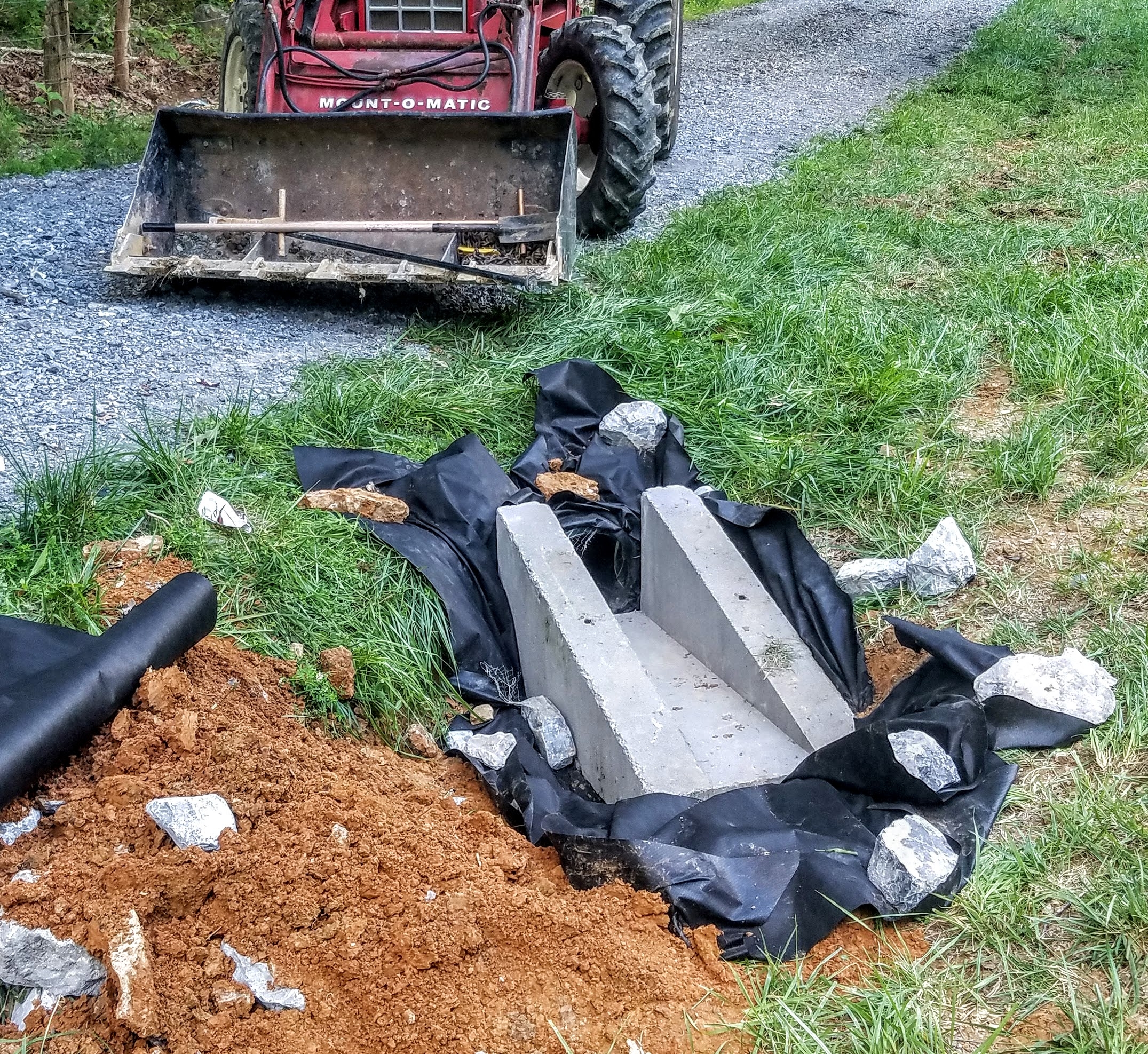

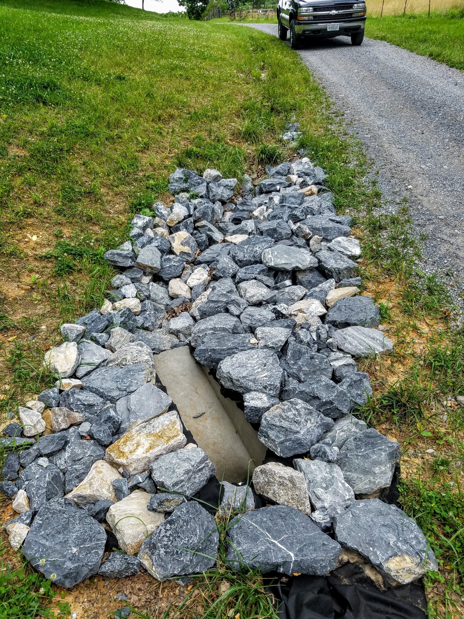

One day, I found these concrete pieces on Craigs List,, They weigh over 2,000 pound each.
I installed one at the entrance to each culvert.
I then surrounded it with LARGE Rip-Rap,, That was SERIOUS work to install the large stones.
BUT, now, maintenance is zero,,,,,,,,,,
