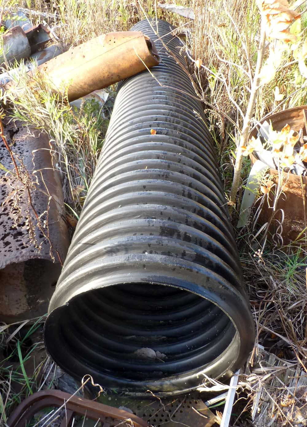

You can find culvert "cut-offs" for cheap since they are left over from jobs.. . Here is a 10" I just picked up for free. I'd never wast my time with steel barrels....

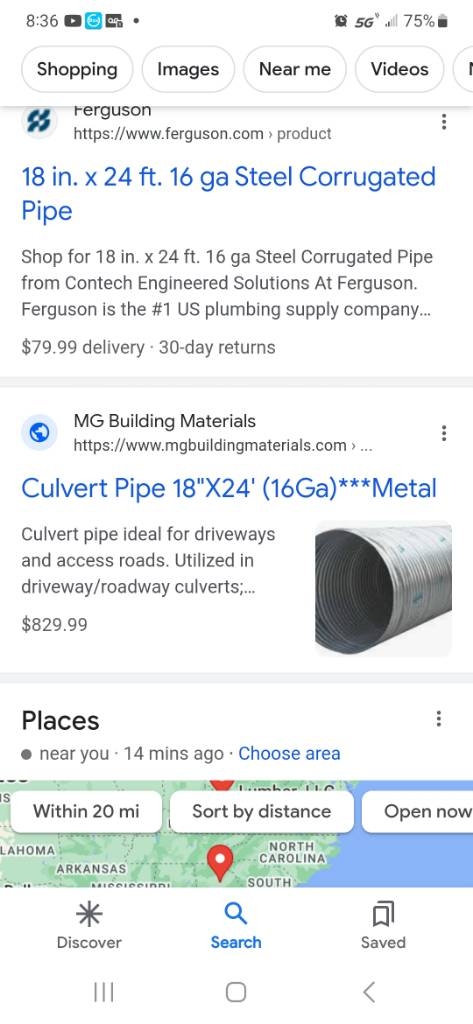

24 LF of 18" CMP, $830. I dont think the barrels would last, and it's a Lot more work, just go with a known product.
