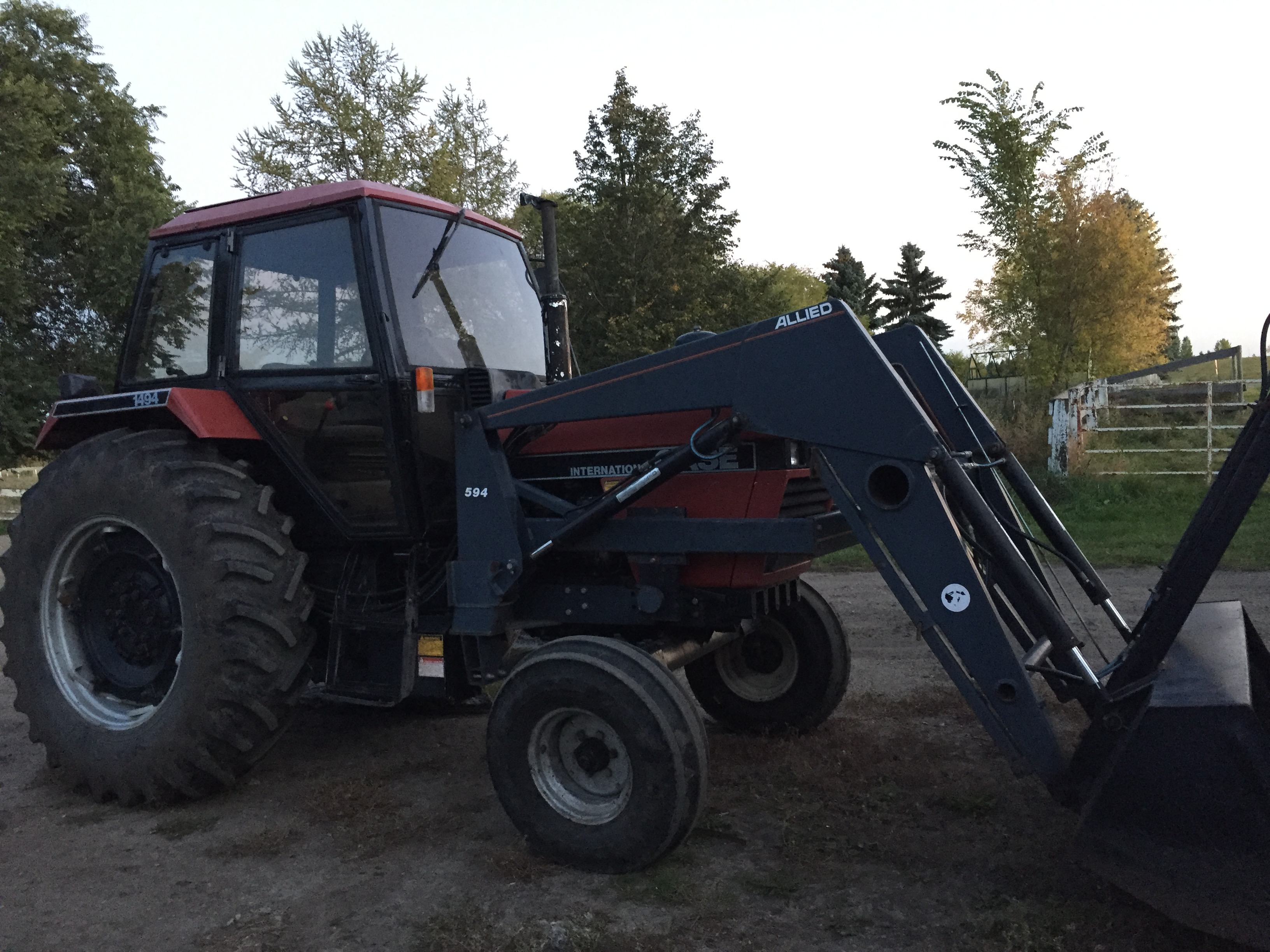

Just to throw a curve to this post, the tractor is 2 WD, currently the front tires are the steer type tires with the single rib down the middle. If I replace both, should I stay with the steer type tires or go with trailer type tires (more grip type). In snow I find that the steer type tires do not work very well for actually steering, but I think they would have a higher load capacity on them. I mainly use the tractor for moving round bales and it has a grapple on the front, so there is a ton of weight on the front end. Case 1494.jpg

Moving snow, whether using a 2 or 4WD tractor there is always a loss of steering as the bucket fills with snow. Chains front and rear will help give traction for steering. Also, lifting the loader so the bucket just skims the snow puts more weight back on the front wheels for added traction. Since yours is 2WD you have to rely more on independent rear brakes to assist steering.

I'd just get a couple old used pickup tires and put on it. They would be cheap and give you a little more grip on the front. You want the same sizes so the steering is not squirrelly and pulling to on side. Ag tractors and equipment generally do not go fast enough to wear out the tire. It is usually weather check and dry rot issues that get you. The other thing that will get you is if you run over something like say a hay hook.

Some simple facts for your consideration.
Looking at the tractor data info from a link posted earlier, your tractor's front axle load rating is 7,000#.
It is this high to be able to handle a front end loader which, if it is a strong one, can put large loads on the front axle lifting large bales etc.
Carlisle's Ag tire web site has this info for the 11L x 15 tires you indicate are on your machine.
Each 11L x 15 has a load rating of 2,090 # or, since you have two front tires they can carry 4,180#
So with even the best tires, you are not meeting the tractor's front axle load carrying capability.
Many will argue these facts are not realistic and there are arguments both ways. The tires are operating at very low speeds when carrying a load, etc.
I am not a farmer but have very good friends with large farms. I saw a front tire blow when my friend was loading a large round bale onto an upper level of a hay wagon.
It was scary to see the tractor, with a heavy load up high, suddenly have one corner drop as the tire blew.
In the end, you are the one spending the $ and also knowing exactly how you use your tractor.

I glanced at what you wrote ^, then finished my cofffee before going outside to chase the last of the daylight thinking "Stay with the highest weight capacity tire you can".
Came back in just now to find Dave from Williamston covered the issue very well, with relevant data. He raises an excellent point - it may not be just a tire quality issue, it may be that size/spec of tire is punching way outside of it's Weight Class......
It doesn't take much else to go wrong to have a tire blowing then launch a serious chain of events.......
I've stayed with steer tractor tires on my 2wd 3930. Added basic H pattern front chains, which did help. For your application, what I'd do is go with the highest weight capacity steer tire I could find/afford, then add fairly aggressive front chains for the Winter. My :2cents:.....
Rgds, D.

I am going to make some phone calls on Monday to my mobile tire guy...
I did a quick search and found that 265/85/15 tires are a very close match, there are trailer tires in that size that are rated up to 3000 lbs.
The price point is probably way higher for these than a new set of steering tires.

"E" rated tires are 10 ply and have a higher weight load capacity. A pair would get you above the 7K tractor front axle capacity.

The pressure undoubtedly increases with the E rating over the 11L x 15 tires he now inflates to 44 psi now, so what about the rim's ability to withstand the increased stress.
I have seen the bead area of a wheel rip off from being over pressured and thus over stressed.
The more I think about it I wonder if the same front axle is used on larger tractors and hence the 7,000 # weight rating which is really not reached on this model tractor.
The designers/manufacturers would not install a tire that could not withstand the loads it would see including front ballast and FEL + a safety factor.
My suggestion now is to research the tire that came on the tractor initially, not what it might have been changed to by a previous owner and stick with a tire with similar load rating which will be the least expensive and still safe.

I've been through this with ST tires. On the Tirerack site, they have a recommendation (still, last I looked) to inflate ST tires 10psi over Max Pressure for highway travel, but only if the rim is rated for the higher pressure.
Tractors don't go 70mph, but rim rating is still a consideration.

I ended up ordering 2 heavy implement Firestone 12 ply tires for $225 each. The Chinese 8 ply tires were $129 each. There were no real choices in a heavy E rated truck tire.
I think the $100 more per tire is worth the cash in the long run.

When all is done could you please let us all know what pressure you need to run the new tires at. I too think you have made a wise choice.
It might not be a bad idea to ask the owner of whatever tire business is doing the install, (unless you are doing it yourself) what he thinks your rims could stand being inflated to.
I have edited my post after doing a little web research on wheel/rim pressure ratings.
I understand the rims are usually stamped on the inside with this info. I have no idea when this rating became a legal requirement but it would be worth checking yours to see if any info is present.

New Tires installed. Little bit shorter than the originals.
Hoping these will work a bit better in the ice and snow.
