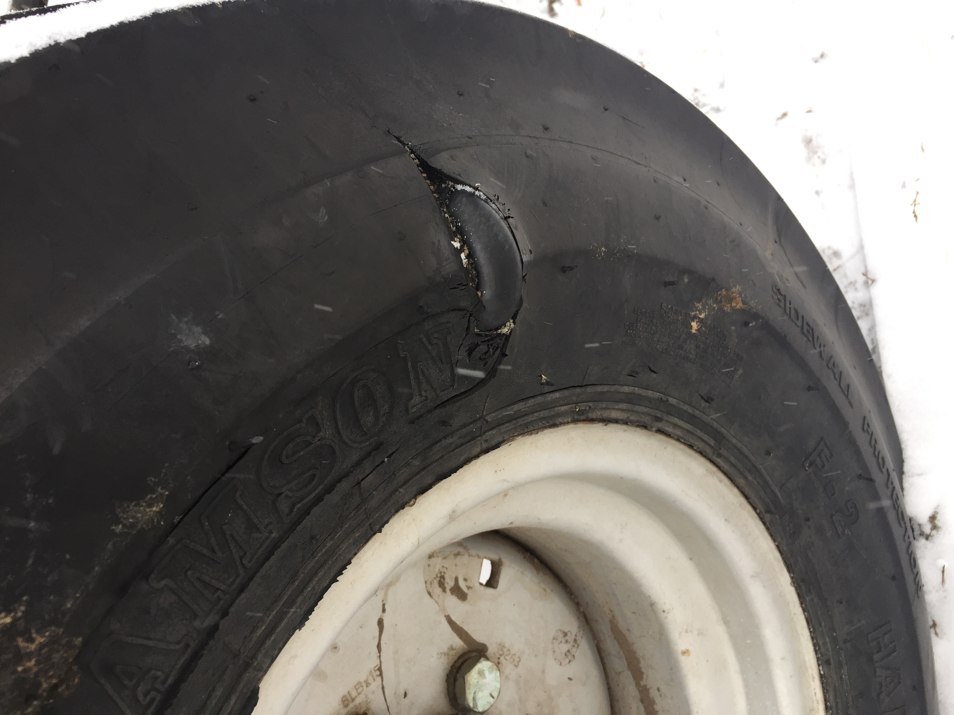

Dumb question, I am pretty sure the tire is no good, but is there anyway to repair this tire? That is the tube coming through. Its been -30 up here, this is my bale loader tractor and I think it split due to a combination of cold and weight.

Yes it can be repaired It will require a boot on the inside.
/ Cracking Tires #3
I tried the boot once on a tire not that bad. It did not hold up. Maybe you'll have better luck than I did. I wasted a whole day on getting it fixed. It went for several days, then failed again. I got another tire which was good. That fixed the problem. See if you can find a good used tire. it looks to be a support tire, and not a drive tire.
/ Cracking Tires
Thanks, yes this is a front steer tire, not a drive tire on a CASE IH 1494
/ Cracking Tires #6
I cut a 4" side wall gash on rear tire on back hoe. Tire shop put about a 12" boot in it . It has to be ground and a special vulcanizing adhesive. Cost about 75 bucks 3 yrs ago.

Yeah, I'd consider that tire done. The thing is, you can throw about any thing on tractors and farm machinery. Been known to take 7.50x16 tires off a 3/4 ton pickup and put them on hay wagons, steer tires on tractors and combine and so forth. We have what we call a coop around here and they sell and fix ag tires. Also so we have tire shops that sell and fix ag tires. If they don't have what you need, they can usually order it and hAve it in stock in a dah or two. I put brand new ag tread tires on the front of my 4 wheel drive massey ferguson last summer. They cost me about 100 dollars a piece. That includes mounting. Good luck with fixing/replacing your tire.

I've had exceptional good luck with Firestone tractor tires. Bought my first tractor - brand new in 1982. Traded it for current tractor in 2009 and tires were still in excellent shape - no cracking or weather checking anywhere and with 82% of tread still remaining - that's 27 years. Current tractor was purchased brand new in 2009 and, of course, tires look brand new.
Otherwise its JMHO that if you can keep the tires out of the sun, except when the tractor is in use, they stand a good chance of lasting a long time.
I looked at that pic the OP posted and wondered if that isn't a slice from running the equipment to close to something sharp or running over something sharp???

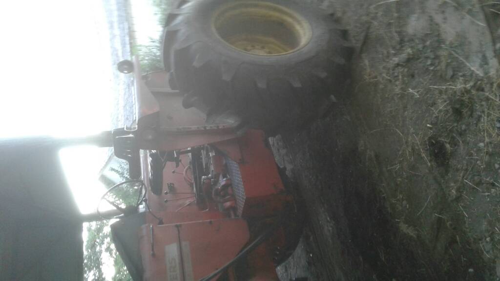

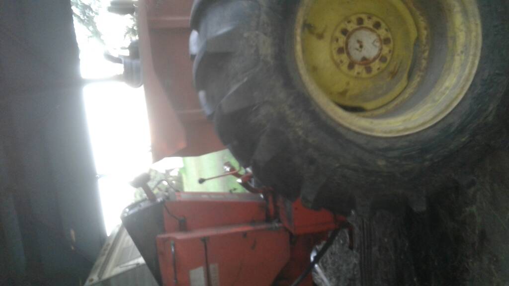

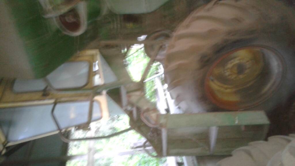

This just might beat all, don't know. I'm kind of a "tight wad". Needed some tires for the back of my allis Chalmers 185. They were pricey. Had some old John Deere 55 combine laying around for parts. It looked promising, the measurements looked good, could they??? Yes, you got it, John Deere 55 combine tires bolted right on to my allis Chalmers 185. I junked out 4 of those old combines and still got 2. I got all kinds of tires. Current set is probably 40 to 45 years old. Here's some pics.20170804_200545.jpg20170804_200526.jpg20170804_200449.jpg20170804_200430.jpg
Nope, not a slice, there are other smaller cracks running in the same direction.

Maybe it can be patched, but I've never had any luck patching a tire when the problem is on the sidewall. I gused it is worth a try.
