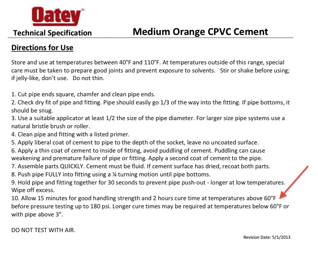

I worked with CPVC for a lot of years but don't ever recall how long to let the joint dry or set up before putting full water pressure to it. Is it just a guess? I heard 24 hours but most of the time that will never work. Any expert advise on that one??
/ cpvc plumbing #70
I usually find my expert advice on the can label. :)
But here is an example:

I think I usually wait 10-15 minutes, when I'm making repairs and additions. When I've plumbed my house and addition, it had months of curing time. I don't recall ever having a failure from the solvent weld. I'm pretty sure that the 15 minutes to 2 hours recommended has a huge safety factor - nothing wrong with that.

Now I am embarrassed!! I could have swore I checked the label over the years, but not lately, and never saw the times. Thanks for not rubbing my nose in it.
That 2 hour cure time is fairly new. It used to be 24 hours so don't feel bad.
/ cpvc plumbing #77
24 hours!!! no wonder you would want copper, who wants to wait a day after a cpvc repair to use the water. i am not sure anyone but new construction kept to that, just like i am sure very few wait two hours, at least people doing a quick repair to get back up and running. 15 mins is easy by the time you get out or put back what your doing 15-30 mins have passed.
